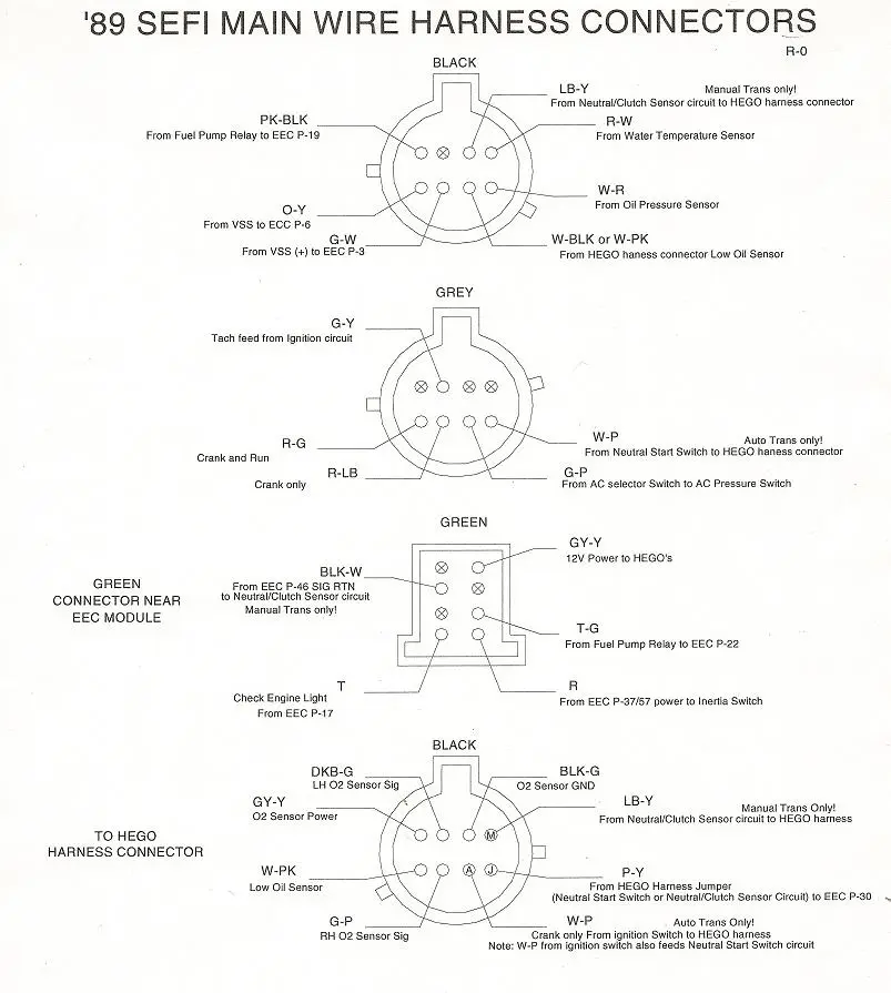

Loop wire is good and in the proper pin locations. What do you think about the B cam being to far advanced. 5 degrees ground into it along with the additional 4 degrees from timing set. 9 degrees total advanced. I've been looking at comp cam xe270hr 114 lobe seperation. It says its OBD 1 friendly. Any ideas?

You say you did the "Surging Idle Checklist” . Did you start at the top of the list and work your way all the way through it? Or did you just pick and choose what you wanted to test? Most of the problems not found by the checklist are due to skipping around and not doing ALL the steps.
I missed seeing any reference to dumping the codes? Did you dump the codes and get at least an 11? A perfectly functioning system will always get a code 11, it is the everything is OK code. The 11 code is computer passed its internal self test.
If you don't get an 11, you have computer or wiring problems.
Please check and repost.
