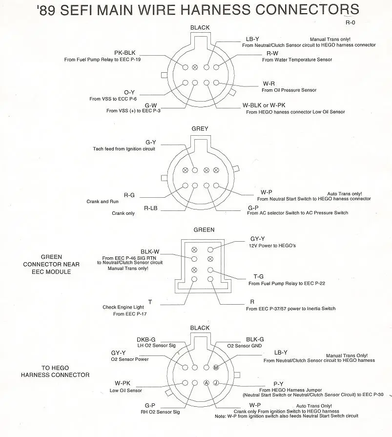

Sorry for the delay bud. What i mean by the loop is at the connector for the o2 harness. The connection is near the throttle body, close to the fender apron area. The o2 harness plug has 8 wires and is round. Peel back the tape about 6 inches or so, and look for a jumper wire. This is on the O2 sensor side of the harness, NOT on the car computer side of the harness. Its just a loop of wire that connects 2 pins together. The connector im talking about is at the bottom of this picture. You need to see where your jumper is, to make sure you have the right one for your setup. Yours might be fine, but why not check on it to make 100% sure, will take you less than 5mins. If you have the jumper in the wrong location, it can cause some issues. If you look at the picture, you will see an , A, M, J. This means, Auto, manual, and jumper. If you have an A9P harness and computer, then you want the jumper to go to the A pin, and the M pin is left open. And if you have a A9L harness and computer, you want the jumper to go to the M pin and A is left open. Hopefully you understand what i mean. Forgot to say, the jumper is usually purple/yellow, and is about 5" long. Goodluck
