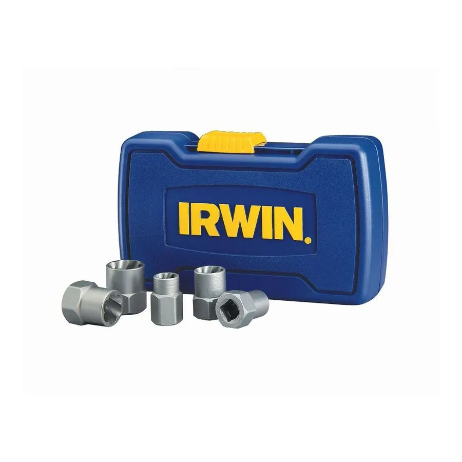

Call the O"Reillies and see if they have a bolt extractor socket in the size you need, and one smaller.
Someone may also have a kit:
