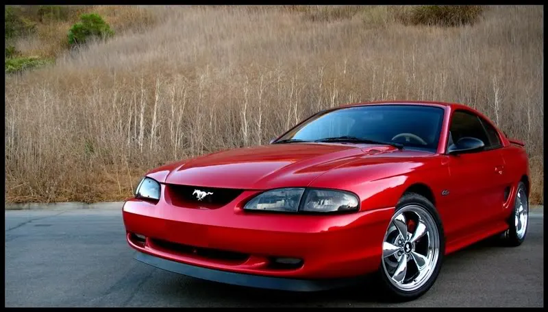

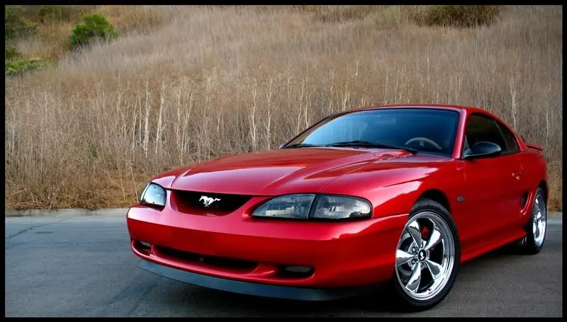

2004 GT
- Vortech T-Trim Supercharger (Upgraded from SQ-Trim)
- Vortech Mini Race
- MPH Boost Pipe
- 2.75 Pulley
- Paxton A/A Intercooler
- GI Joe 8 Rib Pulley Kit
- VT Sportsman Shortblock (Good for 750rwhp)
- VT Stage 2 Blower Cams
- Comp Valve Springs
- 180* T-Stat
- SCT BMAF 2800
- Aeromotive A1000 Fuel System
- Cobra Tank
- 60lb Injectors
- Fully Built 4R70W Transmission
- 3200 PI Stall
- FRPP 4.10 Gears
- Fulley Built Rearend w/ 33 Spline Axles
- Magnaflow Catback
- Magnaflow O/R X (modified)
- JBA Midlength Headers
Car ran [email protected]
Part's are in my sig. Ran [email protected] with 2.00 60 foot before heads/cams/intake/tune ect. Auto it build to a stage II transgo spec and J-Mod spec accumulator piston and valvebody. Hardened shafts. 3200 stall spec-rite torque converter, B&M cooler. Built for 550rwhp daily use.

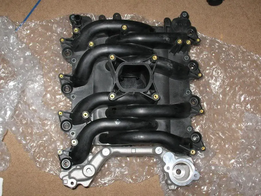

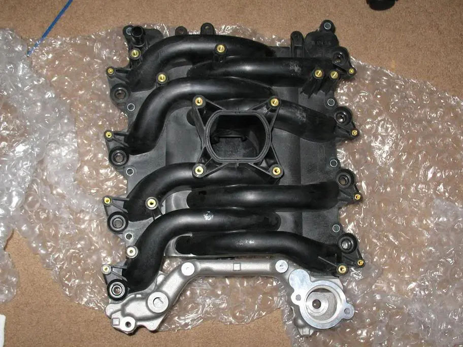

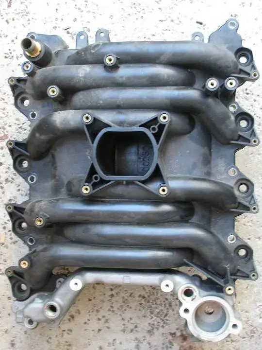

Sweet.. Yea I know all about the NPI and P.I. stuff.. I have 00 GT heads cam and intake ready to bolt on.. The only thing is the car is a 98 and was told that the motor was replaced at ford, so I am trying to find out if it is a P.I. motor already or not..
It's not, they would replace it with another NPI engine. You can look at the intake manifold as well - the difference bwteen PI and NPI is what side the front intake runner comes from.

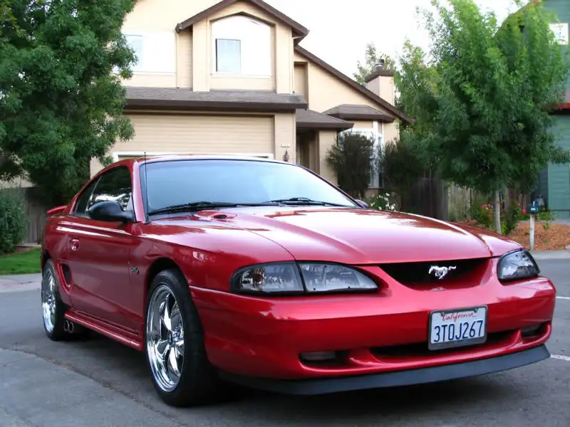

CobraRed_96_GT, Where did you find your chin spoiler? This is what I am looking for 'cause it looks so nasty.
BTW the car looks amazing :hail2:
