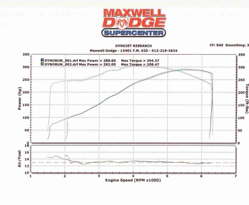

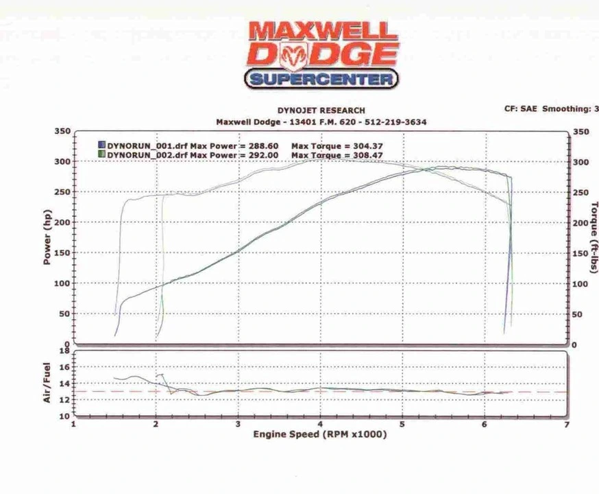

hotmustang try to post up a clear graph if you can. i think the one i was looking at that you posted was real blurry or small i cant remember. i know that you were higher then me through the power band, thats why i always said that you had the edge in the hp department. ill try to post a clear one too so we can compare.
i had a ton of pulls last time as they had a problem tuning. i cant find my very best numbers but this one is very close.
scanning it in my computer the tq side got cut off but the numbers were in the same spots so 300 hp=300 tq. sorry!
[/IMG]
so i went over them again, did you? what did you find?
it seems to me not to be as bad as i thought. when i saw your first graph a long time ago i couldnt read it too good.
so heres what i can make out: you have the advantage at the lower 3000 rpm by about 5 hp and 9 tq. then 3500-4000 looks you have just a couple over me. 4500-5000 it seems i actually have couple hp more then you(am i reading that right?)
then the upper 5500-6000 you get the +5 hp over me again and some tq.
expected from my cams, actually i expected worse. anyway we are both making good power:nice:
whats are you going to do to put you over 300 next, intake?
Yea, thats what it looked like to me also lol. It seems I only got you a HAIR from 3-4K...and then a final little 2HP bump at the very end. I say the engines are dead even :shrug:. My run was in 6X * weather too, so that may have gave the 2HP gain.
