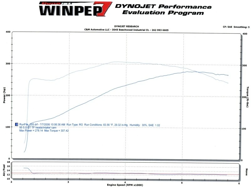

Ok, so my current setup is in my signature, and I'll be adding 373's this winter. I currently run the tfs stage 1 cam and netted 278/308 at the wheels.
Now, if I went to ed curtis and had him cut a new cam, what kinds of gains could I see, would it be worth it?

sorry, here's a copy of the dyno sheet from my dyno back in july.
It was an actual tune in the PCM, and the car still has idle issues on the start...
ok, so i'm still running a t-5, 12* timing at the dist, 38 psi fuel pres line off, the tune was done by a prof, it seems as though its a REALLY conservative tune, which is ok, but i'm just wondering where I can squeeze out more power, i was running flows and they rusted out so my new exhaust is magnapacks, and i'm also still stock on the tb
Good to know about the t5 :)
Did he make several pulls :shrug:
If so ... did the numbers grow as he changed the tune :shrug:
Was the dizzy at 12 when he did his thing :shrug:
With your mods, you are now moving a good bit of additional airflow.
A larger tb would give you a gain for sure :nice:
Grady
