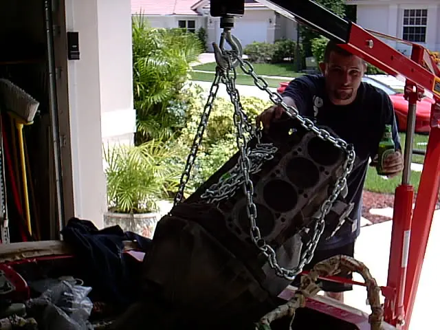

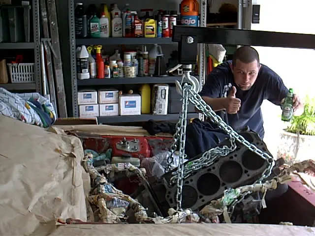

its a running joke about joe and i. every other pic we take while working on the car has a heineken in it somewhere. its kinda like an adult version of "where's waldo?"

Green at work.
