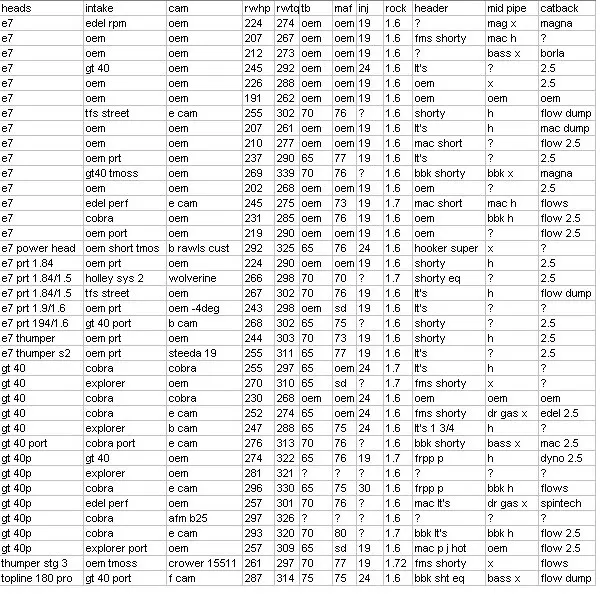

I got data about OEM combos showing what they did at the dyno
It was up here forever but my host site went belly up
I'll try to get it hosted a bit later this afternoon after I find the file
You can see what others have been able to accomplish that have built
combos simular to what you speak about here
Grady

Some stuff I found from various places
I have no way to know the type of calibration these were done with
It is most likely a mix of STD and SAE
Same kind of thing for type of dyno
Could be a mix of Dynojet and Mustang
Never the less ... You can get a ball park idea
Grady

Thanks very much for posting that. It is very helpful. It looks like the GT cam may be better in combination with the GT40s and Explorer intake than the Cobra cam.
