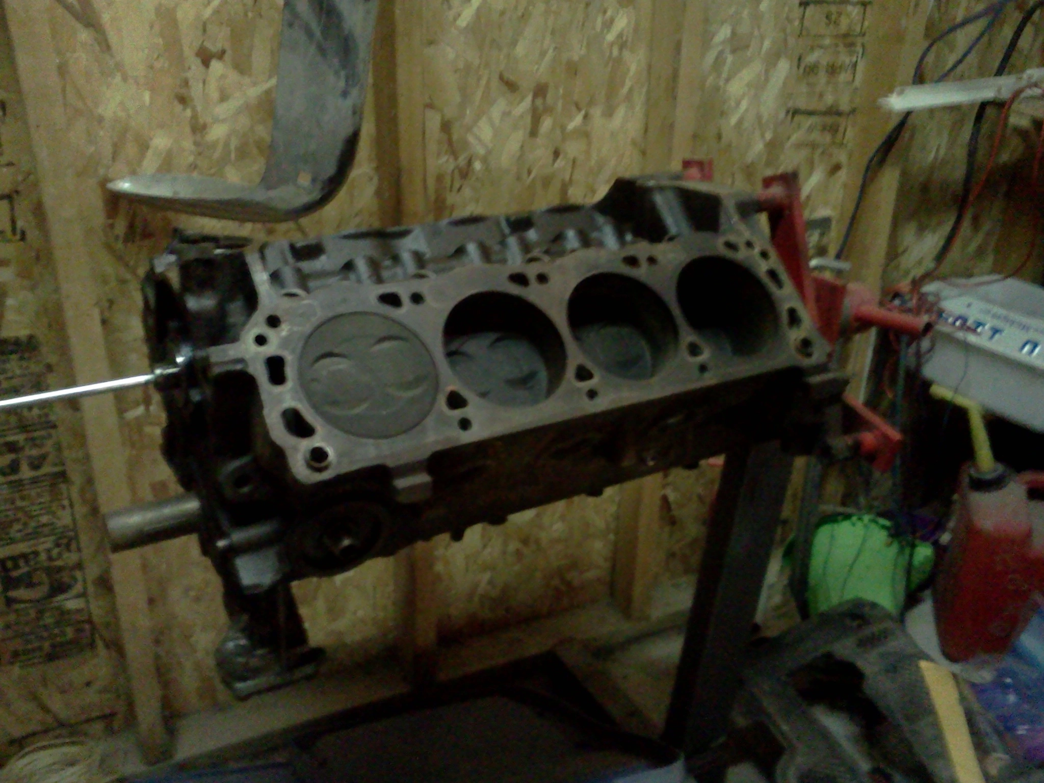

Alright, I bought an engine from an '88 mustang. Complete stock bottom end and GT40 heads (3 bar and 1.54" exhaust valves, 65cc chambers). The motor received an alphabet cam (e) with the heads. The motor is going into a classic mustang with a 5 speed swap...
1) is worth a cam swap with the technological advances in past 20 years?
2) I called comp cams and they couldn't tell me what I would have to do (ie machinine work to heads) in order to run a thumper cam. They told me not to run extreme energy and said that I should run a 35-440-8 cam...but again couldn't tell me if it had too much lift for GT40 heads...anyone running this cam? What had to be done?
Anyways, I don't want to have to take the heads off to have them machined because I might as well get AFR 165'S if I go down that rabbit hole.

E cam will be ok I think, take a peek inside the spark plug hole a make sure the pistons have the eyebrows, I don't know about the thumper cam lift specs, I know they are not efi friendly, too much overlap, that might be why the rep popo't it thinking you are efi.

pistons look identical to the ones in this motor, has valve reliefs and what looks like a recessed looking area in middle...
Thumper cams come with 3 variations in lift here are specs (cams listed most radical to least)
.552/.537 243°/257° @ .050 rpm 2500-6200
.540/.526 235°/249° @ .050 rpm 2200-5900
.531/.515 227°/241° @ .050 rpm 1900-5600
How much lift is too much for GT40 heads, I hear the "P" heads can't take that much without machine work.
