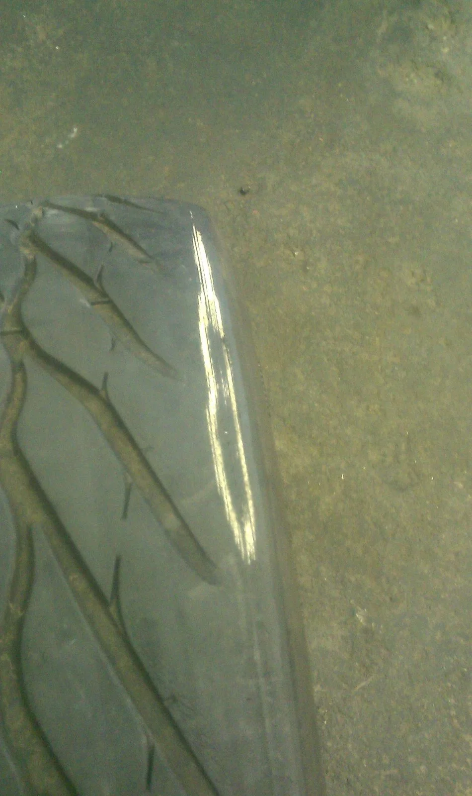

My last mustang, 2000 GT on eibach PRO kit springs without caster camber plates...
Thats how my tires looked in the front.
Draw your own conclusions.
Your picture does show how improper alignment can wear tires, but this is Stangnet's S197 Forum (2005-2013 Mustangs). Your 2000 GT's suspension is nothing like an S197's suspension. It just doesn't work out that way on 2005+ Mustangs.
