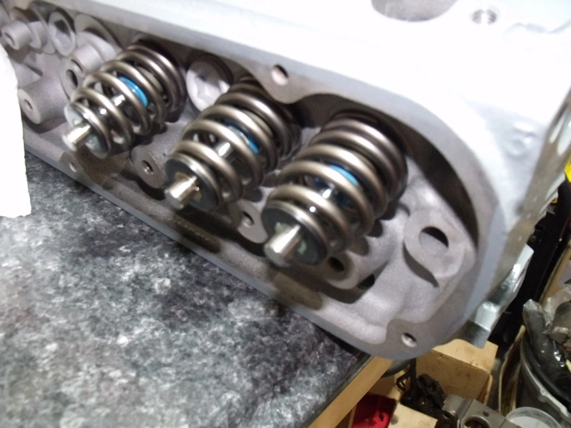

I used Alex beehive springs on my "P" heads
Reactions: mikestang63
