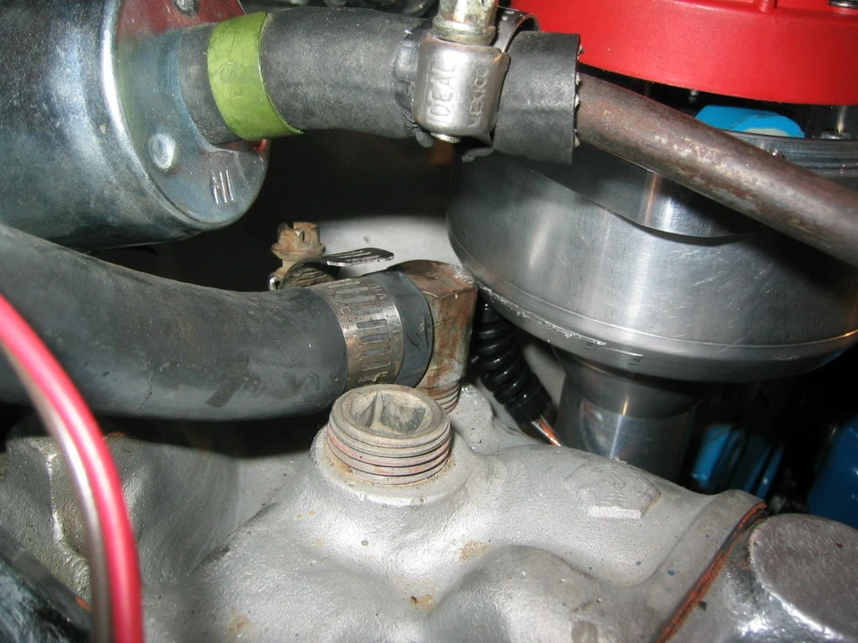

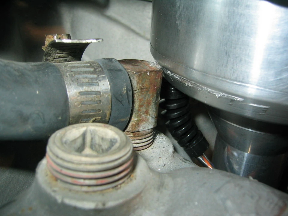

I am installing a new MSD distributor, but the new distributor is hitting the fitting that connects a heater hose to the manifold, and not allowing it to seat all of the way down in the hole. Can I plug that hole and use the adjacent hole in the manifold for the heater hose? Not knowing enough about the what the inside of the manifold looks like, I need help!

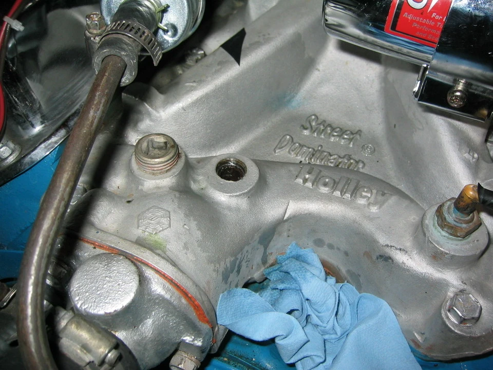

ok your other pics showed up now and it looks like you can swap where that plug is farther away and higher up and where your host fitting is right now.

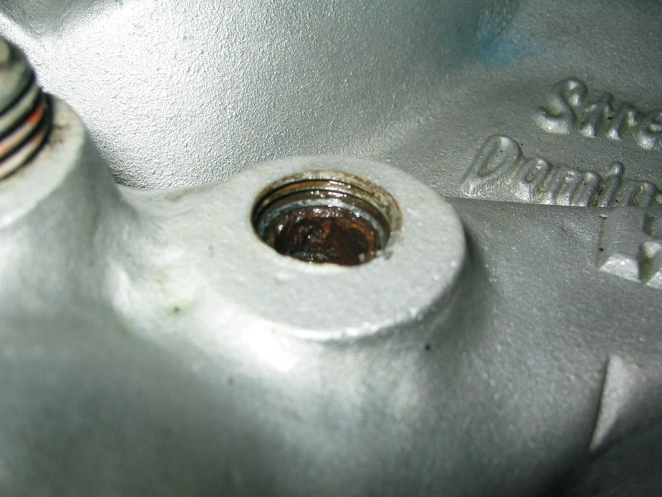

Hard to tell from your photo, but I'll bet the plugged hole in your photo is smaller than the one the fitting is in now. I'm also pretty sure that heater fitting has a long tube extending out the bottom, it may be too long to fit in the unused hole.
That all said, I might take a shot at filing a notch in the fitting to give the extra needed clearance.
