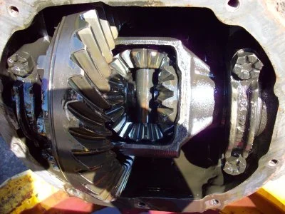

B buckshot1020 New Member Mar 21, 2006 3 0 0 Mar 9, 2008 #1 Mar 9, 2008 #1 I just picked up an 8.8 from a Mustang- I do not recognize the diff. inside. Can't see any markings in view. Can anyone ID it by this photo ?
dcurtis 10 Year Member Jan 19, 2006 688 7 39 Mar 9, 2008 #2 Mar 9, 2008 #2 It just looks like a stock open diff Get rid of it and throw a limited slip back in there.
Mustang5L5 That is…until I whipped out my Bissell Mod Dude Feb 18, 2001 43,320 18,047 224 Massachusetts Mar 9, 2008 #3 Mar 9, 2008 #3 That looks like a 7.5" open rear to me. 8.8 bolt patter 7.5 bolt pattern
Roland69 Sergeant Tangnet Sep 17, 2005 2,867 3 58 Port Elgin, Ontario Mar 9, 2008 #4 Mar 9, 2008 #4 7.5 open
mustangfan1990 New Member Jul 17, 2005 505 1 0 Lenoir, North Carolina Mar 13, 2008 #5 Mar 13, 2008 #5 that is a 7.5 throw it away
