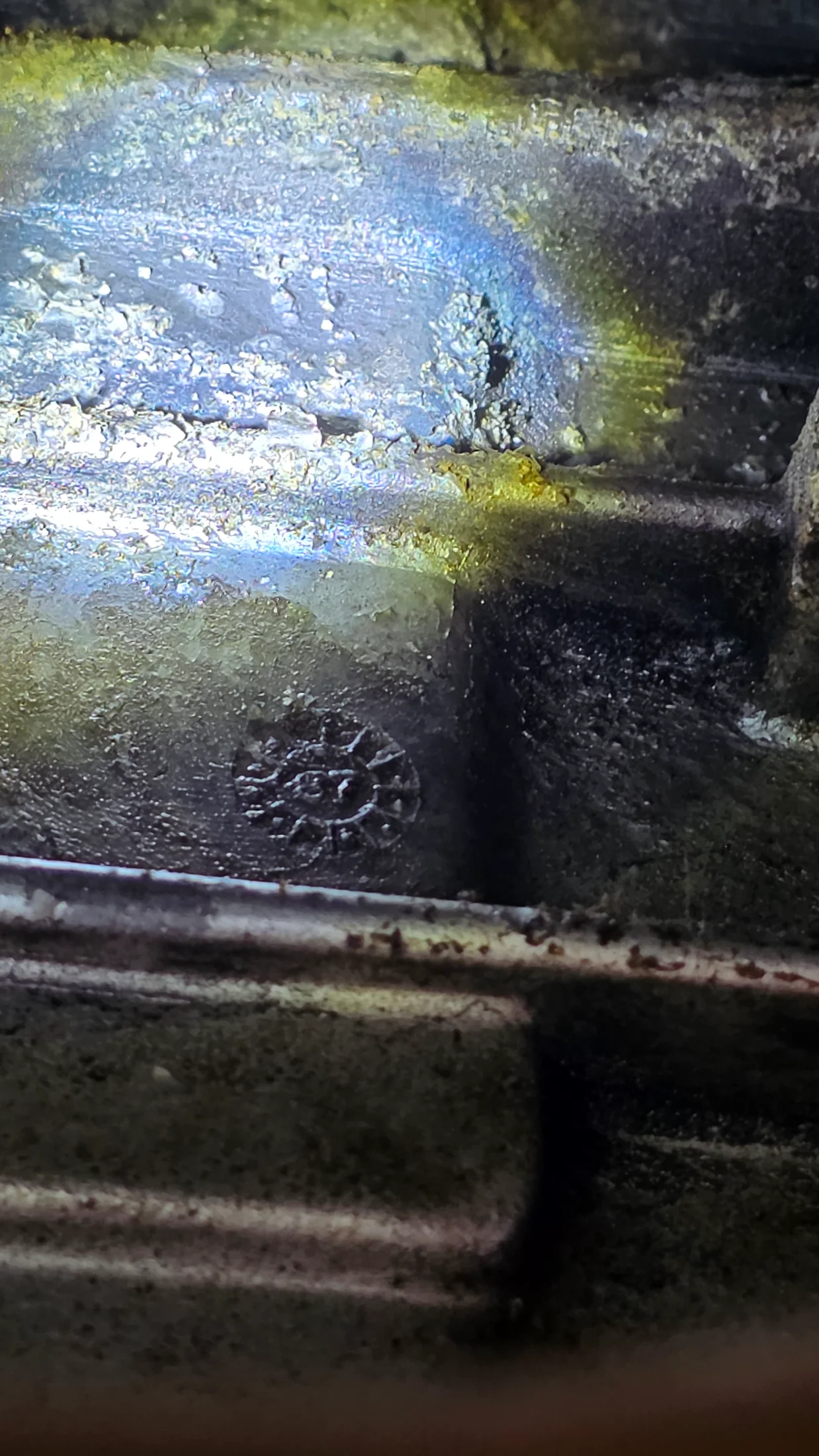

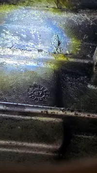

There is a date code cast into the side case of the T5. While I realize at this point many T5s have been rebuilt a few times, so it’s not definitive, it’s one way to at least try to narrow down what year the T5 is front.
The date code will be a circle with a 2-digit number in it.

Found a date, looks like 87 to me so assuming it should be a world class T5.

Yes. Likely an 87-89 spec T5 rated for 265 ft-lbs.
Of course, not guaranteed. Would need to open to confirm the gearset. Wasn’t uncommon to put the 90+ guts in these during a rebuild back when the gearsets were pretty cheap.
Might be a while before I can get it out to look. It definitely has something wrong with grinding going into reverse so rebuild will be in the future

Regardless. Moot point. All we can do is speculate at this point. Would need to drop trans and really inspect certain things to narrow it down.
All we definitively know at this point was the case was cast in 1987. That’s all
