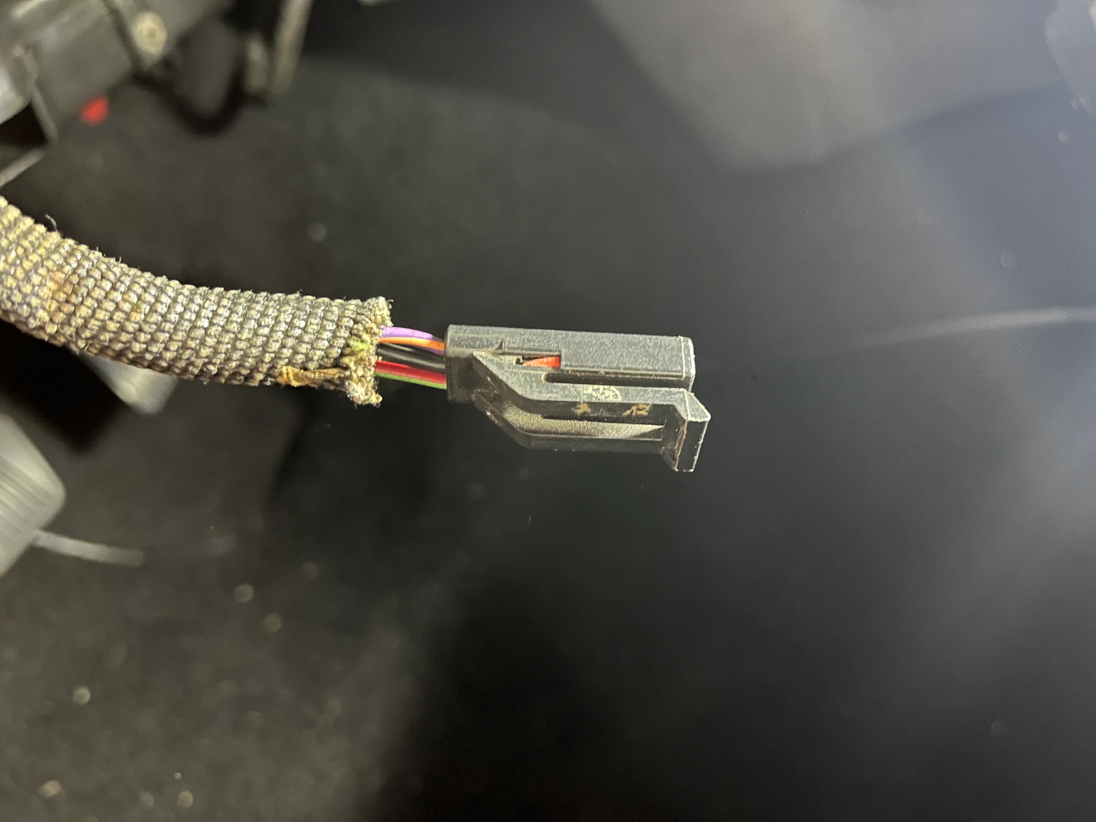

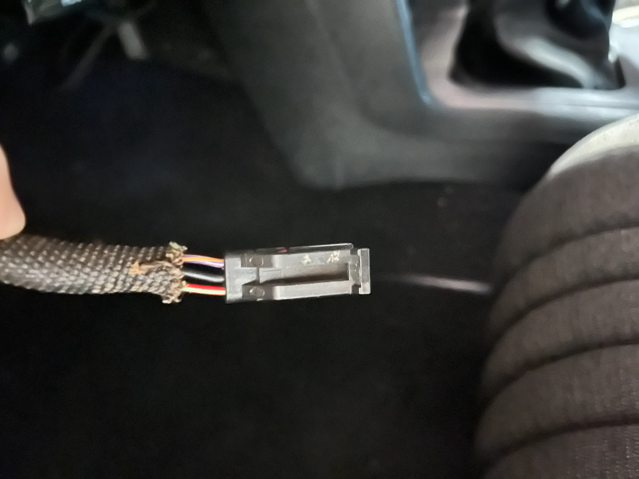

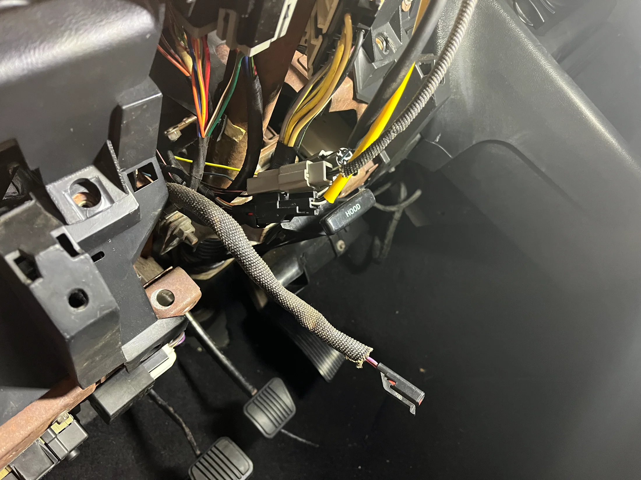

9 93.5.0GT New Member Nov 1, 2025 1 0 0 TN Nov 1, 2025 #1 Nov 1, 2025 #1 Does anyone know what this plug goes to under the dash of a 93 GT manual? It is in the steering column area under the dash. Thanks in advance. Attachments Plug1.webp 195.7 KB · Views: 125 Plug2.webp 269.7 KB · Views: 98 Plug4.webp 334.2 KB · Views: 114
Noobz347 Stangnet Facilities Maint Tech... Er... Janitor Admin Dude Jan 4, 1985 43,563 21,730 234 Box behind Walmart Nov 1, 2025 #2 Nov 1, 2025 #2 I think that it is this one: Cruise-control or clutch-pedal position connector (if closer to the pedal bracket) R/LG again = ignition-switched power BK = ground or return through the clutch switch VT/Y = signal to PCM or speed-control servo These are usually black or gray connectors, tucked above the pedal pivot.
nickyb I gotta say i never painted my nuts, Never Ever 15 Year Member Apr 3, 2009 3,059 1,675 163 nevada Nov 1, 2025 #3 Nov 1, 2025 #3 That there is a duehickey that plugs into the whatcha macallit.
Mustang5L5 That is…until I whipped out my Bissell Mod Dude Feb 18, 2001 43,372 18,120 224 Massachusetts Nov 1, 2025 #4 Nov 1, 2025 #4 AOD shiftlock solenoid cable. Allows you to shift out of park only if you put your foot on the brake. This wire only came on 91-93, and on the 5-sod cars it just dangles unused. Should have 3 wires in it. Reactions: 91AOD5.0LX
