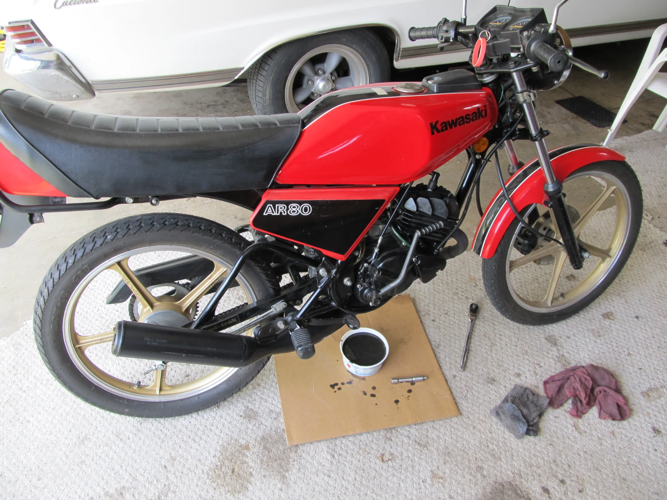

Another fun day in the shed. Took the moped out for a run. Been using it for living room art for the last 8yrs. and got it out a couple months ago. Clutch plates were stuck so bad I had to run it down the hill and hit 2nd gear to pop them loose. Stuck again this morning. Now has 1051 miles, so 44 years on it's time for the break-in service. Swapped the OE fish oil for some Rotella 15/40. It was nasty, and the sealing washer wasn't sealing, so got a new one. A few sparkles in the pan, but not more than I expected. ran it around the block, and do it again tomorrow to see if the plates stick again.

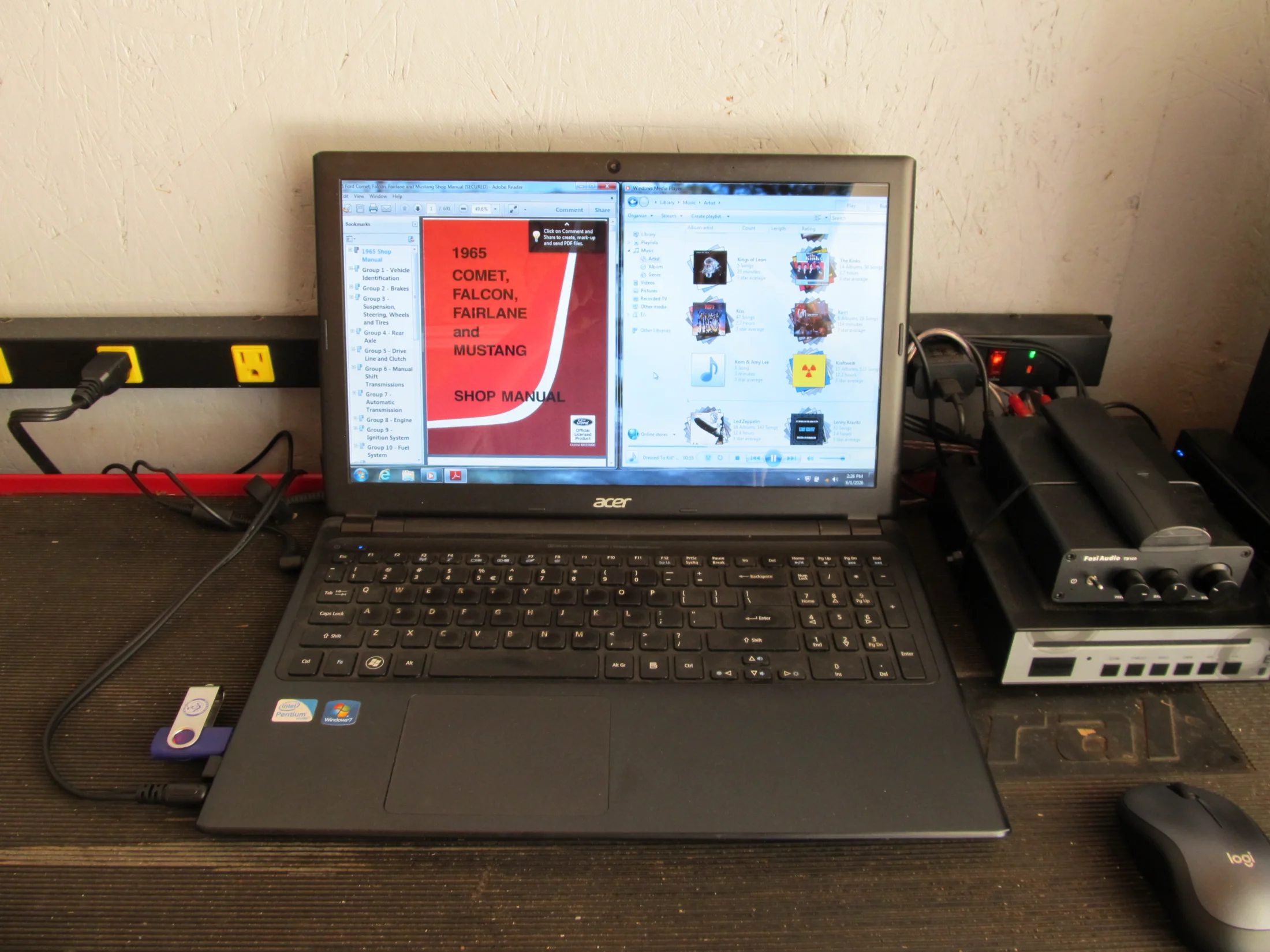

Hard to pick a band for such a mundane job. Been thinking about that, and last week came up with a fix. Had an old windows 7 laptop gathering dust because a bunch of bad sectors in the hard drive retired it. Gave it the full nuke reset to see what would happen. Loaded up all my.mp3's, and all my digital service manuals. Fortune smiled upon me. It plays tunes, and the Adobe reader still works. This is all it's good for as it won't talk to the interweb. Put it on random and the first song was by King Crimson. Score!

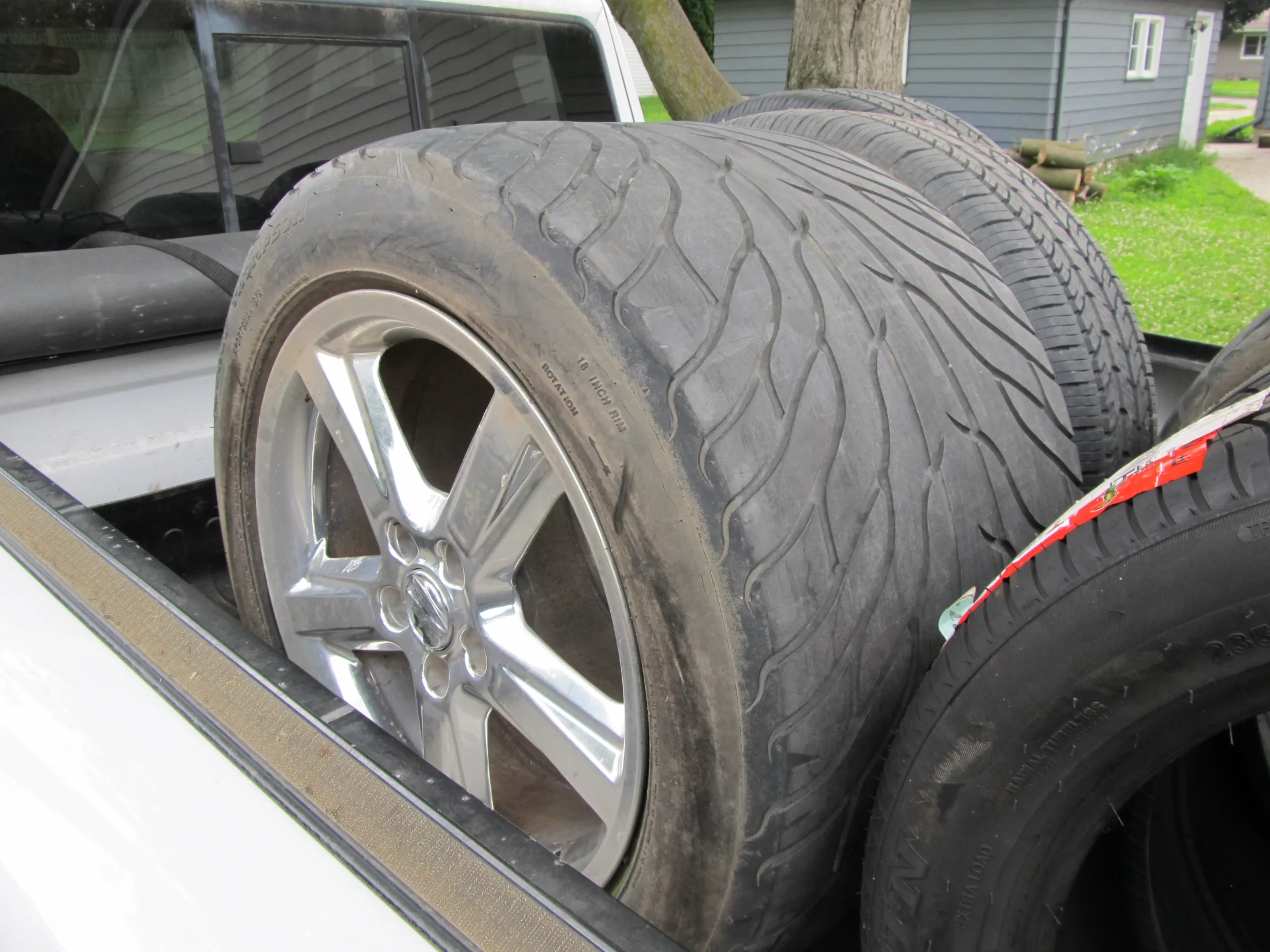

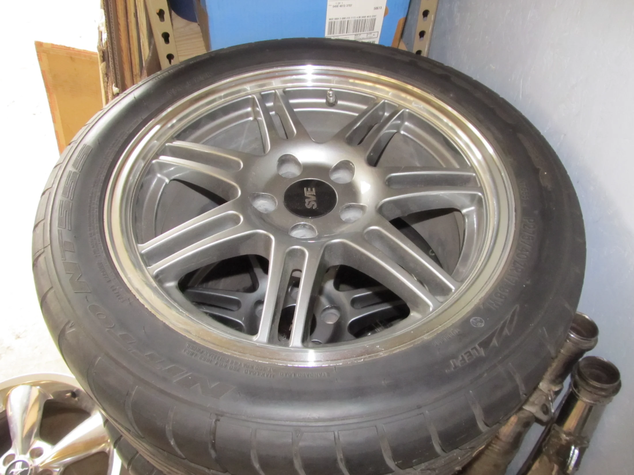

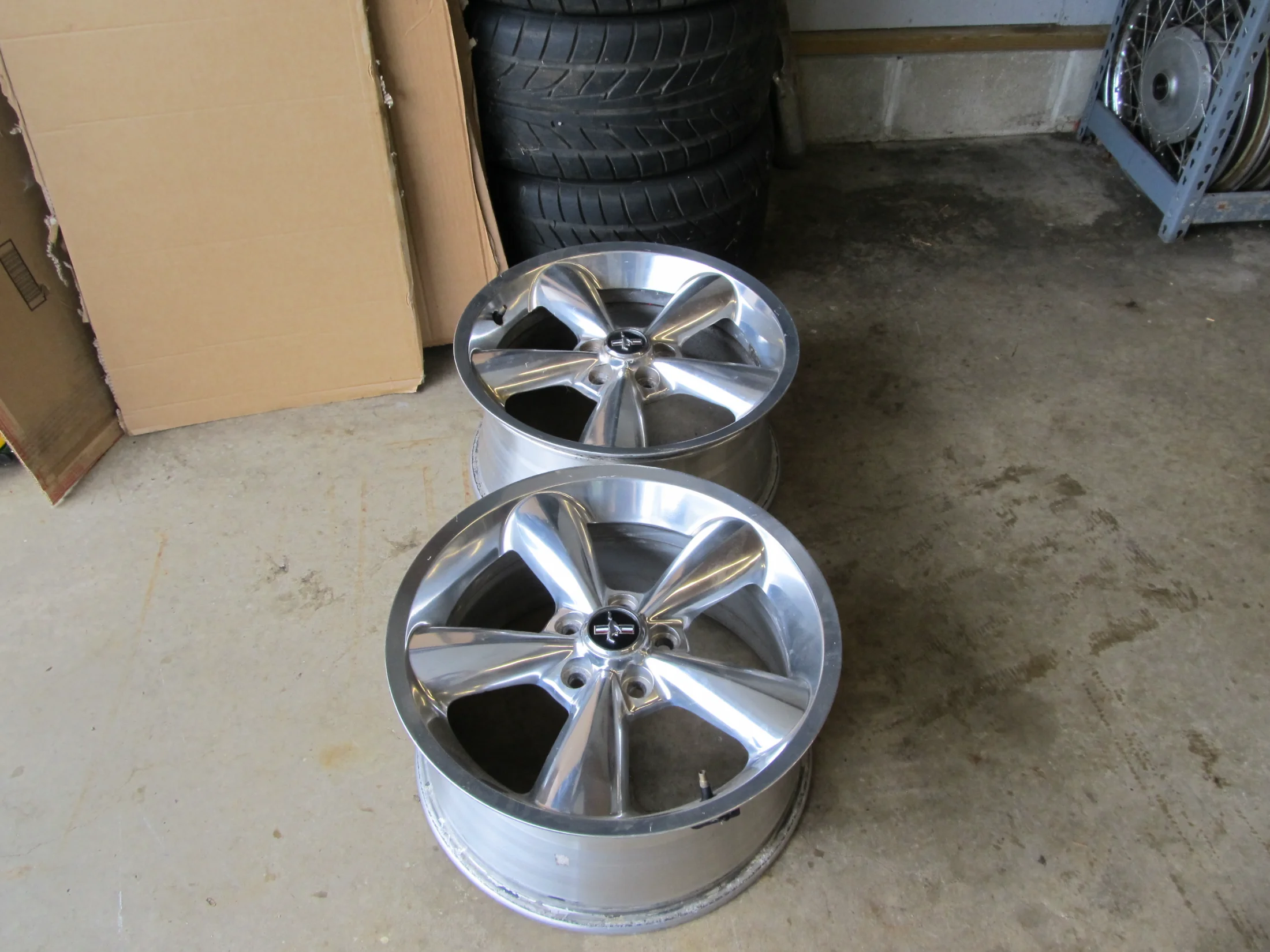

I'm getting to the end of cleaning out my late bro's shed, and started on the wheel/tire rack this morning. I need some help ID'ing this stuff. The set of SVE wheels have 275/40/18 tires on them. Would these fit the 90 7Up? Look too wide. They look mint, but the 09 GT is already sitting on an identical set of SVE wheels. If they won't fit the 90, not sure what he ran them on except the street Marauder. The rim on the floor looks like a stock wheel measuring best guess 19 by 9 wide. Would they be the stockers off the 09? The large units in the truck is the first set he ran when he back halved the race Marauder. Sent a couple stock wheels off to be widened. Probably boat anchors now, lol! Also found the mod motor blower intake manifold. Put one of those in the Comet? Hell no, lol! Wish I could weld like the person who built it. Beautiful work.

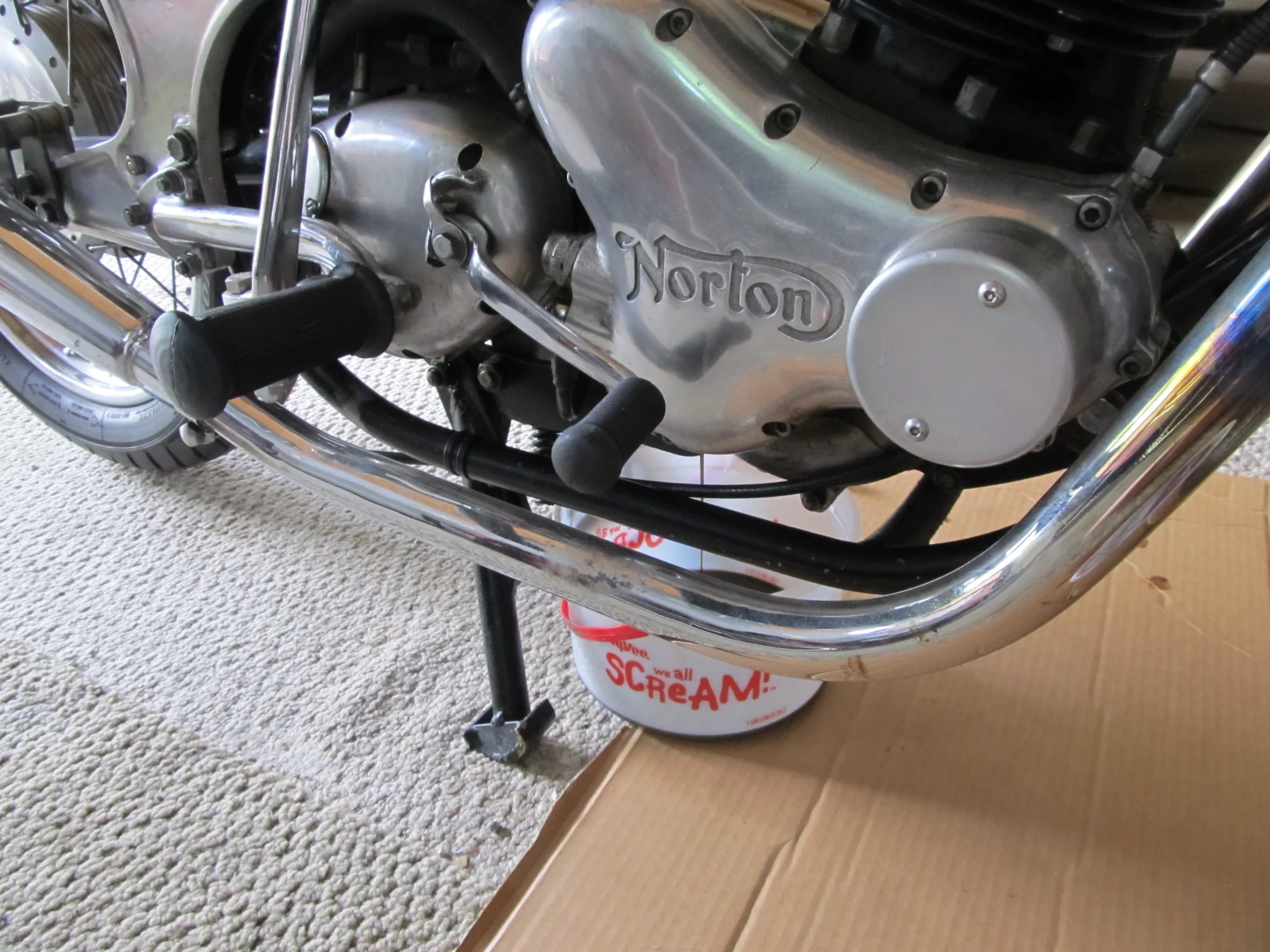

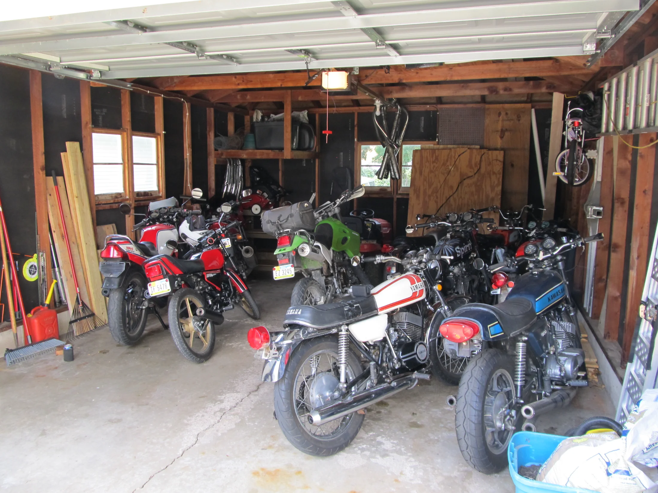

As far as my stuff, I had another trip around the sun a few days ago and was going to celebrate by riding a few I don't get out much but got sidetracked. The pre-ride ritual with the Norton is draining the sump. If it sits longer than a month it wet sumps too much to start without blowing the seals. I need to get to that ride soon as the shed cleaning is getting depressing.

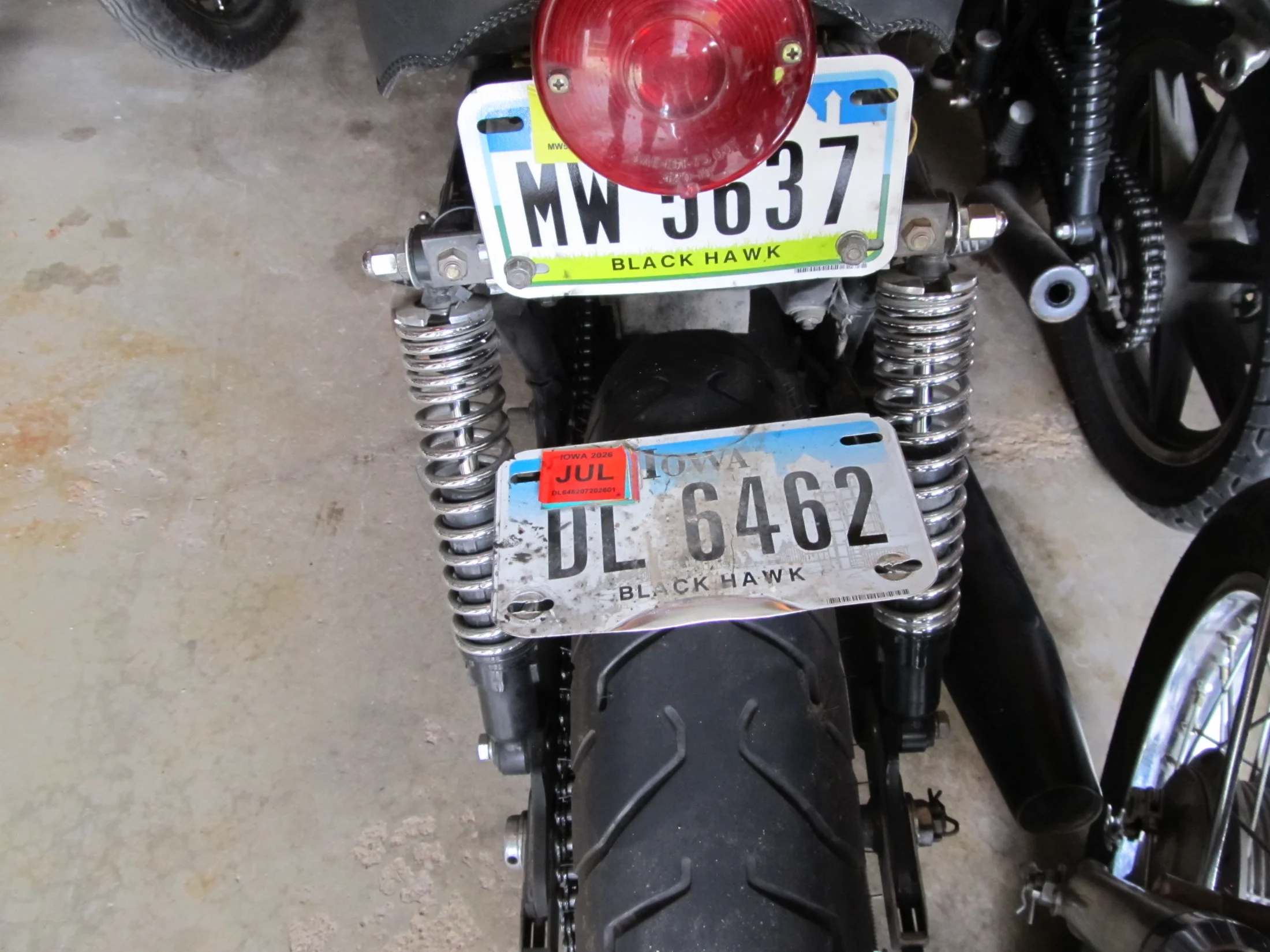

New plate for the rat XS this year. Notice the paint scraped, caved in old one. Going to miss that, lol! Damn DOT leveled out the RR jump. I can't hit it hard enough to bottom out the back end anymore. Another sign of changing times, like picking up the land line and hearing one of your neighbors talking. Getting old I guess.

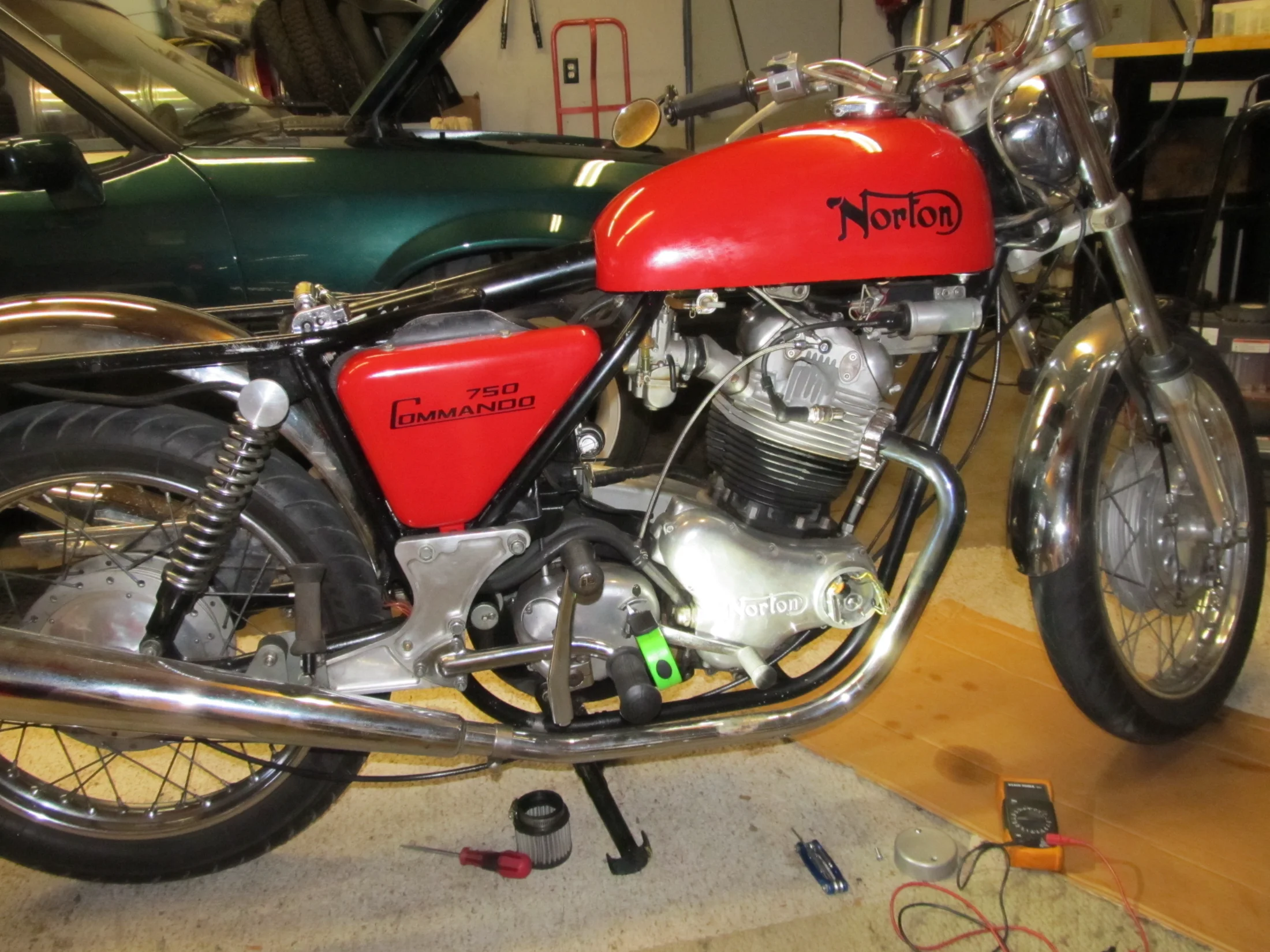

This morning in the shed, it's my least favourite work. Electrics. Nothing hard, electrics, I just don't care for it.

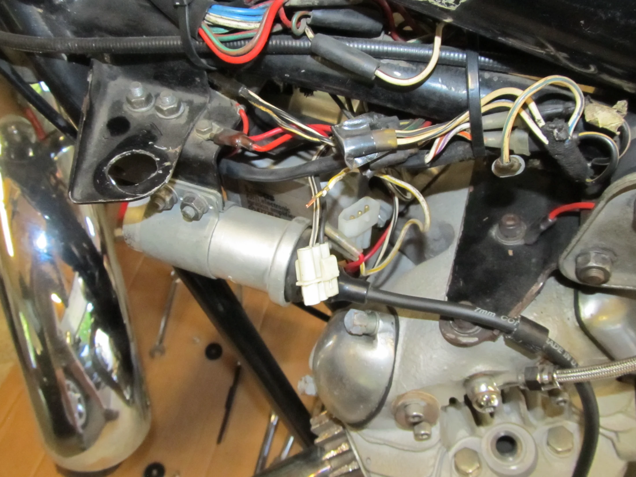

Got that ride I was jonesing for on the Norton. First ride went well, but it did fart a couple times at highway speed on a steady throttle. In the biz they call that foreshadowing, lol! The next ride (yesterday), I got almost out of town and it starts cutting out bad. Tried to limp it home but didn't make it. Could have been worse. It was only a 24 block walk home. Hot as hell though. That's why I was in the shed at 4:30 this morning. Started on it yesterday afternoon but after an hour of sweating a beer and A/C seemed a better plan. No sparks. The coils ohmed out OK, and the pick-up coil isn't shorted. I'm sitting here posting because temporarily stuck. It has the upgrade Lucas RITA ign. That hasn't been made for over 40 years, and my Chilton only covers the points ign. I need to do some web crawling to hopefully find a schematic and specs. If I don't find a voltage to the brainbox problem, I can see a new Pazon ign. in it's future.

Update. Guessed right. When going to disconnect the brainbox plug, the power lead wire fell right out. Of course, my Jap pin connecters dia. was too big, so wired it outside the connecter. No biggie, saved me $$$. It's always been a magical mystery tour with this bike on so many levels, but I love it. That under square long stroke motor pulls like a nuclear freight train.

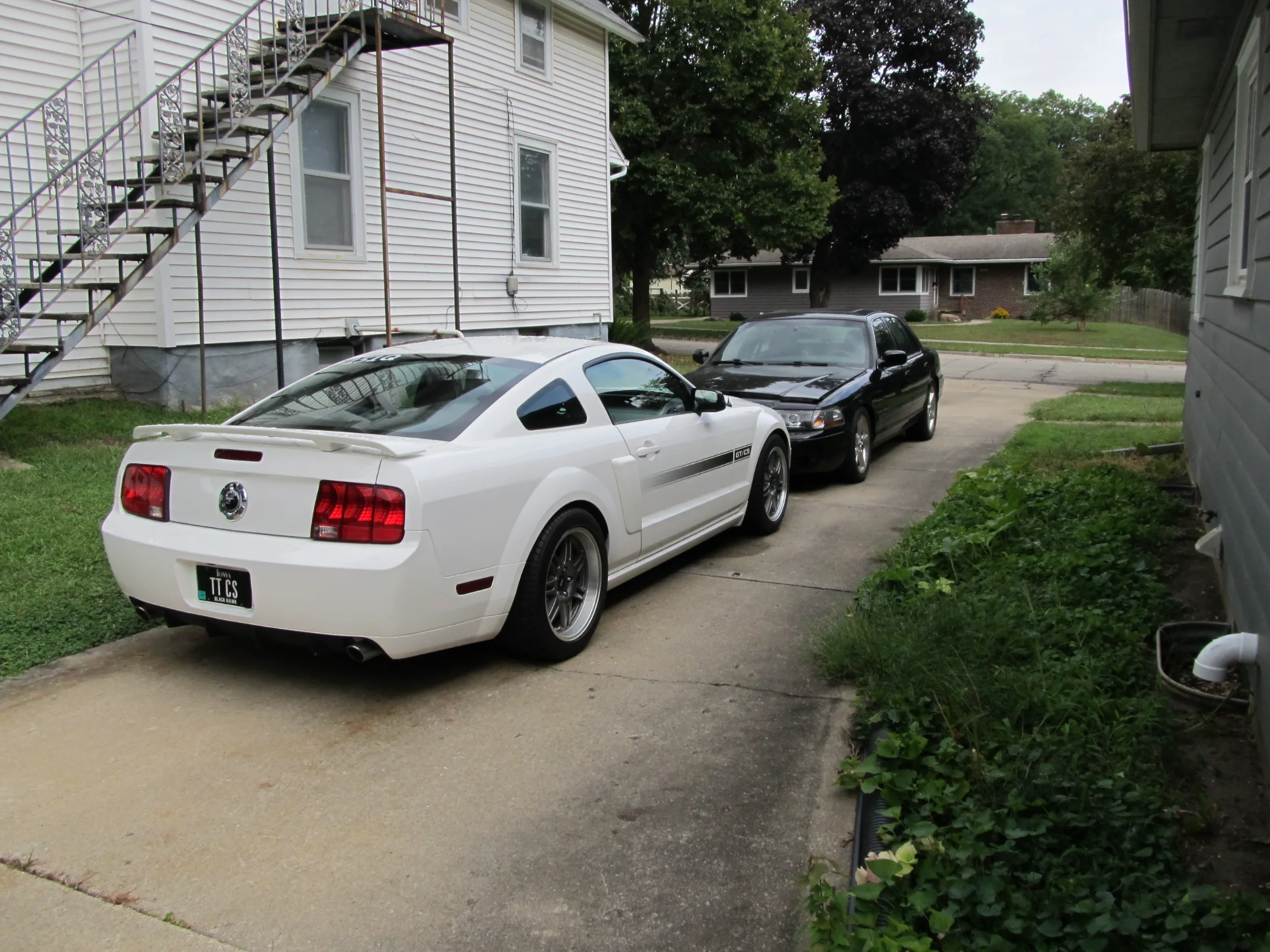

Not a shed pic today because the sheds are full already and they wont fit. My nephew finally got his dad's house sold so I had to move the last 2 cars back to my place. 09 GT/CS and 03 Marauder. Both needed a boost from sitting so long. I'd forgotten how nice the shifters are in these newer stangs. Better than the new Hurst unit I put in my Comet. Driving that Marauder was a trip. The cardan joint in the steering column shaft is fubar. Thankfully it was only 6 miles across town. I wouldn't road trip it until that gets fixed. It goes with another column, and a brand new steering shaft. They both need a new home.

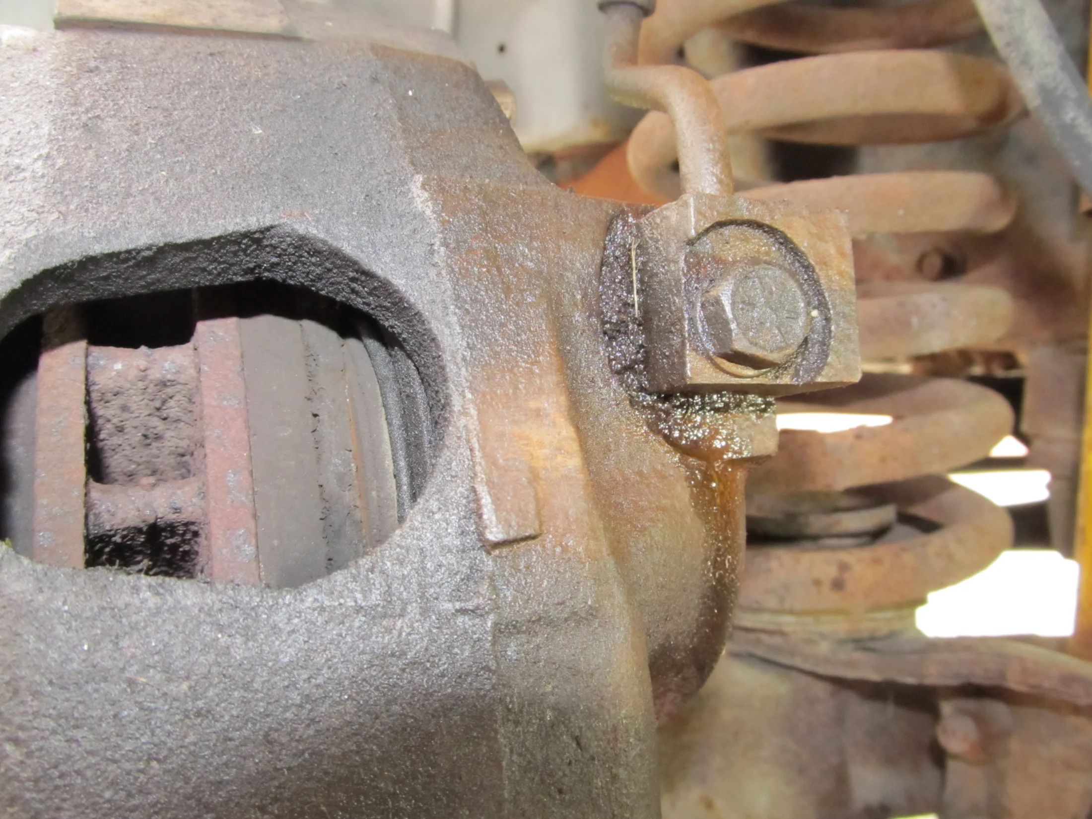

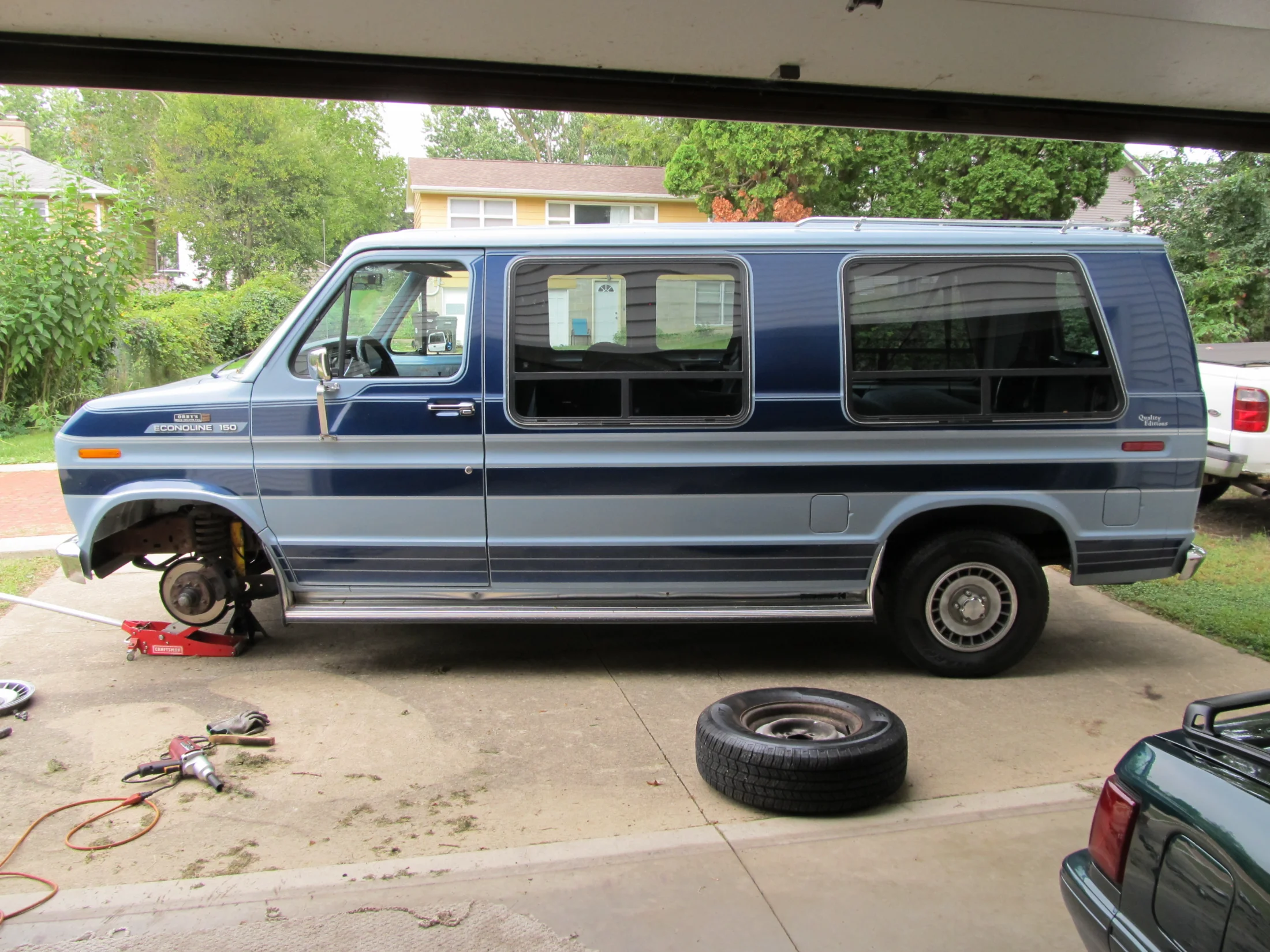

Picked up this 90 E150 to pull the motorcycle trailer. Pretty solid unit with a few issues. 121K. Right rocker panel just starting to rot in front of the rear wheel.
Noticed brake fluid on the inside LF tire. The copper sealing washers have given up. Hoses look OE so changing all 3 is job 1. Job 2 is trailer light wiring. New hitch and no wiring. wtf? Job 3 is the rear gas tank. He said don't use it. Well, this will be no gas mileage champ so that needs fixed. This has the same driveline as the 7Up, 5L/AOD. He said the tranny would slip in OD sometimes. I checked the TV cable for slack and didn't see any. Might need some help on that issue.

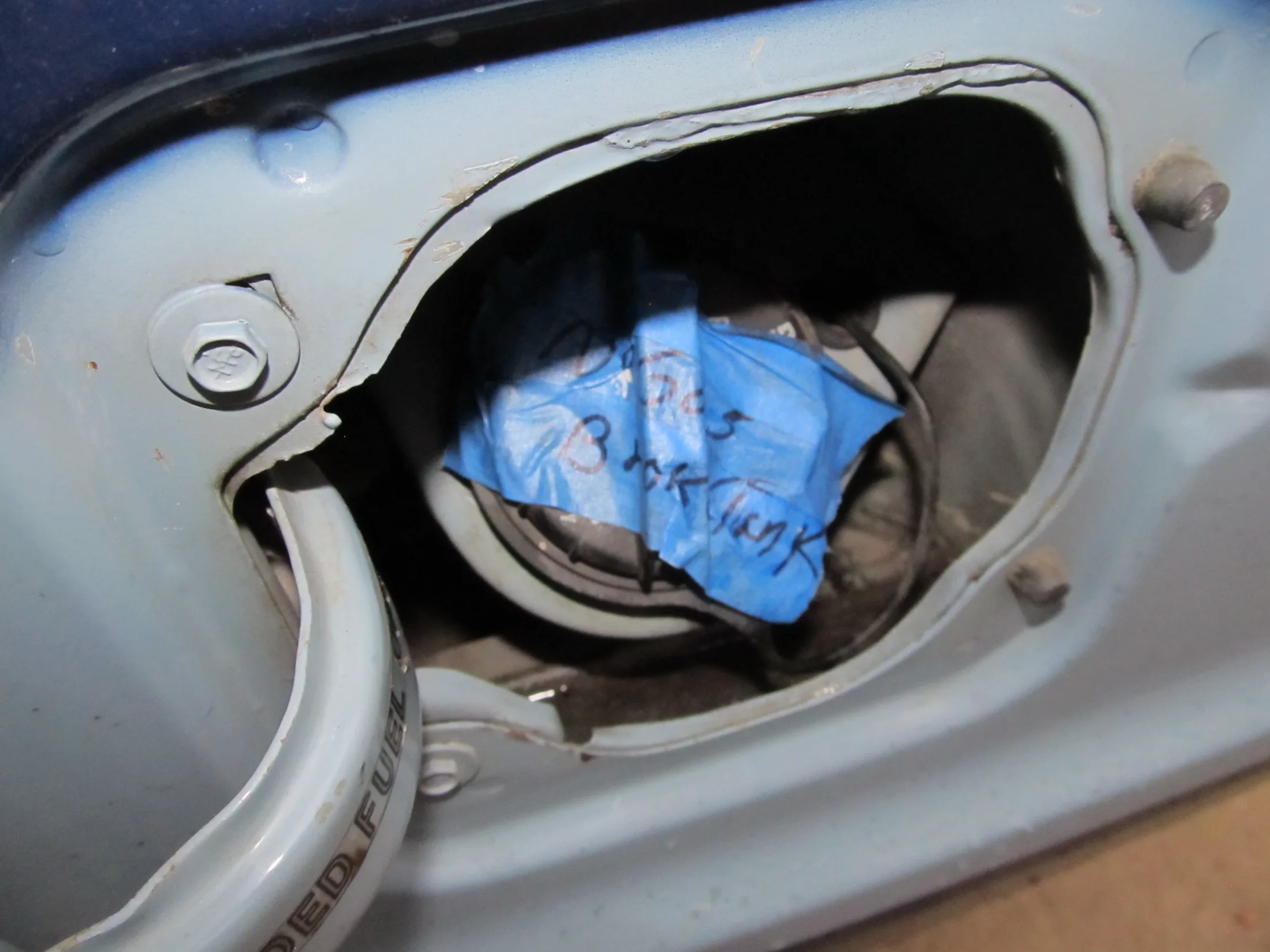

Update on the E150. Looking into the rear gas tank issue, I see blue painter tape telling me the tank is bad, but not what is wrong. Yesterday siphoned 5gal. of the 2yr old Marauder gas and dumped it in. Flicked the selector switch, turned the key and the in tank pump fires up. Gas gauge didn't move so maybe just the sender? Nope. Crawled under it this morning and found a wet spot. Pin hole in the bottom. First Rock auto order includes a tank, straps, pump and sender unit, filter, front brake hoses, and wheel seals.

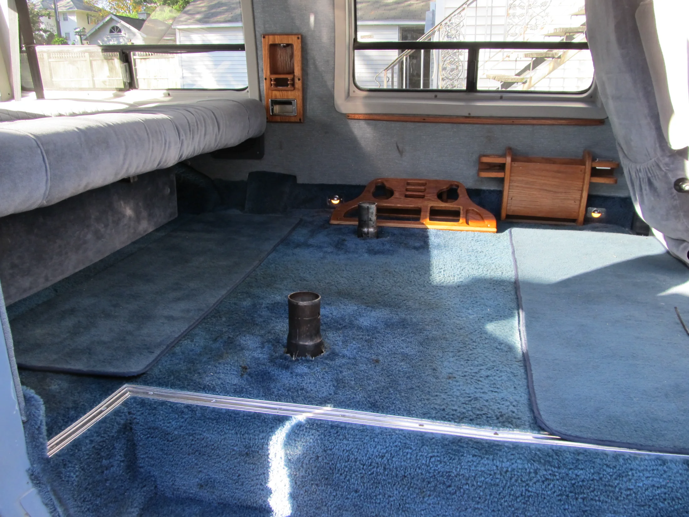

While under there spraying the strap nuts, and middle seat mount nuts with PB blaster, my sister pulls in. She measured the windows for the curtains she volunteered to make. She's a quilter and said the job looks easy peasy.

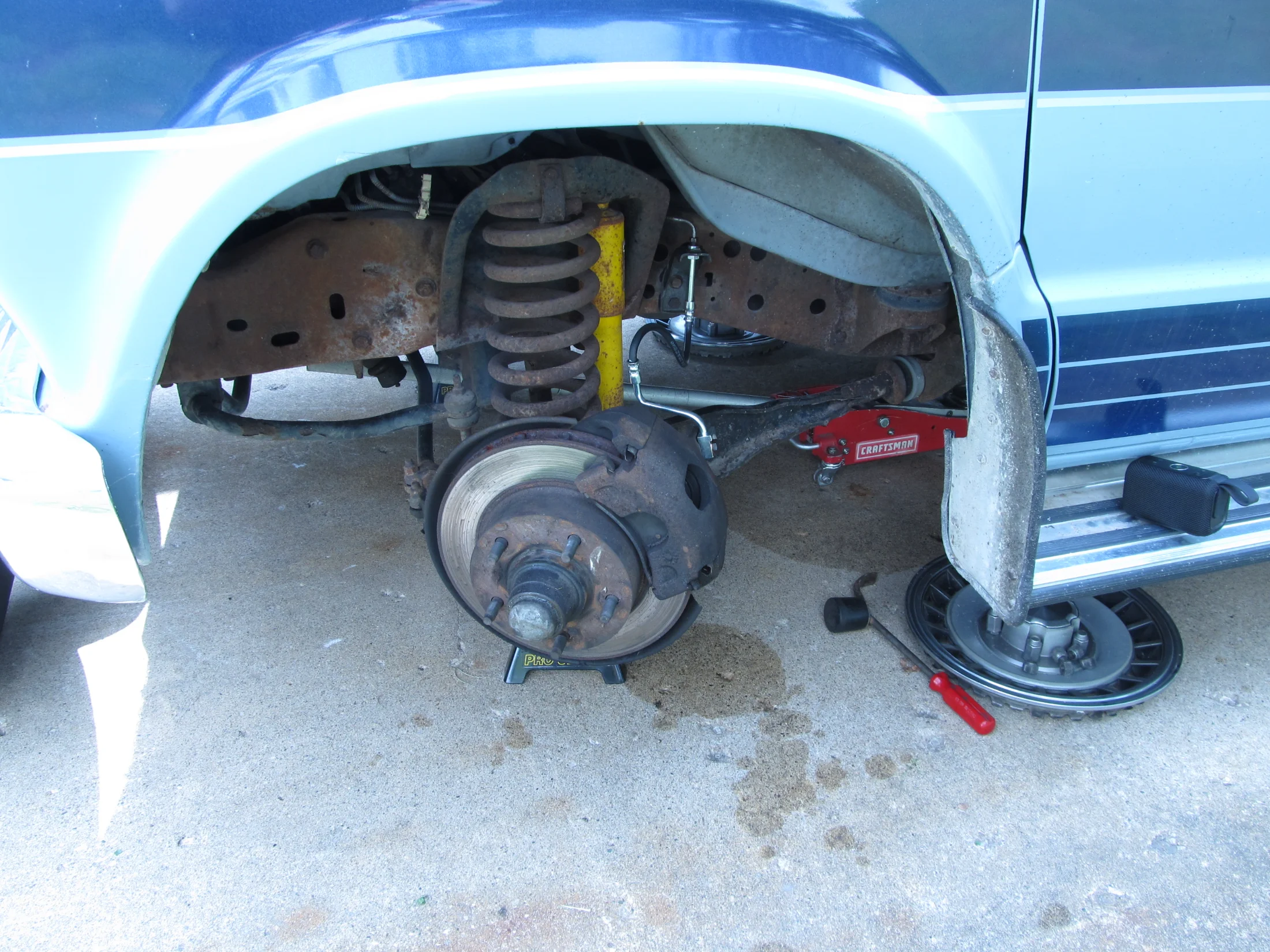

Van worked on today. Gonna get rain next 4 days, and don't want my quickjack lift getting wet so changing the gas tank is on hold. Jack stands don't care so got the brake hoses on. You're having a good day when the worst part of the job is tapping the frame retainer clips because they're rusted stuck. On the left caliper that was leaking, looks like whoever spot faced the sealing surface for the hose went a little deep. The really thin sealing washer that came with the hose got swapped for a thicker one. It can sit like this until the 1 man bleeder helper gets here Monday. S'okay, thats long enough to make sure everything sealed up.

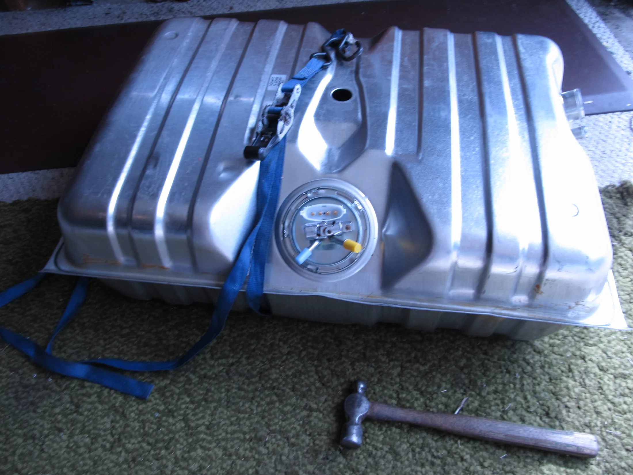

Re: gastank. When working alone you have to get creative sometimes. Putting in the fuel pump, the rubber gasket needed a little more compressing to get the retainer ring started. Tie strap and 1/2" wobble to the rescue lol.

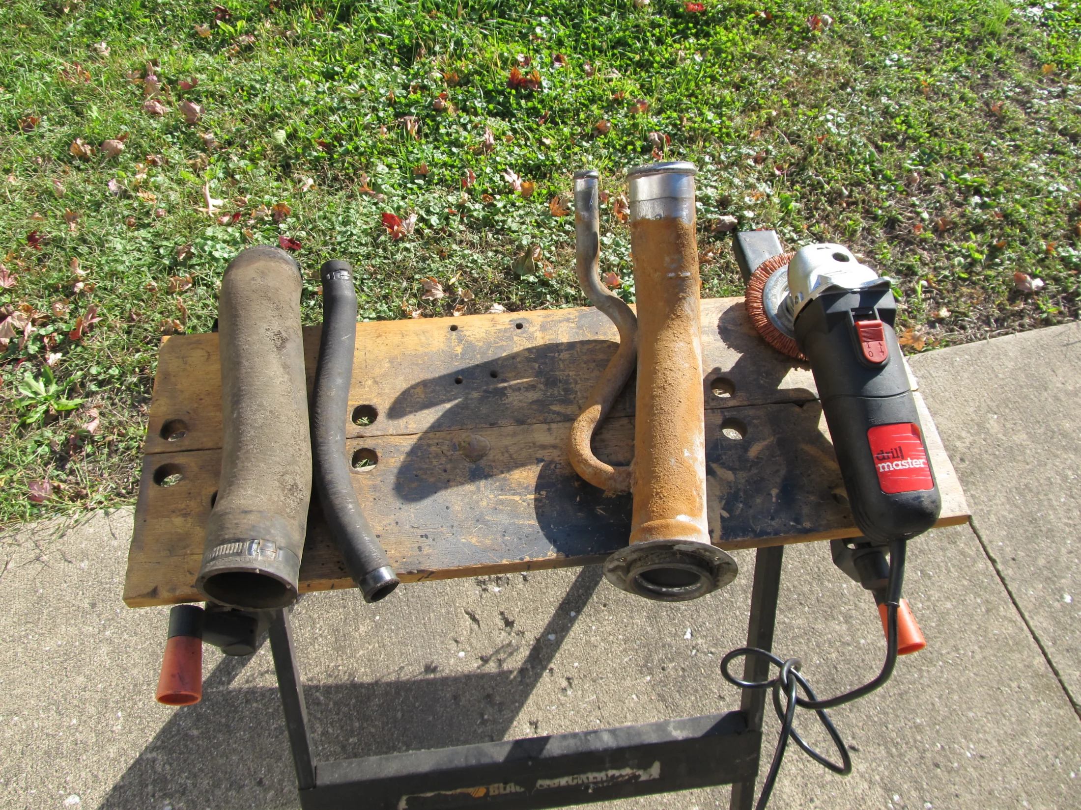

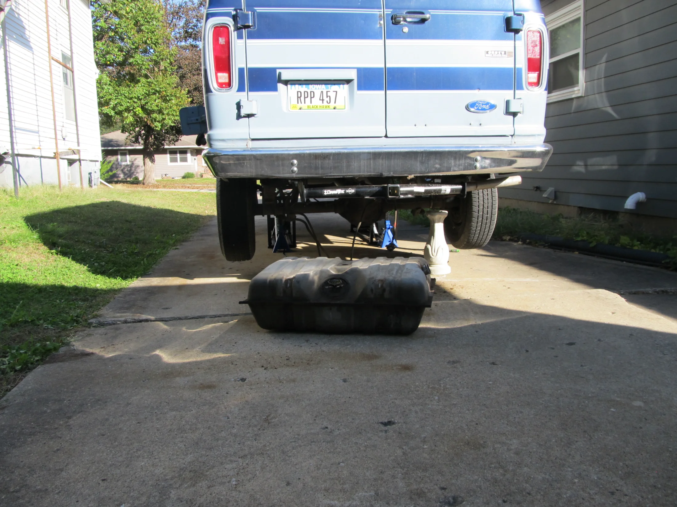

Today pulled the rear gas tank. About the ass ache I expected. Rusted tank strap nuts and hose clamps. Fuel pump hose and electrical fittings that were never apart. The usual stuff. The 5000lb Quickjack didn't break a sweat. Whew lol! Had to get the prybar to get the inlet hoses off the tube. Tube looked janky, and I would have replaced it if I could have found one. Plan B. Found a little can of Eastwood rust coating in the box of Bro's garage chemicals I brought home. Knocked the loose rust off and sprayed it. The rubber hoses were janky also. but a scrub revealed no cracks so they go back on. A 1 beer and 1/2 of a Nickleback cd job. Now have to do some under dash diving to see if they did any switch "altering" when the bypassed the rear tank, and to make sure it feeds juice to the rear pump.. Anyway, progress was made today.

Back in the day I worked at a Ford dealer. The 89-93 F & E series had recalls for the dual fuel tanks where they would cross flow and one would fill the other, or the fuel return would pump into the wrong tank. The hazard was it would overfill one of them and could leak out the filler cap or start a fire. So the fix was to re configure the lines and install a check valve system.
I took so many of those dang tanks out. It was really a pain on the E series. Even though they were pretty new then, the salty winters here are horrible and it was stipped nuts and seized straps all the time.

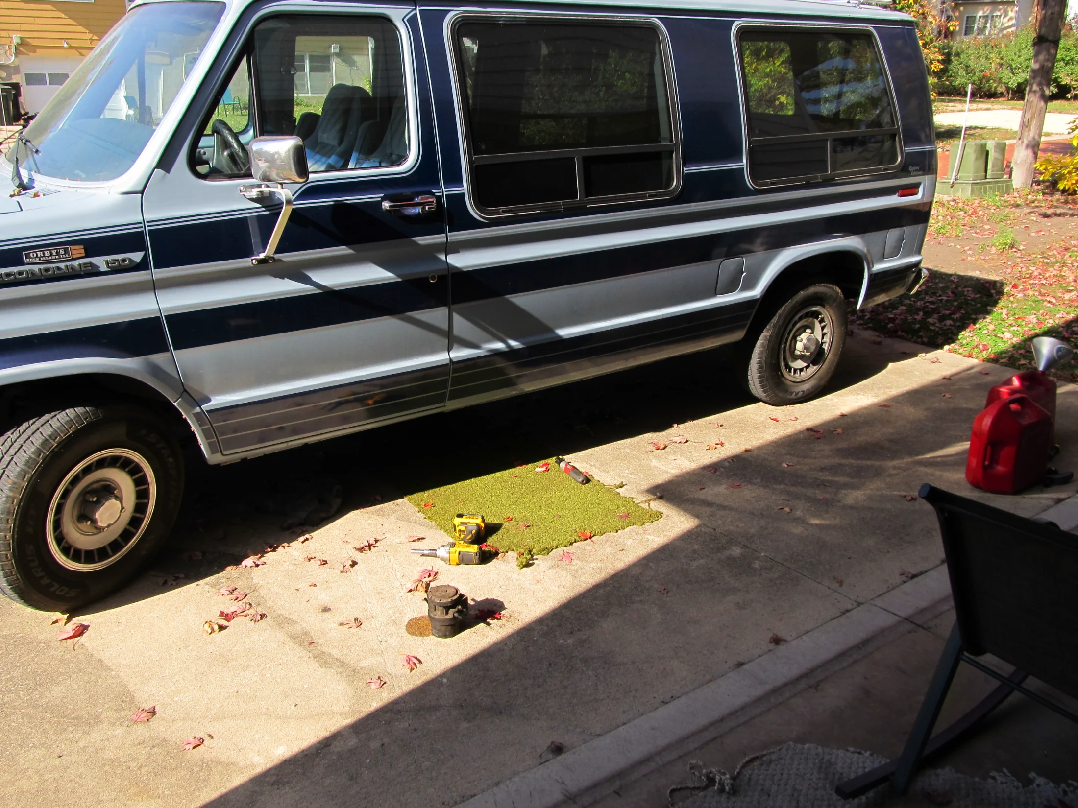

Another learning experience today. Changed the van fuel tank valve. Pulled the rear return line off, and fuel drained for about an hour/3gallons. That surprised me. No biggie, nice day, got a couple chapters of the book read while the stereo was on random. Surprise 2 was the hardware. Std. and metric, 3/8" on the bracket bolts and 10mm on the valve bolts. WTF? Hope the 7up isn't screwed together like this, but being the same year it probably is. Then, the thread pitch on the new valve was different than the OE. A stroll thru the nut/bolt tub saved me a trip to the hardware store. The new tank dash switch worked good. The water pump is here so went and grabbed a new can of High Tack gasket sealer, and will start on that tomorrow.

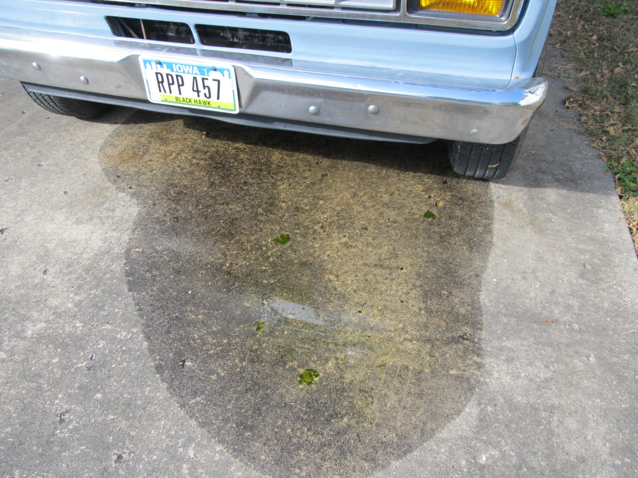

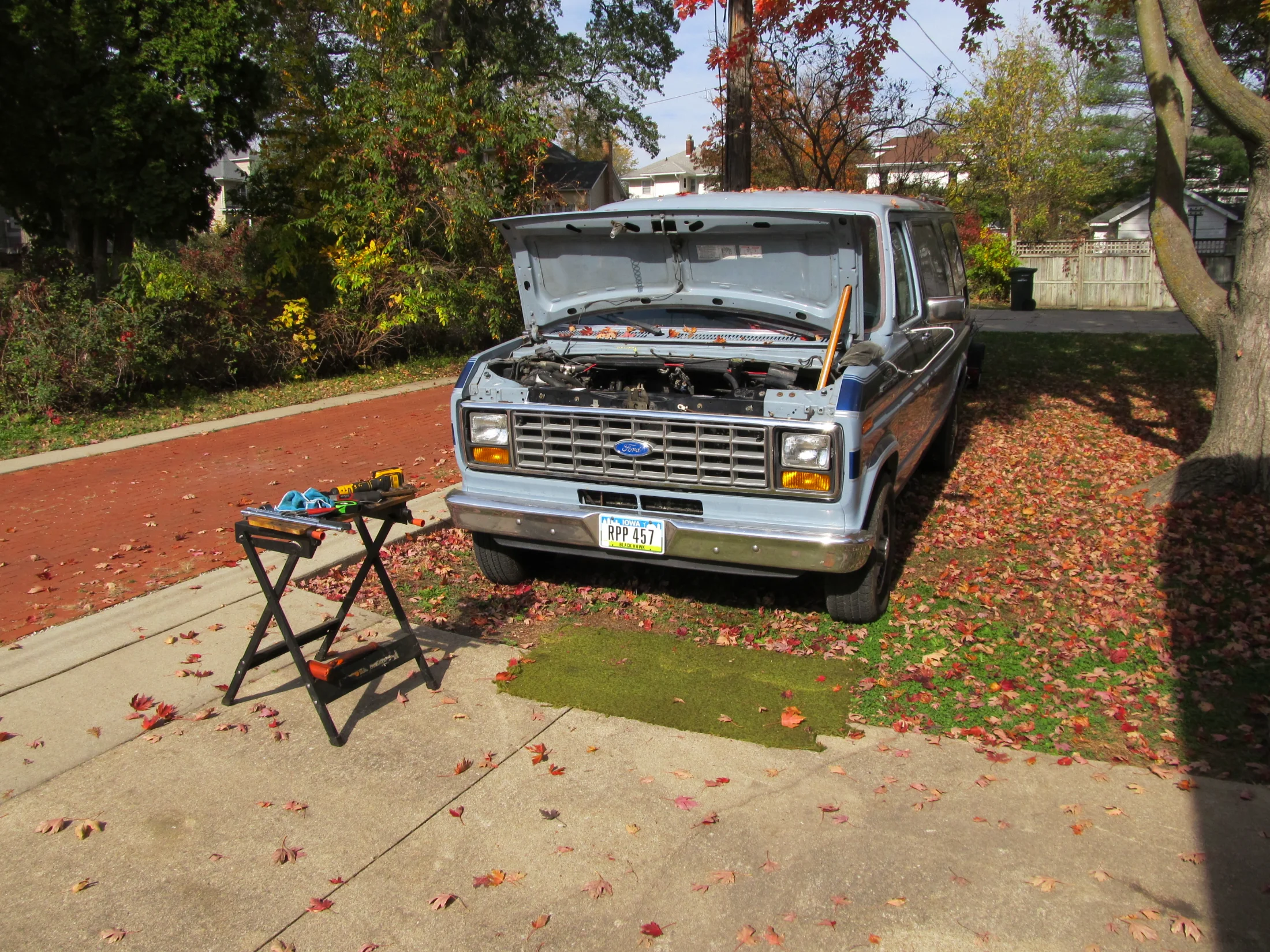

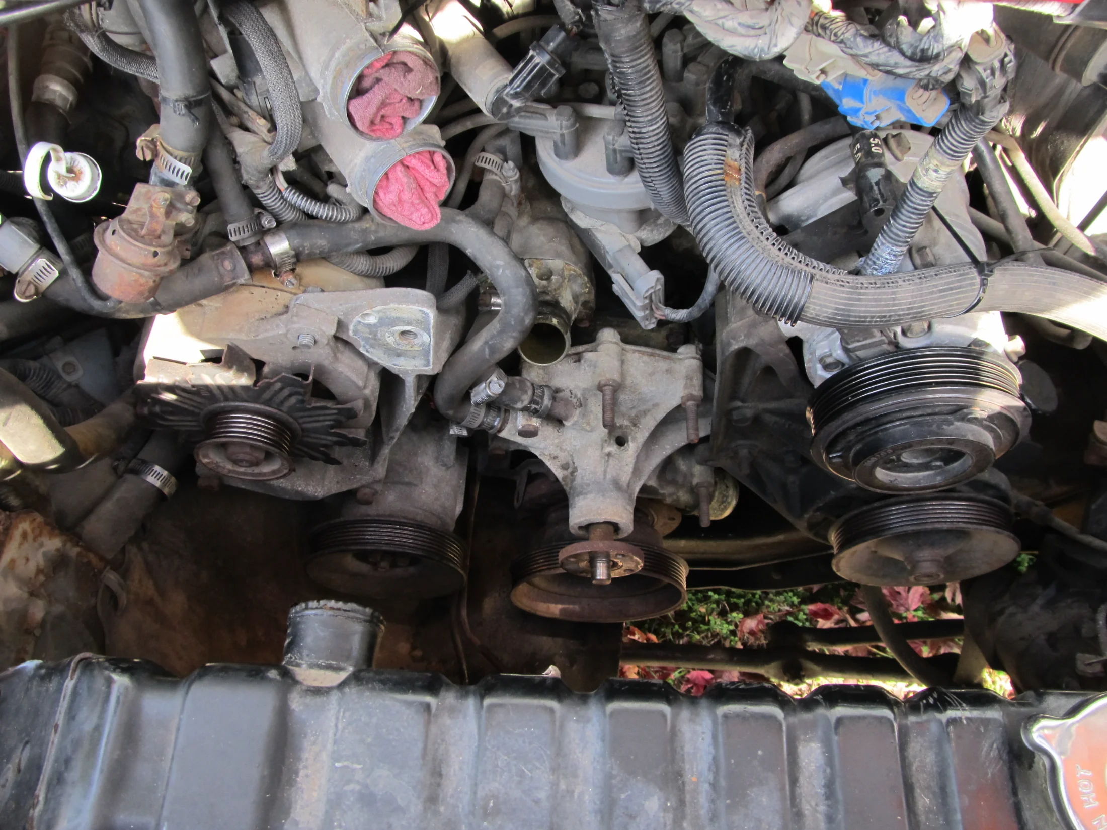

Had a couple hours to start on the water pump. A beer, and some Sly Stone motown got this progress. Bodgery found was a missing fan shroud bolt. and check out that coolant tee above the alt. A missing clamp! Looks like it dribbled some on the alt. The thermostat gasket also shows signs of dribbling on the timing chain cover.. I expected a PITA, but the worst job was loosing the welded lower rad hose from the rad. That's a good day. Got the rad hoses and thermostat coming. Looks like I have an outside shot of getting that pump in without pulling the A/C compressor
bracket, but not holding my breath. Stay tuned, lol! Hope you're having this much fun in the shed.
