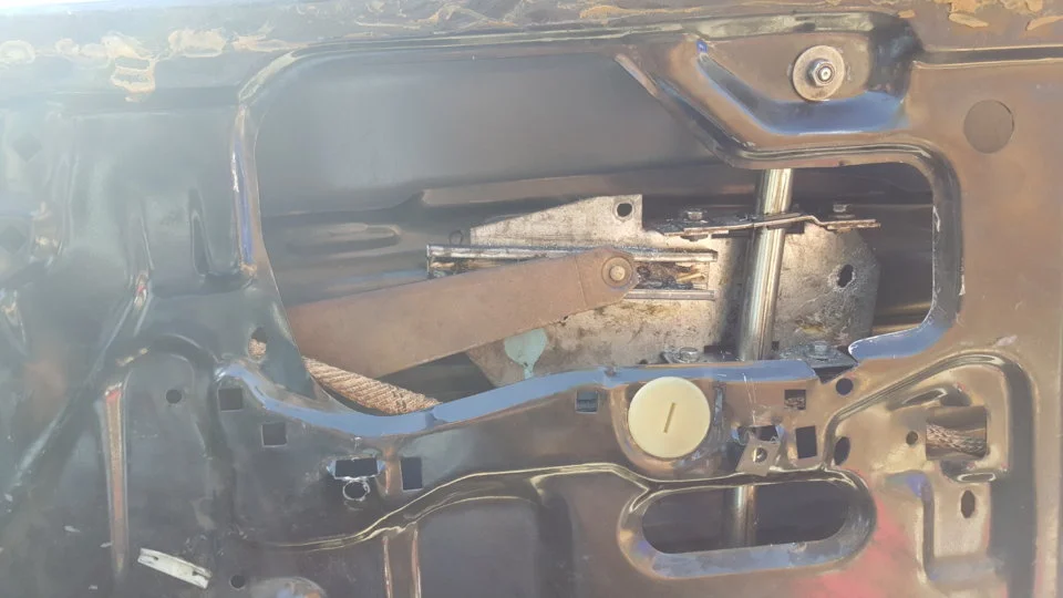

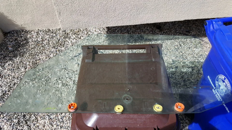

Can anyone tell me what year mustang (if it even is from a mustang) that this glass came out of. I just uninstalled it out of my passenger side door and it seems a bit too big. I don't believe it is made for my 1989 Mustang GT hatchback. In the process of changing guide rod bushings and glass bracket hardware coming to find out the window is too big! One thing after another i tell u. I appreciate it.

Convertible and t-top glass are larger than the coupe and hatchback glass. Maybe someone installed glass from one of those in your car?

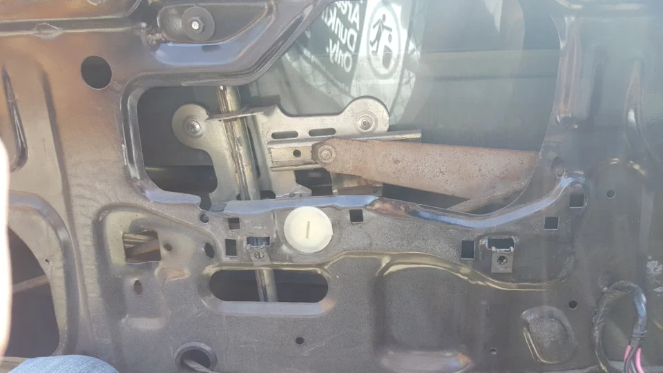

I'm thinking the same. Coming tho find out they also switched the window bracket with a different one. Top pic is correct. Bottom is from god knows where lol. Ordered the correct 1 already and also picking up a new pass side gkass window. I can't seem to catch a break. I just want to drive this damn thing already !

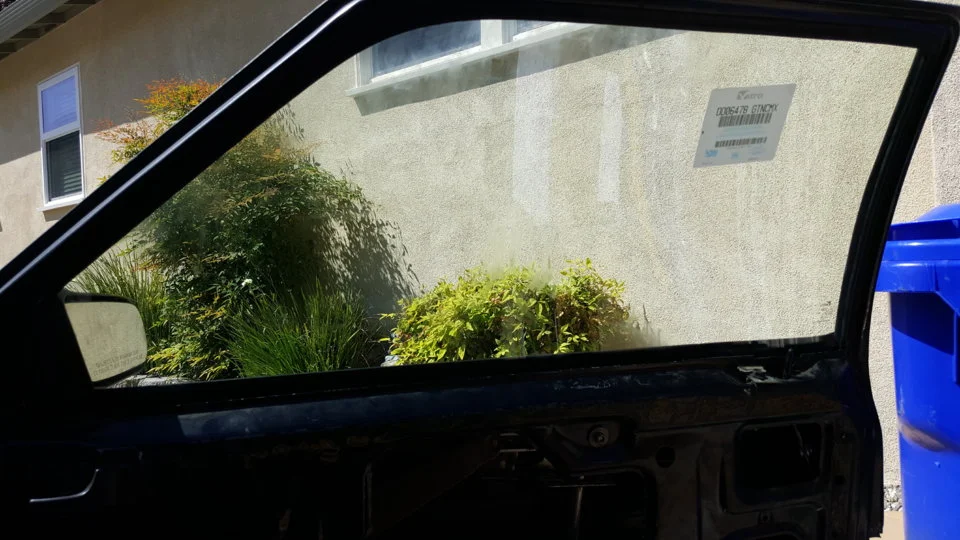

All done =) new window and bracket. Finally a passenger window that fully closes!
