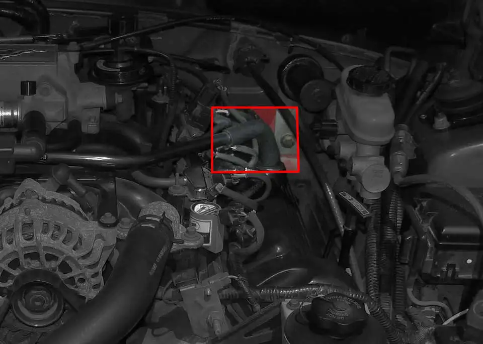

This tube is cracking and definitely needs to be replaced but idk if theres a part number associated with it.
I am leaning towards just needing to go to home depot or whatever and find some tubing of the same diameter but i figured I would check first:
Thanks for any help!

idk, why not just get a replacement from your nearest Ford parts counter?

Or just put a breather there....

  • Apr 29, 2009
thats what i am intending which is why i am asking for a part number

Get one from NAPA Auto Parts!
I took the damaged one off and went to Napa Auto Parts. They had a universal one that fit good. I would say that any auto parts store sells the universal type. Just as good as the one from the dealer. Good luck, Tommy.

they arent listed on my lookup, but there are maybe 5 or 6 total used on all fords. my dept stocks them all and we just match them up when a customer walks in.

that elbow normally doesn't come separate. if you look on the plastic part. from the picture you posted it appear you have a ford part number on the sticker there..its just barely visible in the picture.

thank you both and to GT Tommy. this is exactly what i wanted to know
