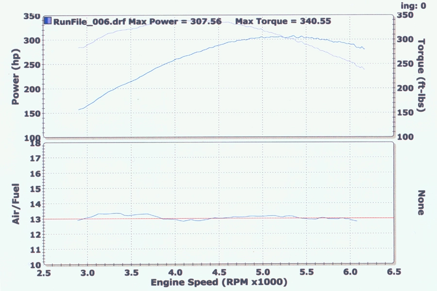

Ok, I had my car dyno tuned almost a year ago, and you can see below the a/f is good. The car has been running with no problems at all...and just the other day, it came up with a P0162 code...engine running rich. Any ideas on what could be causing this? If I just let it go for now, can this hurt the engine?
Thanks!
