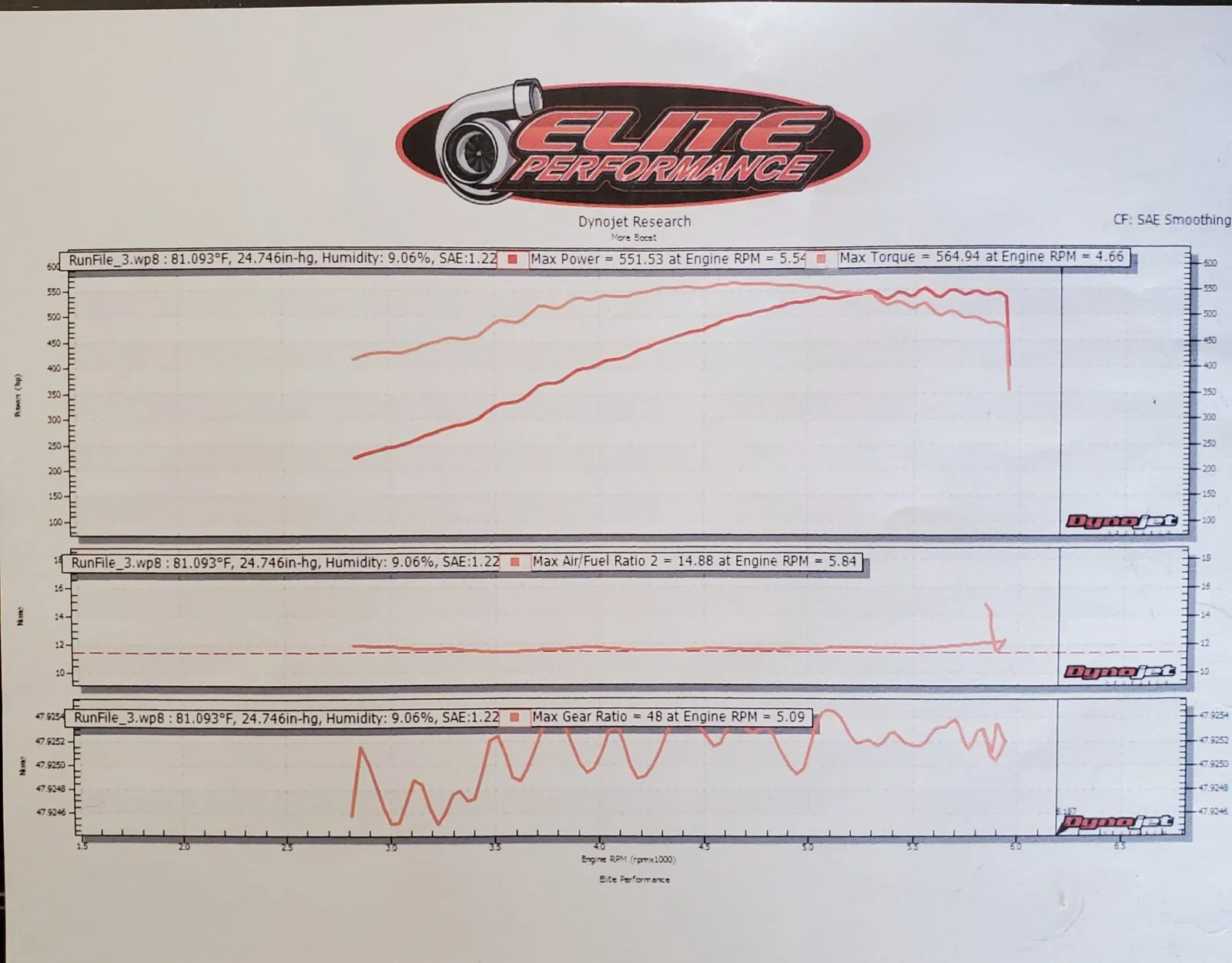

Here is the new run with 11-12lbs boost. Outside temps were about 25*. Shop owner says their reading is generally 30 off when its this cold. We are at about 6000 ft above sea level. I read you can take about a 3% loss for every 1000 feet of elevation, could that be correct? That is another 99 hp if the car was at sea level.
Not bad at all, with better air and sea level i would expect some better numbers but i dont believe 100hp to be the case. either way it looks like a fun ride.
It runs great, I can tell the difference in the low end and top end rpm's with the Holley instead of the Cobra. It pulls much better to 6300 instead of leveling out early with the Cobra intake. I feel like the Cobra had better low end torque which seemed to break the tires loose a hair sooner then with the Holley. I did add full length MM subframes too so that may have also helped but traction is fantastic all the way through with the Hoosiers and this setup.
