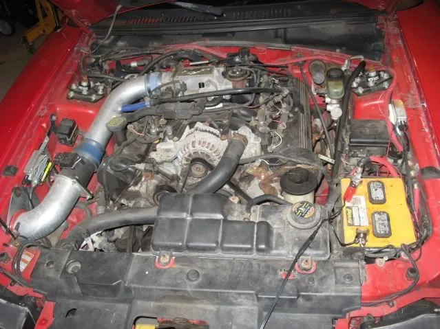

It started out as a stock GT with spun bearings when I picked it up a few years ago for $3,500. I rebuilt it as stock but had the heads p/p and a valve job. Also upgraded to a high flow ford racing oil pump, ford racing headers, clutch, 4.10's, and MM cc plates were also installed. I dropped in some steeda springs too. Drove it for a couple seasons, and then I got the bug again...
I started out with a satin Vortech V2 that used to be a V1 but was just upgraded to V2. So it was more less brand new never ran as V2, came with the $700 upgrade receipt from Vortech too. I got it for $1800 and it came with the stainless feed upgrade, fittings, new cooler spark plugs. I also picked up a steel discharge pipe, 75mm BBK throttle body, and Trick flow plenum.

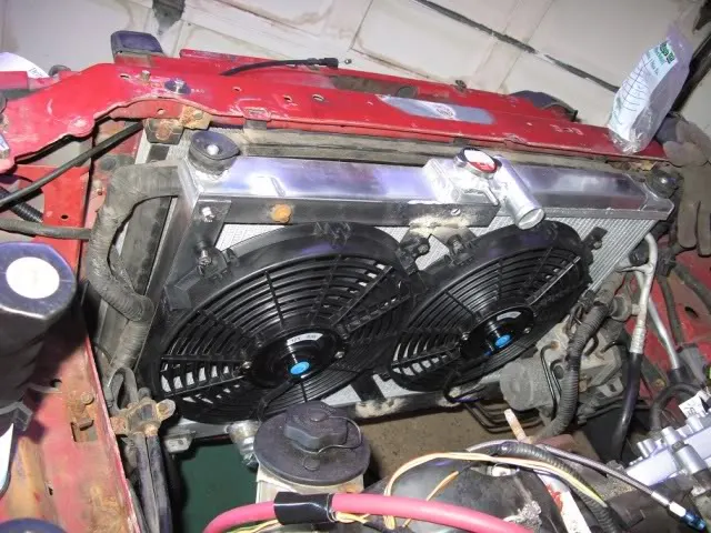

Since the upper radiator hose comes out right where the vortech is, and I figured I could use a better radiator anyway... I got this 2 core radiator off ebay that was the same dimensions as the factory one. It has the lower radiator hose very close to the stock placement and moves the upper radiator hose to where it should be, central. The radiator I got is this: 03-07 EVOLUTION EVO 8/9 2 CORE RACE RADIATOR W/12"FANS and it was only about $150 shipped.
It also came with two fans, which I set up using the factory harness and a relay, so the center most fan turns on with the low setting. I used the relay so that both fans will run on high. (thanks to wmburns for the help with this). I also needed to make a bracket to hold the lower side of the radiator, so I went ahead and welded together a piece to do that, plus mount the fans instead of using one of those wire tie kits. Then I had that powdercoated as well.

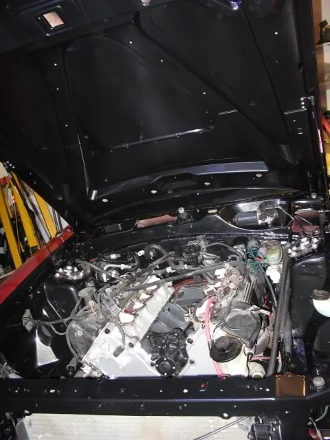

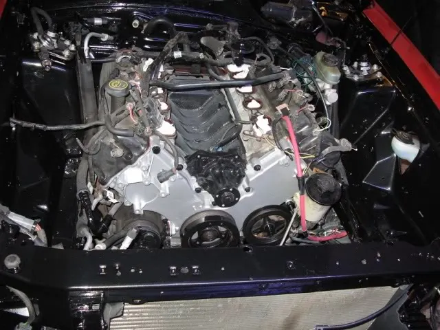

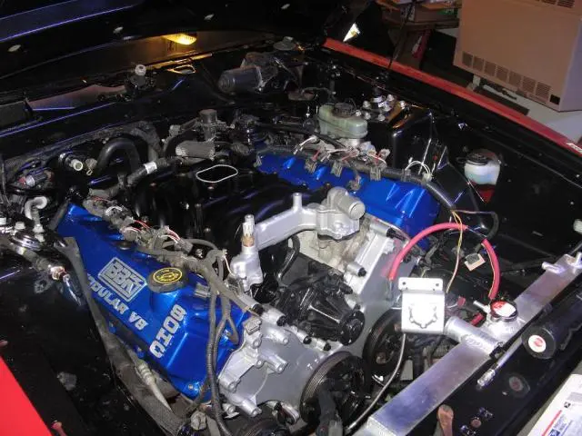

Stripped down and painted engine bay, the same color as the rest of the car will be, House of Kolor Sparkle Black. This was done with the block still in the car, but I did a pretty good job. Free tip: dont tape off as much as possible, use aluminum foil where you can. Its much easier to remove than tape.
pulley's cleaned and/or powdercoated, and timing chain cover powdercoated.

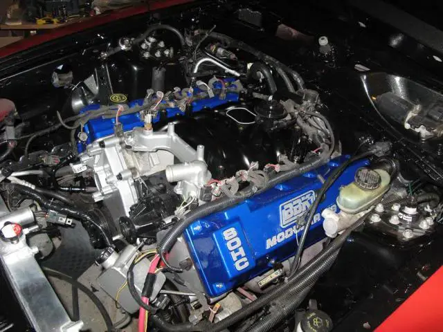

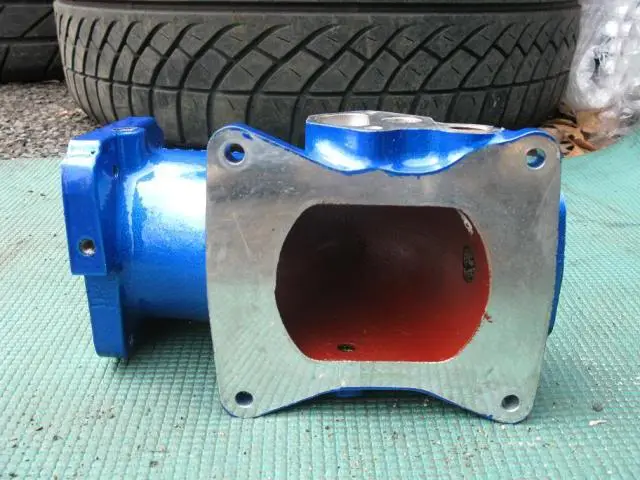

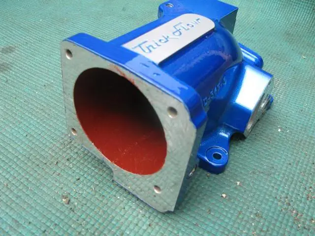

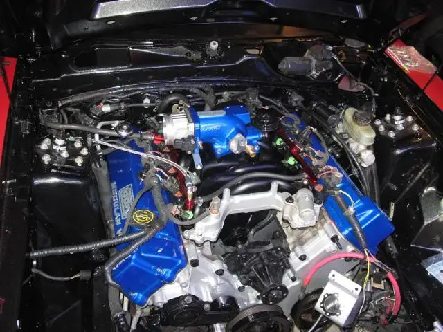

Got a great deal on gently used BBK valve covers ($150) and decided to have those powdercoated in candy blue. Also got a great deal on the trick flow intake ($100 with bbk TB) so I had that done as well.
I used glyptol on the valve covers (which I forgot to picture) and the trick flow intake.
Lower Intake is on. Also had the aluminum crossover powdercoated. You can't buy new gaskets for that so you have to reuse the old ones. I noticed that coolant had begun to eat away the aluminum next to the gasket. I didnt know but it already was beginning to leak a little. So I cleaned it up and used rtv sealant around the edge of the factory gaskets for some added security. So far no leaks. But I'm glad I took this apart because it would have soon been leaking badly if I left it alone.

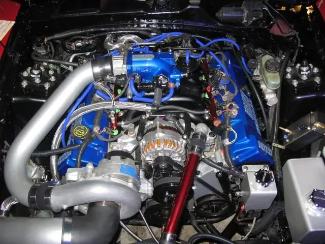

Got the upper intake and Fuel rails on. Couldn't figure out how to use aftermarket fuel rails with the returnless system. So I just ended up having the factory ones powdered right over the chrome. Went with candy red to get something other than blue in there. I thought it would pop and it sure does. Not so much in the pics though.

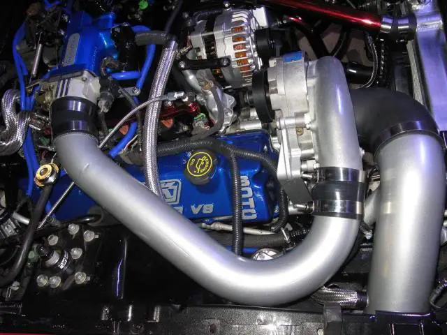

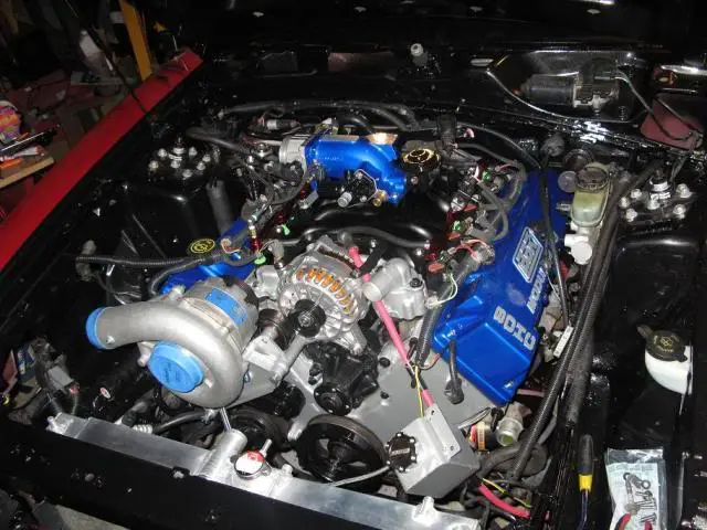

First pic with the blower on there, and a New alternator, I got a 160 amp bosch on ebay for $90 shipped
and its already the right color.

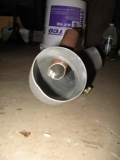

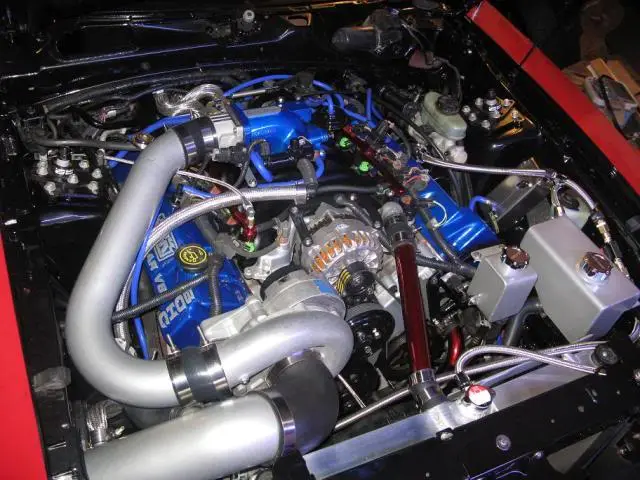

I used an ebay cheapy ($35) oil catch can that came powdercoated in gun metal. It seems ok for what it is. no complaints but I swapped out the fittings on it for better/more usable ones. I ran from that to a husky air compressor filter. I also used some left over vacuum lines to Tee both drains together and added an on/off valve to use for draining them.

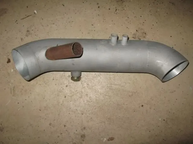

I decided instead of buying the factory vortech intakes that I would just go with AFM powerpipe and similar discharge pipe ($80). I found a used AFM powerpipe for less ($180) than it would have cost for the boost robbing plastic tubing that vortech puts out.
The guy I'll be using to dyno the car, and make sure the final tune is perfect, is Mike from J+M Motorsports in Manchester CT. There is not a ton of shops in CT as far as I know. But this guy won me over with all the track pics of his cars wheelieing down the track, and he is pretty reputable here. Anyway some of the advice he gave me while part shopping... Stick with stock Ford parts where can (i.e. Cobra tank and pumps ($775), Lightning Maf ($50) and injectors ($200), Lightning (screw in) IAC sensor ($18). He also said to make sure to route the recirculation air re-enters the powerpipe at a forward angle, NOT straight into the side of the powerpipe like it comes. He said that the air going straight into the side of the pipe can cause unneccessary fluctuations in the air flow as it bounces off the side. He said to angle the inlet toward the s/c on the inside of the powerpipe, so I capped the stock inlet. I welded the new piece on the almost exact opposite side of the powerpipe as where the threaded hole is. It provides a perfect point (IMO) for entry directly in front of the maxflow valve.

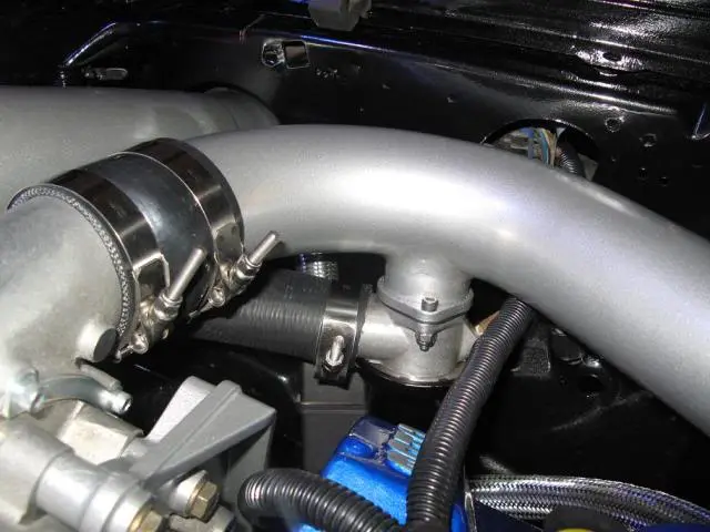

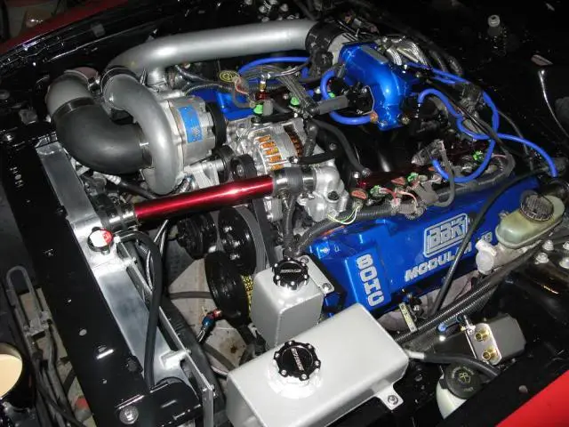

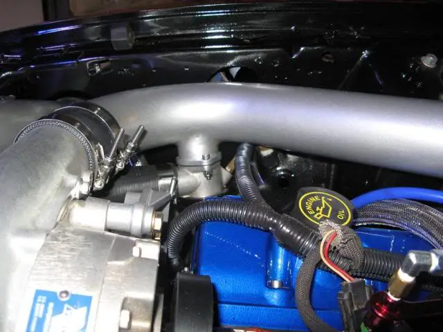

You can see the way I routed the bypass valve in the pics here, and notice my upper radiator hose to match the fuel rails. The lower hose is there too. It was a Chrome Steeda set that I did some machining to to get to fit. Also grabbed some blue silicone vacuum hoses from Siliconeintakes.com which is also by far the cheapest for T-bolt clamps too. And I know there's a lot of s.s. braided line haters here, but I like it so whatever. I may have to lose the magna clamps though and do some proper fittings cuz I hate those... What a rip off for crappy magna clamps! uhg.

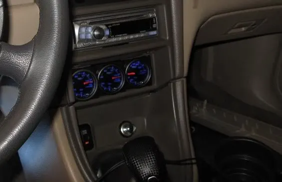

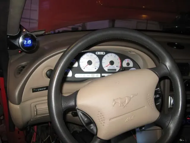

I added a Innovate wideband A/F ratio gauge and a stereo gauge pod with oil press. fuel press. and boost/vacuum gauges.

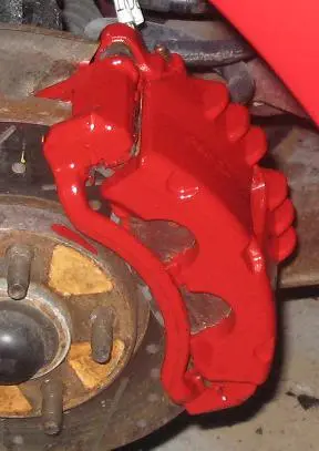

And I even got around to painting the calipers...
