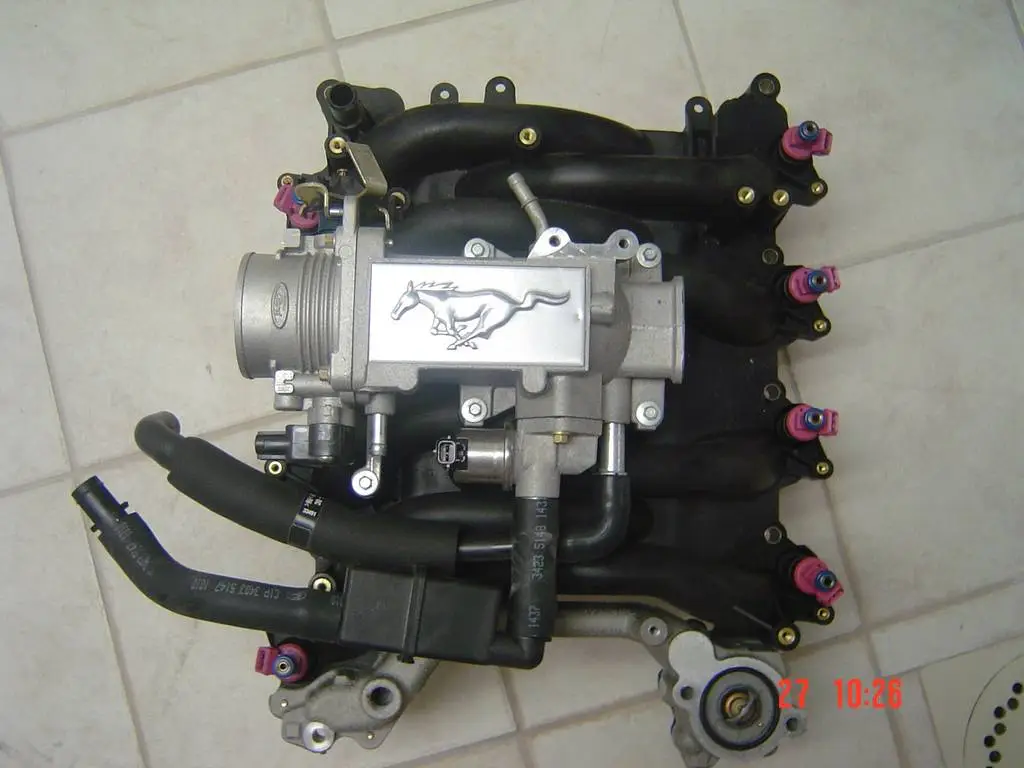

I'm trying to buy a replacement manifold and I'm trying to determine what year this one that is for sale is. And if anyone know if there's a difference and what it is between a '99-'00 intake and a '01+ intake that would be just as useful.

The 99-00 intakes are all plastic. That looks to be an 01 1/2+ model although it's a top down shot, so it's possible it could be an NPI replacement model - not likely, but could be. Do you have a side or front shot?
JonJon said:
yeah, i was going to say I suspect it's middle of 01+ because of that.
So, they changed from orange to pink in the middle of '01?
They may not be stock injectors, anyway. Does it matter anyway? Is a '99 intake any different in terms of compatibility and performance than an '02+?
