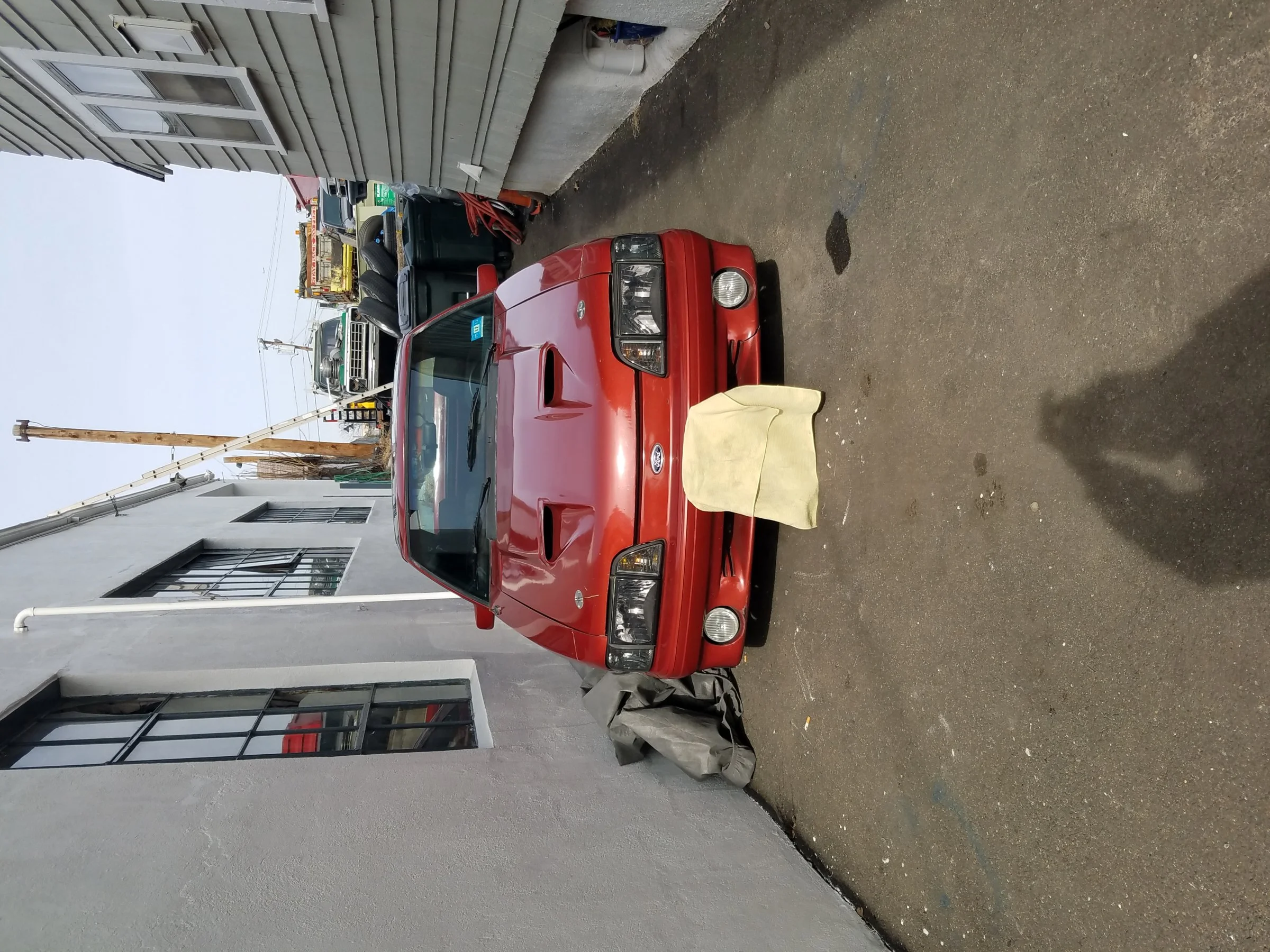

What is wrong with yours?

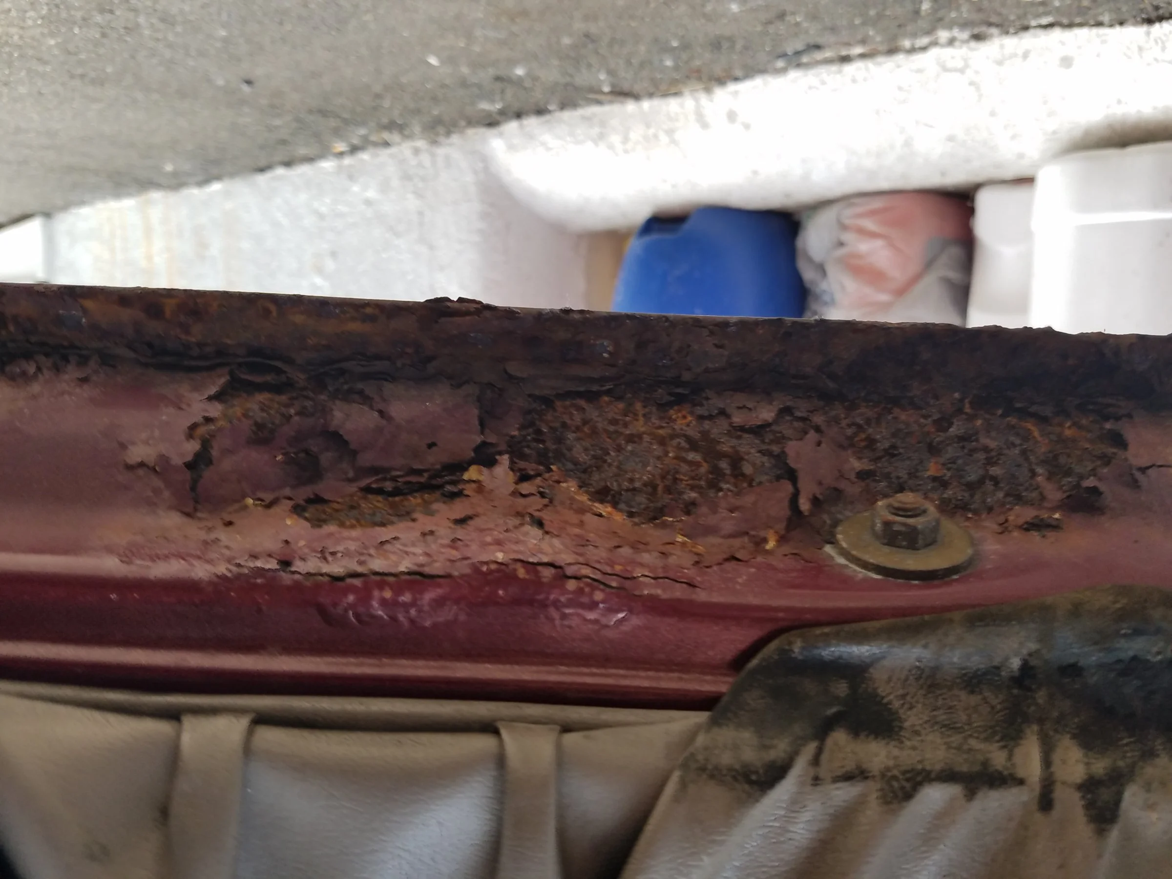

How bout some pics, some things can be fixed and vert and t top doors are getting hard to findThey are rusted out on the bottom

He has a convertible, t top style doors, he also has a pic of the rust damage at the botton of the doorsI'm not overly positive, but i think there is a bracing in the t-top doors that will need to be transferred over to the convertible doors. Ask two months from now and i'll be able to tell you exactly.

Uhmmm.....+1 to the rust though.He has a convertible, t top style doors, he also has a pic of the rust damage at the botton of the doors
Easy mister, Mike posted the picture of the convertible.Now I'm confused, you have a convertible posted and a t top avatar pictured, which is the one with the door problems
