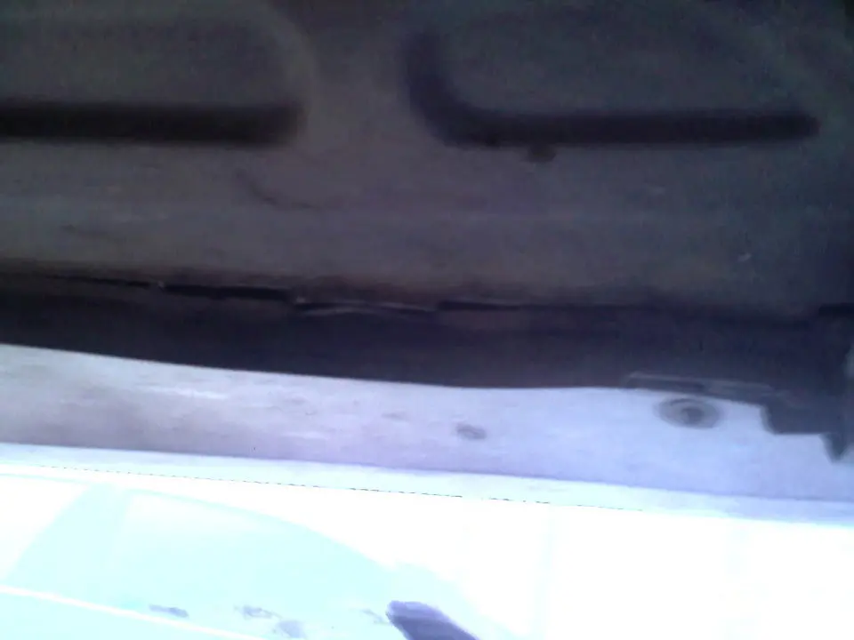

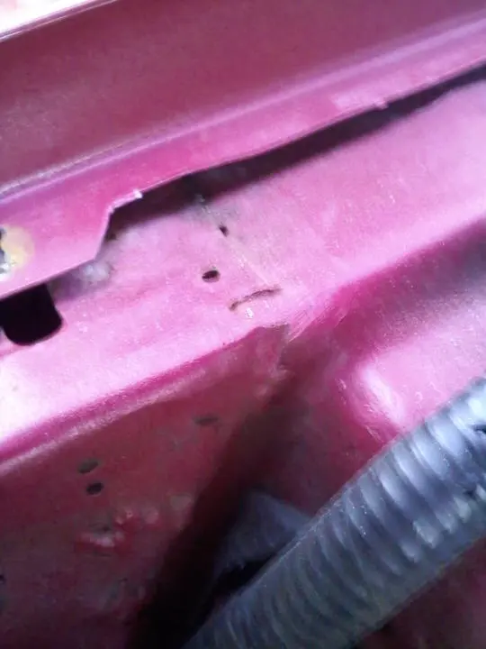

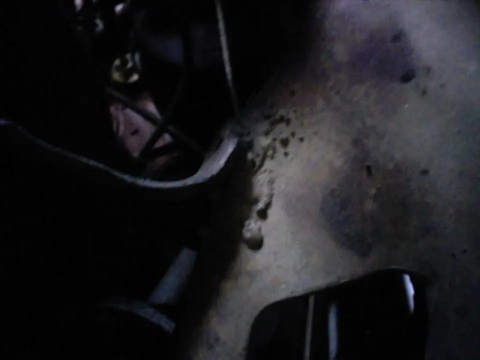

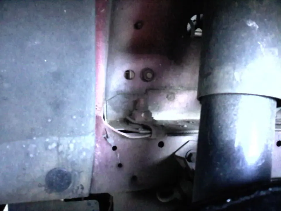

heres some pics.
passenger side fender-
k-member-
rocker panels-
wheel well-

Are you sure the k-member is welded up?? I can't really tell from the pics but the k-member is bolted to the car and can be removed. IS it welded to the car in your pics??
If so, i guess you gotta find a new k-member
Also, measure the distance between your shock towers. MEasure to two hard points and ask someone to do the same on their car and compare
