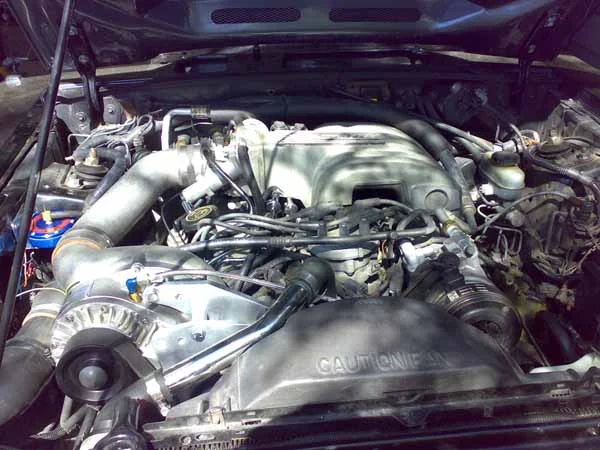

was just thinking! i boke a bunch of those really crappy plastic lines for the smog pump, do you recon that might be why its acting up? i've taped them back together using repair line and such but they are in pretty bad shape! is it enough to eliminate the smog pump??
if you broke the lines and DIDNT plug them up, there's your problem.
