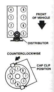

So we recently rebuilt the motor in my 95. At first we were having timing issues and thought we fixed it. It idles alright, but when we went to test drive it, it fell on its face and wouldn’t supply power and back fires. We think the dizzy isn’t timed right but it’s running and no matter where we turn it it’s falls on it’s face at WOT.
No we did not use a timing light. Lined it up with compression stroke and harmonic balancer. And could be wrong firing order. But I don’t know. Been giving me a rough time.
