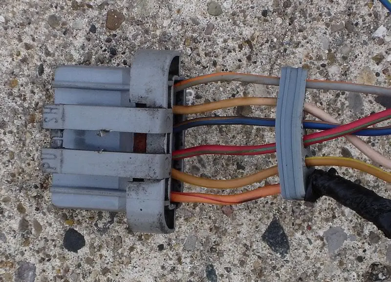

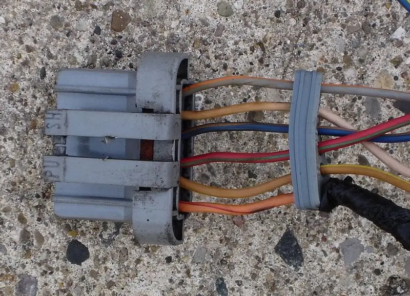

triple check your TFI wiring, i know stinger used his 91 for wire color reference and on the 92's are probably 93's as well the wires colors were slightly different. It should look like this..
This is what mine looks like and i flipped the key and the car started instantly.. with no problems at all.
You also MUST spice all the old coil pack wires together. just put all like colored wires together.
