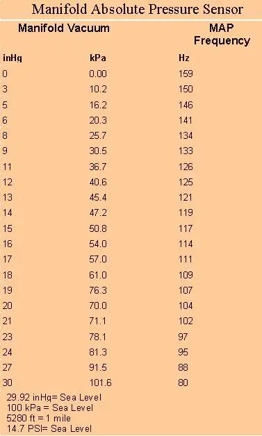

View attachment 307934 ... if cruising emissions is what the EPA cares about, why have I been working cases that fail emissions testing at idle for the past 16 years? .... or, why would they establish emissions requirements for driving conditions other than cruising?
Idle, in my mind, is still a "cruising" situation. If you've know the EPA to care as much about WOT situations as they do about light or no-throttle situations, than I don't have an answer. Your experience is different than mine.
