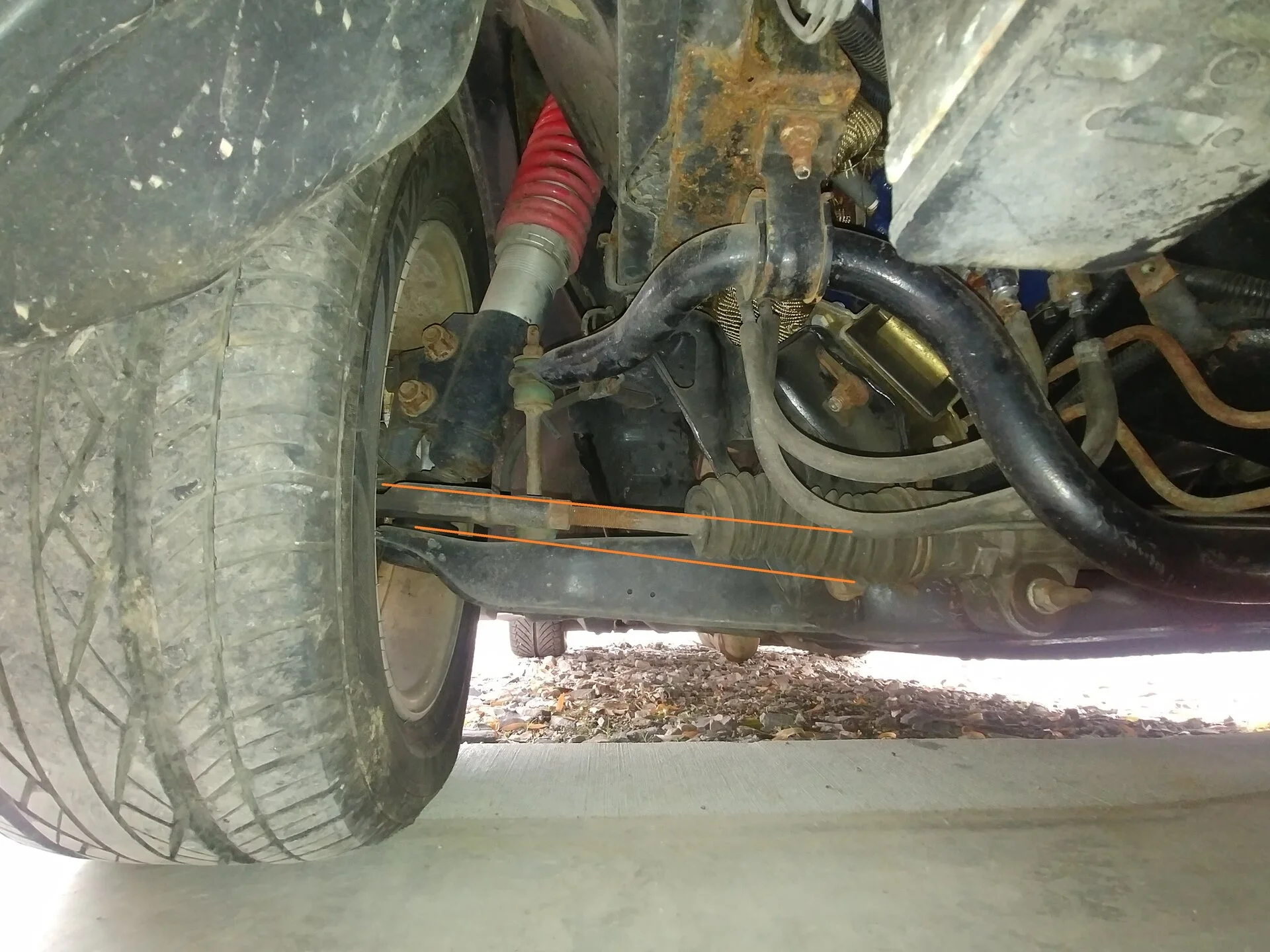

To minimize bumpsteer you want these two lines as parallel as possible. Top line is between pivot points on inner and outer tie rods, lower line is centerline of control arm bushing and pivot point of ball joint.
Even when they are parallel it is not perfect (zero bumpsteer), but it is pretty close. One thing that contributes to it being not perfect is the control arm is 13" between the pivots and tie rod length between the pivots is about 13.5"-13.75". If they were the same dimension and parallel you would have zero bumpsteer.

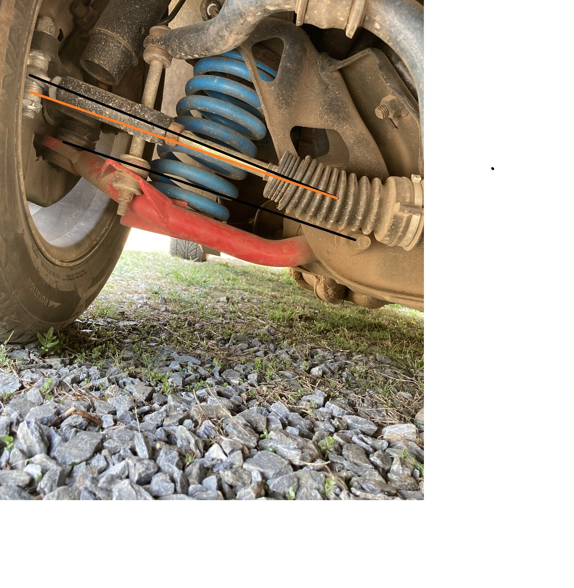

The black lines being current state, the red line would be very close to parallel.
What's interesting looking at the picture, specifically the spindle are to tie rod, if you had '96-04 spindle (with everything else the same), you could probably use a stock outer tie rod and be pretty close to parallel. In case your wondering, I use a spindle from an '01. So look above at the pic of mine and how much lower to the ball joint my upper line goes at the wheel.

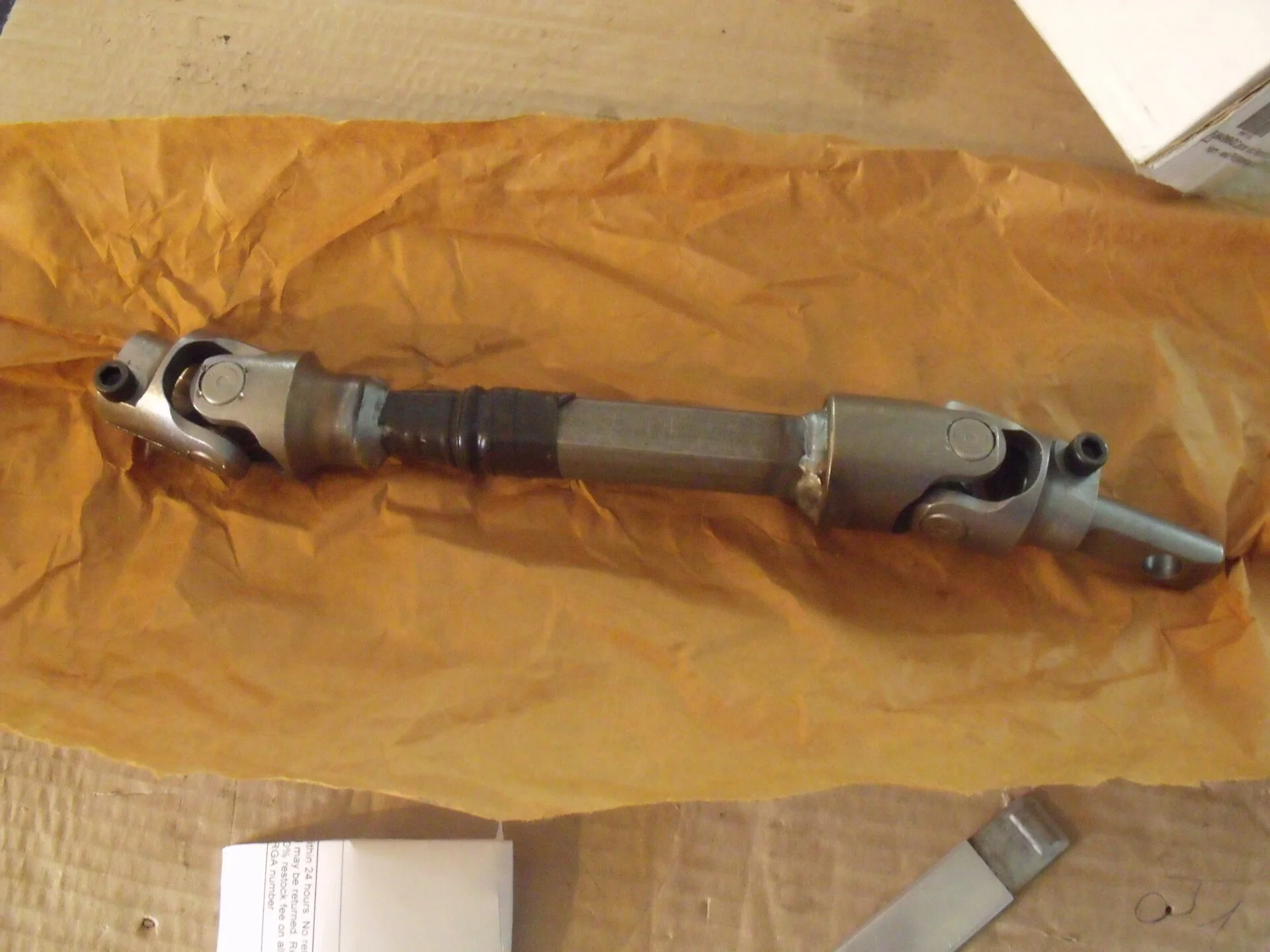

I've done both, a replacement rag joint and the MM unit.
My thoughts were that the MM was notably better.
