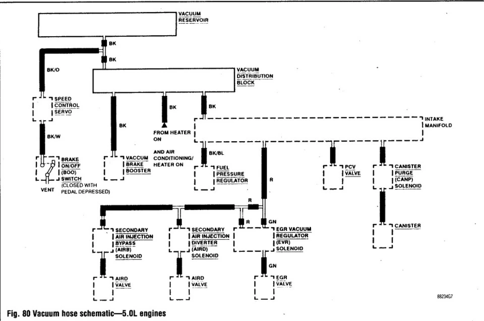

Other question - does the red or the green wire go to the EGR?
check batter connections (clean and tighten) and test battery at a local autoparts store is where i would start.this time of year is especially hard on batterys...most batterys will go out in the start of summer (hottest time of the year) or at the start of winter...
oh and the other question does the red or the green wire go to the EGR? these are not wires there vacuum lines and the green connects to the egr valve.below is the vacuum diagram

vac lines were right...and I knew they had no bearing on the problem...just wanted to make sure they were right.
