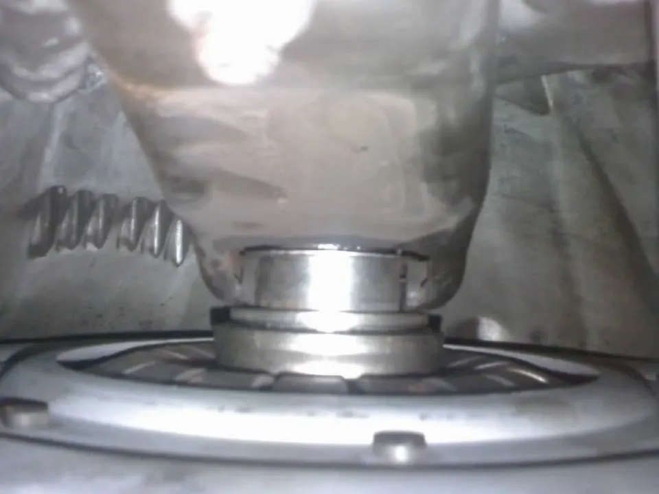

well guys i think i might of found my culprit. i dont think the clutch is releasing or something. cause the throw out bearing and fork are tightly pressed up against the
pressure plate. below are some pics of what im talking about. so how can i fix this?
im not sure what could be causing it cause it was driving fine for teh week that i had it since i got it back from the shop and was driving fine the day before and then the very next day no go. i just went and pushed in on the clutch pedal and help it there with some supplies all the way on the floor and got underneath the car and seen that the clutch fork and everything moved forward with the pedal pressed in, so what could it be. low fluid or pedal might need adjusting

It's pretty safe to say, either the clutch was installed improperly or has failed. Going forward, you mentioned the clutch fork moves when the pedal is depressed, that isolates the issue to the clutch.
Like you said, start the car up and it wont go into gear. If you can hold it to gear to the point it wont go further, shut the car off and it slides in it needs a clutch. I'd get it towed back to the shop that just installed everything since it was just done.
And a word of advice, dont **** with it. If it was due to the shops workmanship, you messing with it may lead them to saying they are no longer liable. Just get it towed and tell them whats going on. This should be covered by the shop or part warranty from the manufacturer.

It could be a bad clutch fork, bad pivot ball, or the clutch could have just plain failed. Need to look inside to find out. The squeaking is from the TOB that jut went out, same with me. Look back in there and see if anything has changed, like grease coming out of the TOB.
