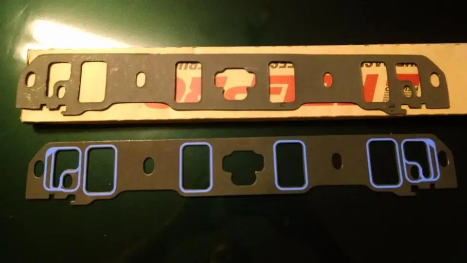

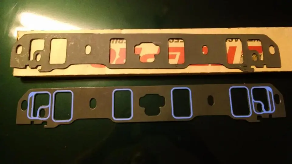

Yes I realized that was part of my problem after I took it apart. My mistake 100%. The gaskets are wrong. I did manage to get a ford racing gasket set today that is supposed to be for the gt40 heads. Don't have part number with me but the gasket is larger and I can tell it will fit properly compared to what I used which was a stock 93 intake gasket set. Tomorrow should have it back together. Thanks for all of the help. Here is the gasket I got today. Disregard the fel pro box its on. It didn't come in that. Does this gasket look like its rhe right one?
*Edit The Ford Racing Gasket is actually a fel pro 1250. I guess they make the gaskets for Ford.
