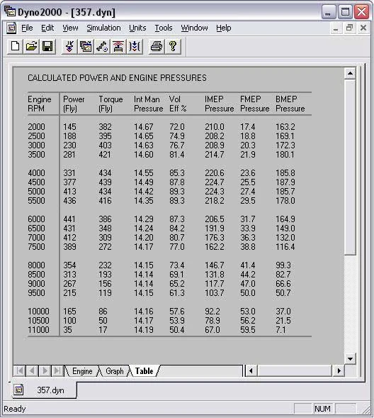

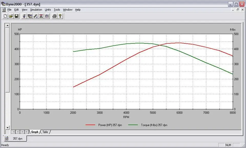

Okay, I have a strong yet streetable 351W that I am hoping to fire up pretty soon (after I get electricity and starter). I am expecting 415-420fwhp, but desktop dyno says even more here is the chart:
I bought a vac sec Holley 750 for it but have started to wonder if that is too large. Since then I have also been wondering if I should have picked up a BG Demon carb instead. So based on those performance curves and the breathing patterns based on specs in my sig what is the best carb for my motor?
Here are some more numbers from DD if they help:

I think you have more FWHP than you suppose.
The DD graph is probably closer.
