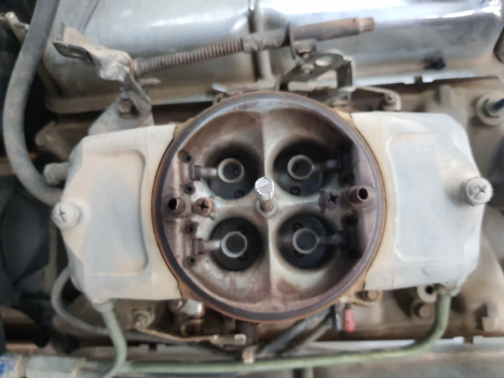

3.1 The car smells of gas, I am sure there is a leak somewhere, and it idles rough at anything under 1500 RPM. It has a Demon carb on it, I have been trying to identify the type of Demon, and the CFM size, the closest I came to is that it is a Mighty Demon, 750 or may even be an 850. After searching and talking to people, I emailed Holley tech support for guidance, But I will post the pics here as well, if anyone can help, it will be much appreciated.​

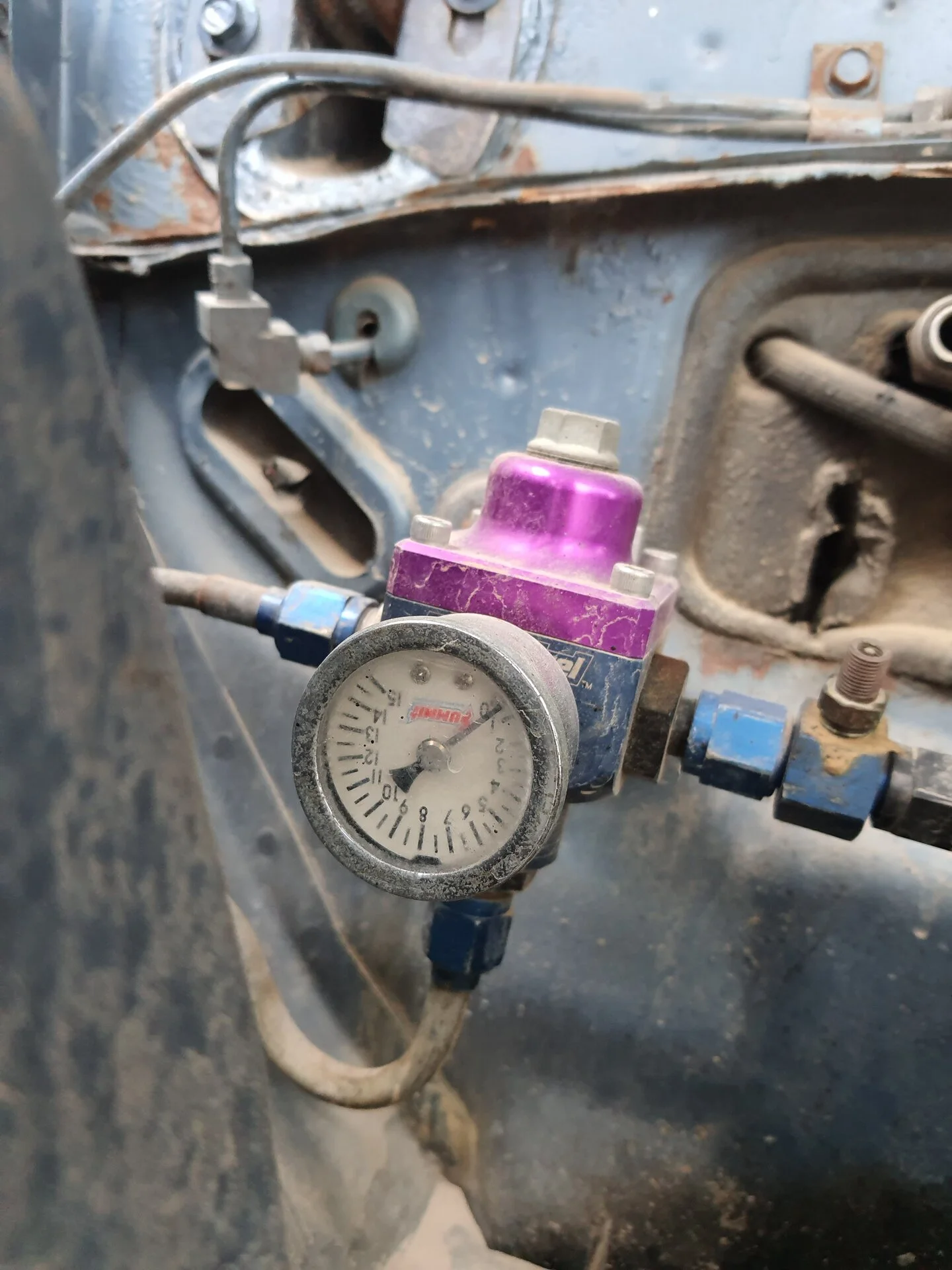

3.2 I also know that the regulator, a MagnaFuel, but not sure about the model, as most of the identification is missing​

1. Carb is a Mighty Demon, 750 CFM
2. Fuel Regulator is a Magnafuel MP-9833, good for 1600+ HP applications @4-12 psi fuel boost

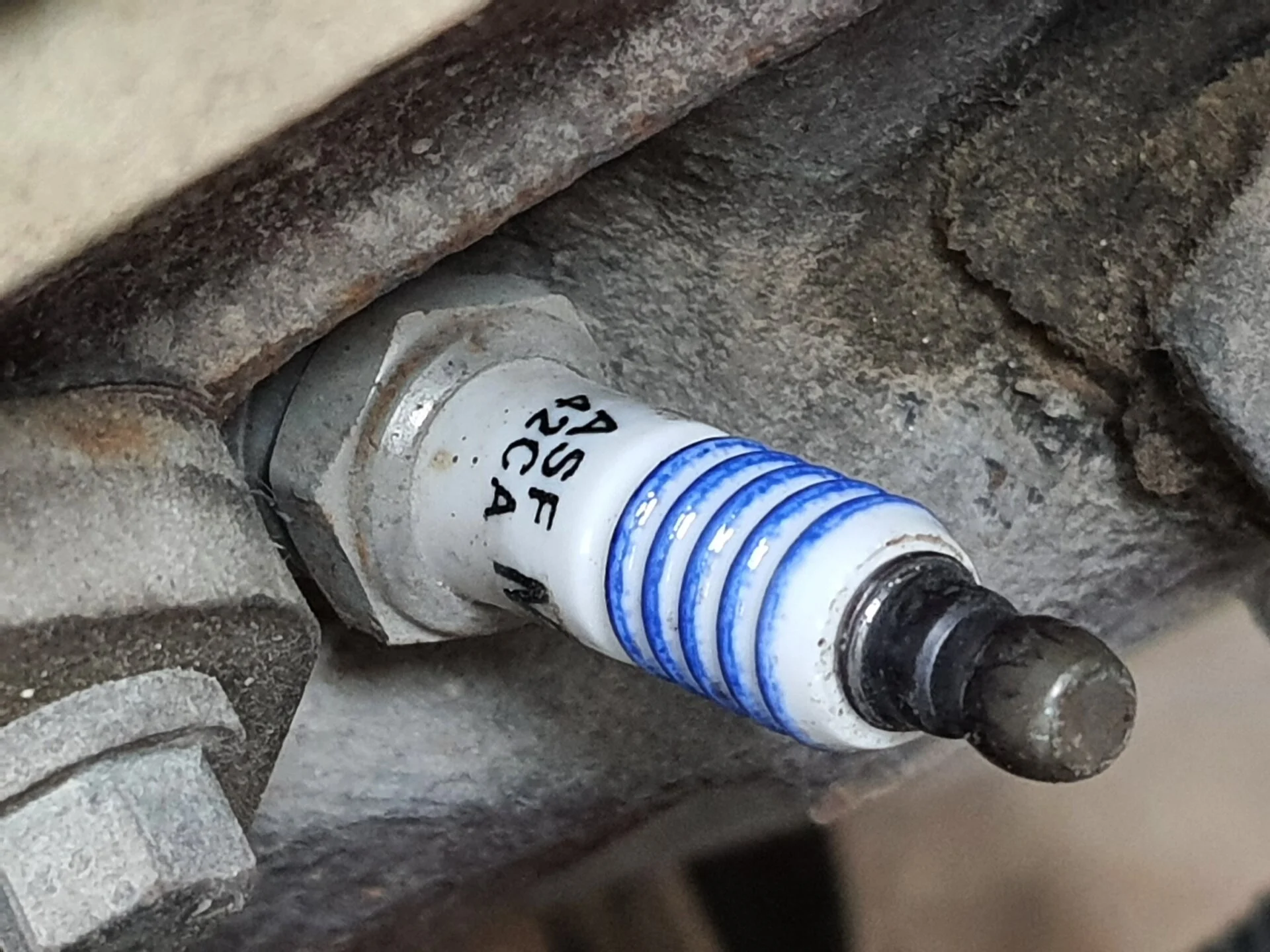

So I am documenting everything on Stoppie, one of the steps naturally is to look at the sparks and I found them to be a run of the mill set, the ASF 42CA set. Should I stick with these moving forward, they are quite cheap
Those are the ones you want. Good ole copper core plugs.
I agree 100%. I have tried to run platinums and other sorts of overpriced fancy plugs in my big blocks, and it did nothing but hurt performance. In most of the cases they would barely idle. Each time the problems were solved by swapping back to the bare-bones copper core Motorcraft spark plugs. I don't recommend anything else but the standard plugs unless you're running extreme boost levels, really high compression, or you have a modern engine with higher swirl/tumble rates.

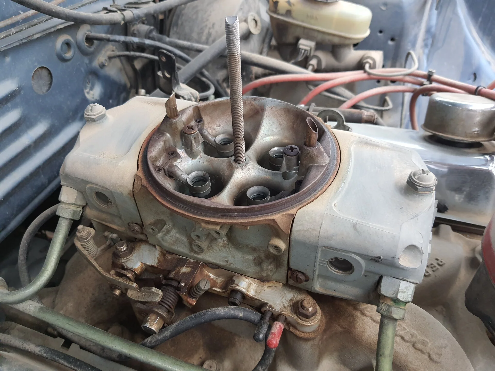

I went for a drive the other day, and I noticed that the car almost dies at WOT, but mid throttle and a little more it goes very well. So I was messing around with the carb, and I noticed that fuel is sprayed only from the rear jets (closer to the firewall), not the front (I am not sure about terminology). Even when I pushed the throttle to WOT and looked at the jets, there is clearly fuel spray from the rear, but not the front. I am guessing the screws are closed shut? a re-build / or renew kit is forth coming now more than ever.

There is an accelerator pump that make the squirters work, the lever hangs out from under the float bowel and a lever pushes on it, you should be able to push on the lever and make the squirters work, if not yank the bowl off and replace the accelerator pump.
Reactions: mansour.aref
An accelerator pump has nothing to do with nothing coming out of the boosters at WOT. On a Holley carb, you can hold the throttle open and look down into the venturies, and watch fuel being pulled into the throttle bores simply by the process of the siphoning effect that is created. If there is no noticeable fuel coming out of the boosters, something is wrong with that circuit, NOT the accelerator pump. The squirters that shoot a shot of gas that are tied to the accelerator pump circuit are between the primary bores. Their purpose is to add fuel when the throttle blades are initially opened to “ cover the bog” that would happen otherwise. Once that car is moving, the boosters help the engine to pull fuel into the engine using engine vacuum after that.
Something is plugged up on the primary booster circuit( the front half) of that carb.
Agreed it has a plugged jet(s) or the wrong venturi gasket if there is no fuel from the front two
However the car would be falling on its face the whole band not just wot

That is a good carb but a lot of carb for a 302-347
It will need small jets depending on your altitude 67-70

Ok, but my understanding was the squirters were not squirting, but Mike is correct about the boosters, which better matches the symptoms he is describing.
And in the light of day I agree with you. It’s the way he was describing his symptoms ( and thinking he was talking about a running engine) that threw me off.
The Accelerator pump “ squirter” or discharge nozzles appear to be what he’s talking about, ( as you have noted) and not the boosters in the throttle bores. It helps me understand stuff when people at least know what to call them,…..that way I don’t just rush out, and offer up a whole bunch of “alternative facts”.
