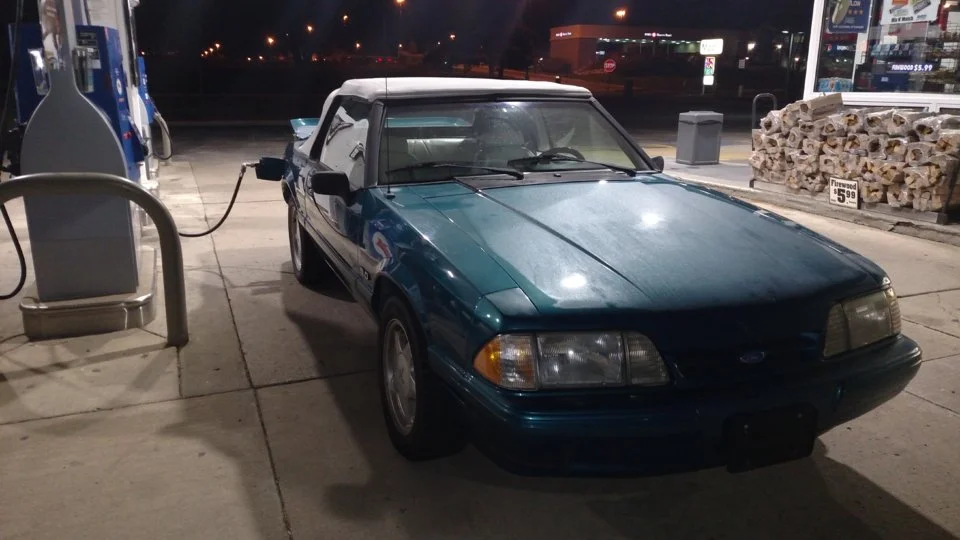

I decided against this one and opted for a unmolested 93
