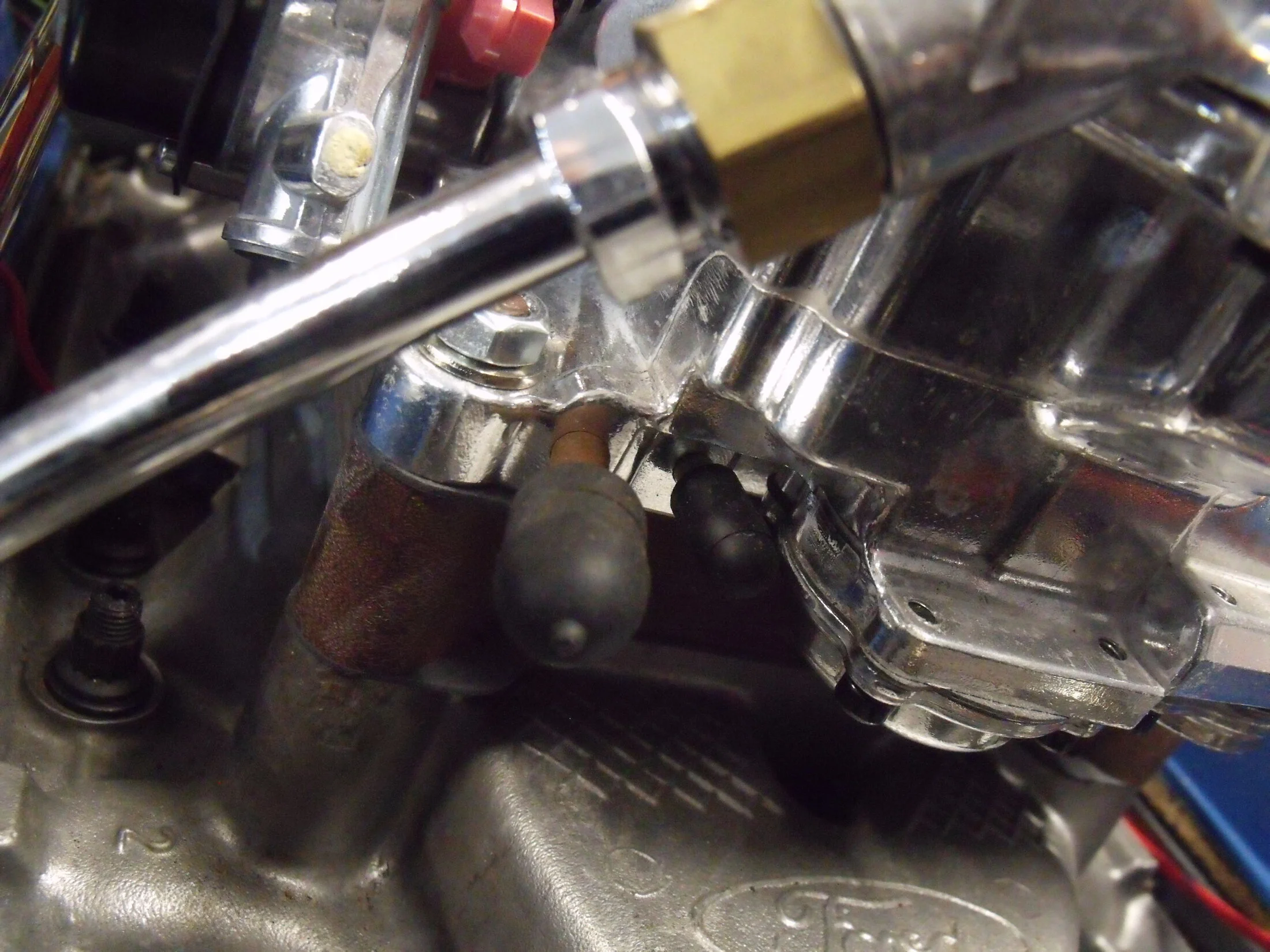

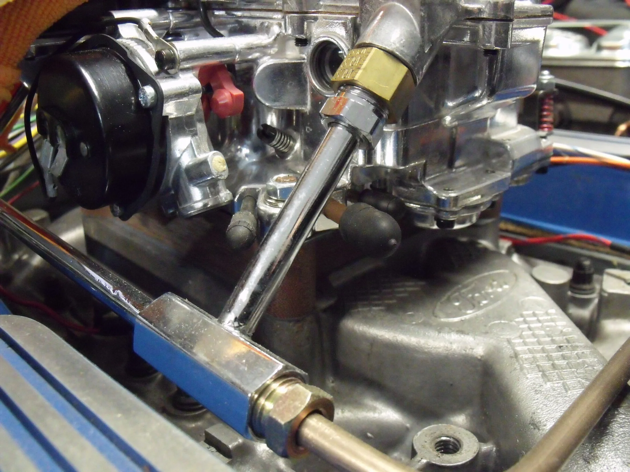

limp said:
Here are 3 vacuum ports on the front of my Carb... Do you have them plugged? Mine are capped with a rubber cap.. The second picture shows the small port/capped to the right of the larger port/capped..... Your carb might be different, but you should have at least 2 ports in this area...
Yeah I have those capped off on my carb...I really wish mine had the sights on the float bowls though.
