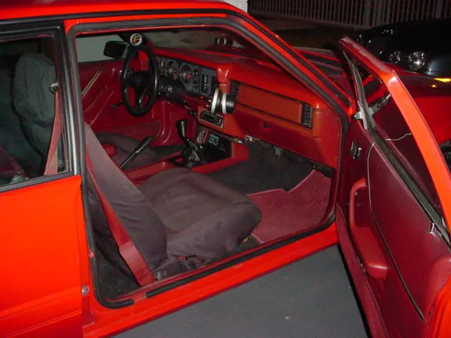

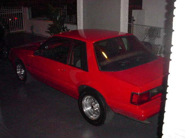

I'm about to redo my exhaust so maybe with a couple of changes to the way it is mounted and my new exhaust it will do the job. Exhaust is always sweet to hear. Here are a couple of pics of my ride.
