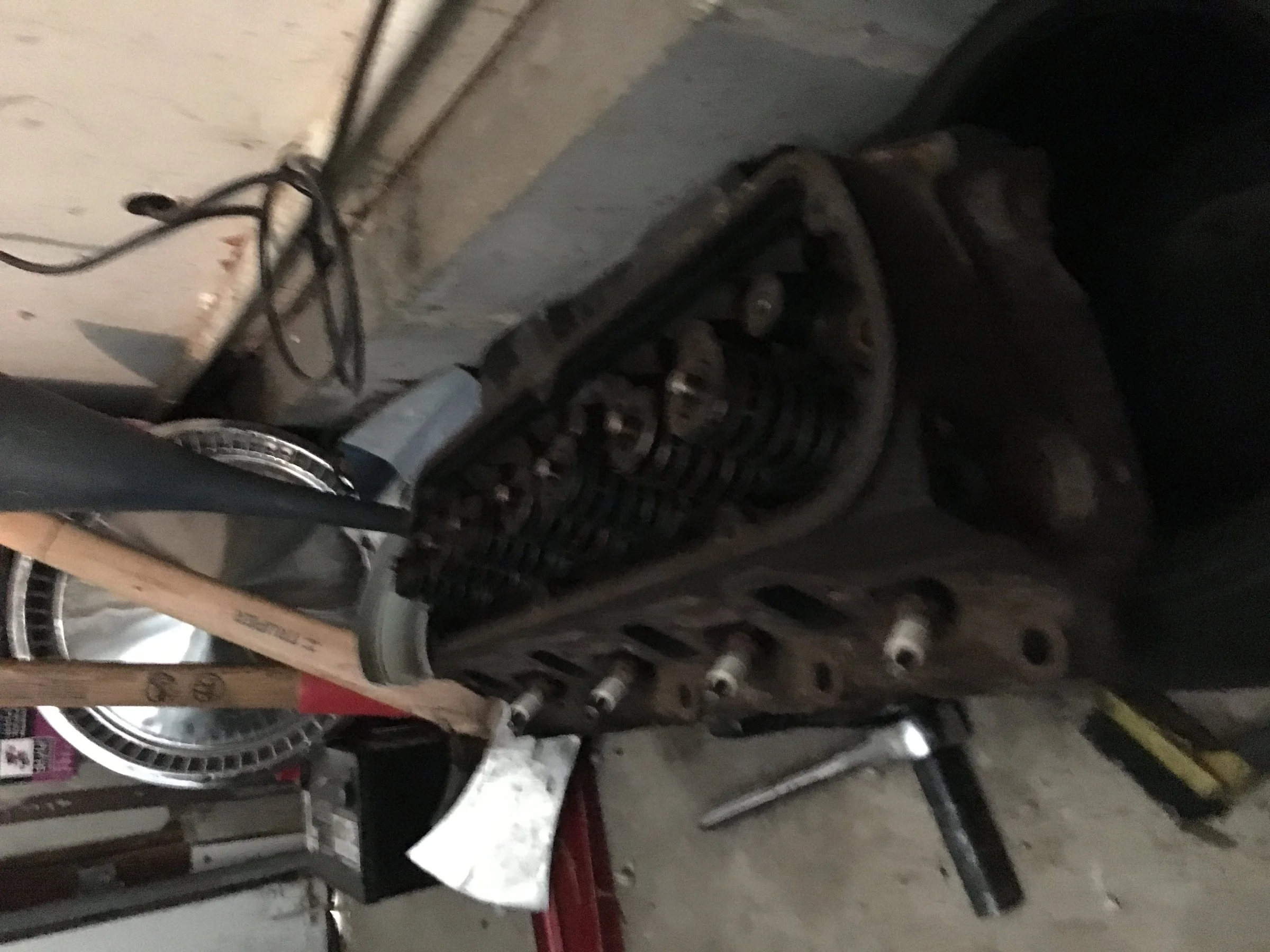

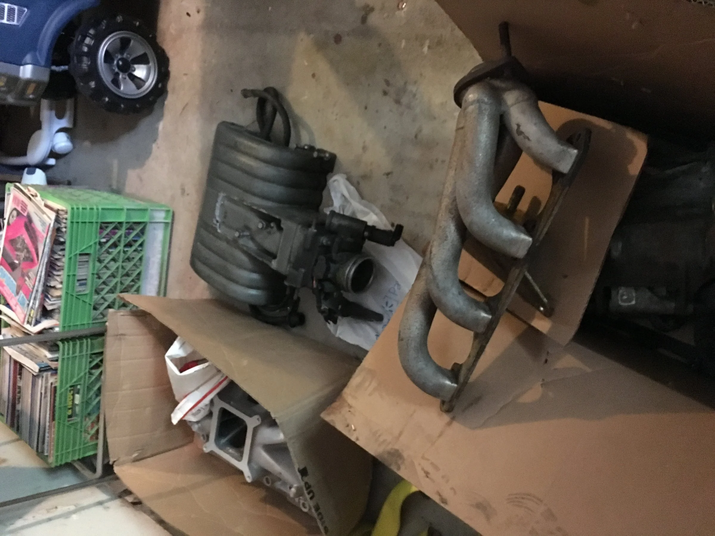

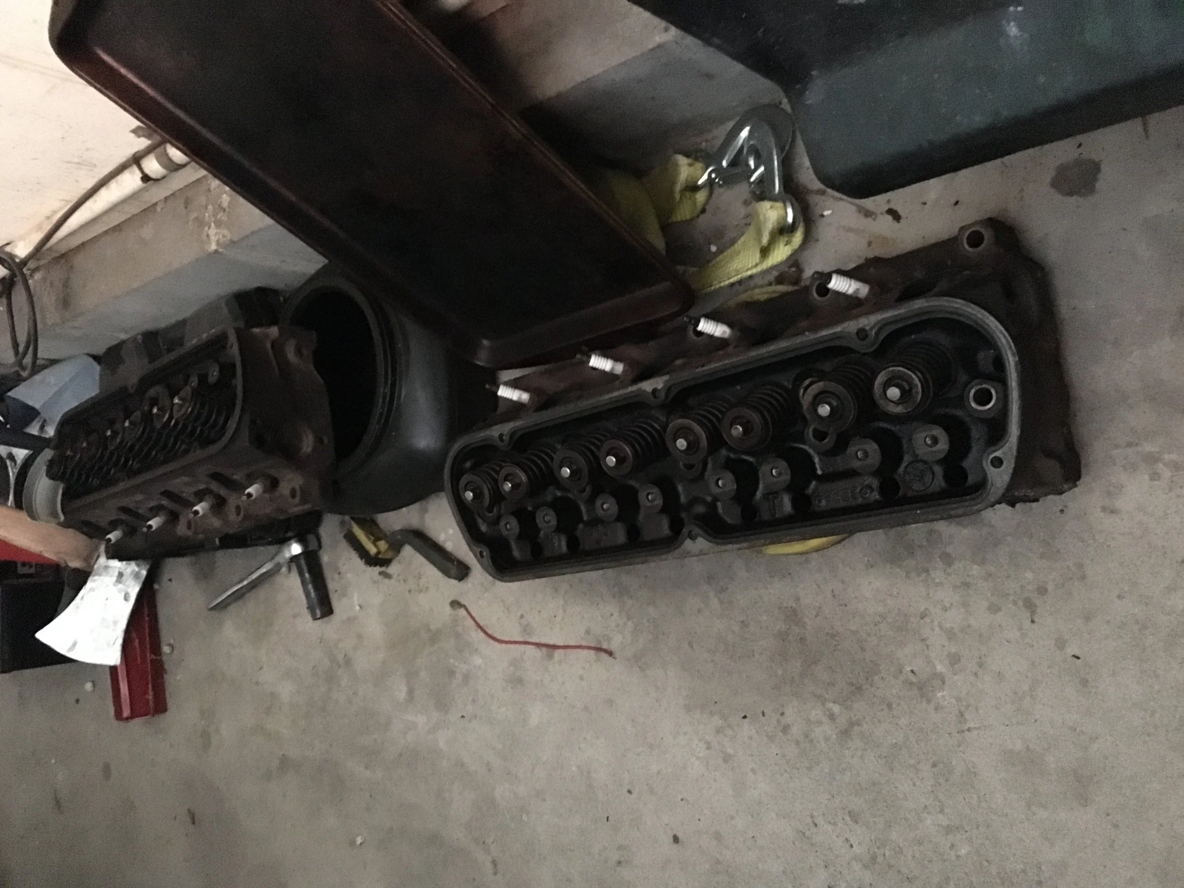

Also I have some parts for sale

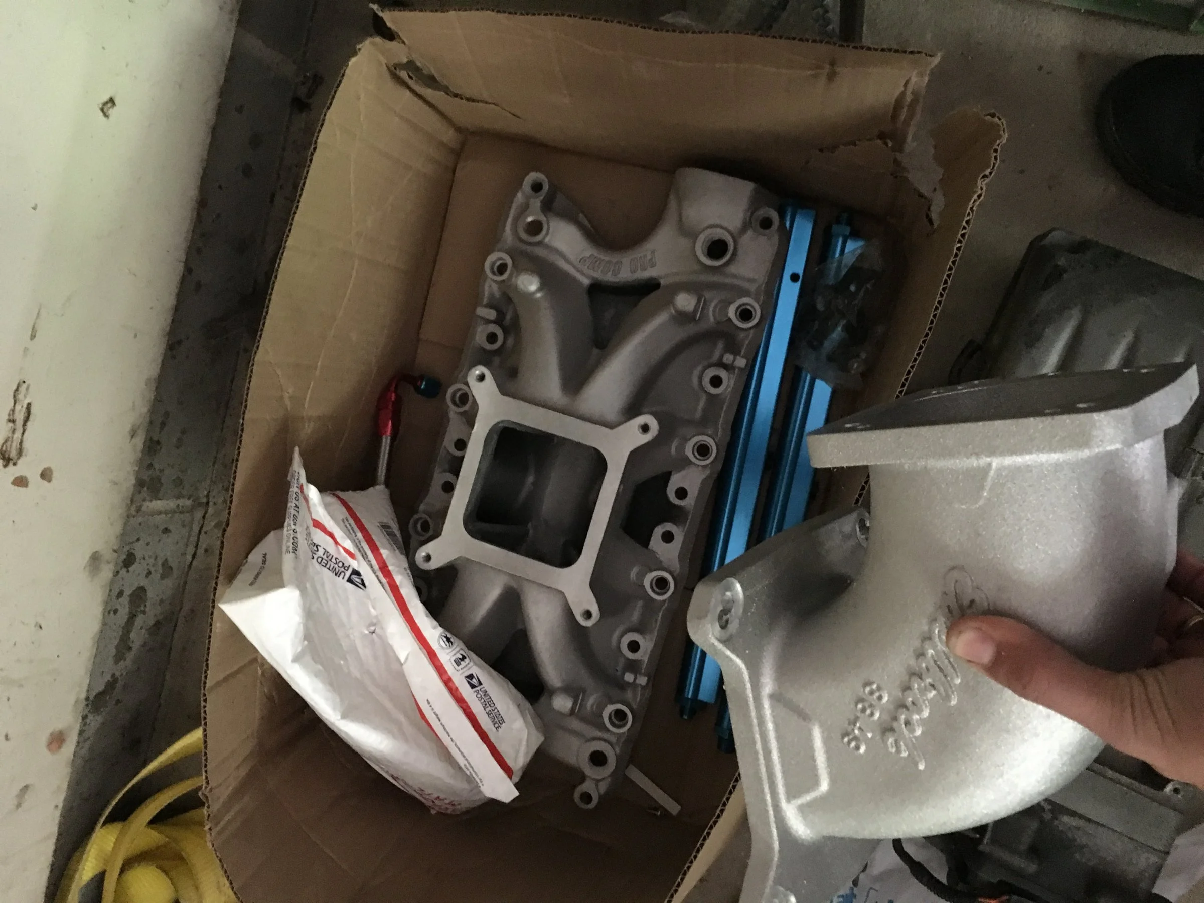

Lol why not run that manifold with the elbow, a 75mm tb and 30lb injectors. A9l ecu, 90mm lightning MAF with a chip to make it work with rhe 30lbers.....
Btw I happen to have all of that in a box. Just sayin.
Lol cuze I didn't know you yesterday and all I have to go on is that this intake is only for super charger setup that what I was told by the seller
So let's start from scratch
I get my engine built
Heads to oil pain
I throw this intake on there
All those parts in your box
And this thing will run
Plug in and go
Ok how much and where are you ?
Heads to oil pain
Plug in and go
First let's get the specs of what you are building, need to be sure the heads,cam,intake all work together. Last thing you want is this thing to run like poo.
For the details on my parts shoot me a PM. You can do that by selecting my profile and starting a conversation with me.
Heads to oil pain
Plug in and go

Will it run? Yes.
However, there is a lot of untapped performance without an intake that is matched to your plan for the car - hot street, street/strip or pure racecar.
Short runner manifolds like the one in your picture are meant for high RPM operation or with pressurized induction. They are not the best choice for an NA street driven car.
