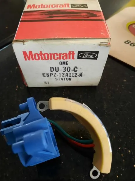

I will be rebuilding my original dist., so, if anyone can provide the part #s for motorcraft PIP, TFI and any other recommended rebuild parts for my original distributor, please chime in.
There's the pickup number.
Reactions: jrichker
The dist is likely ok but the choice of electronics that Cardone uses is junk. You are better off swapping the parts out for Motorcraft parts. Hell, I would trust 20-30 year old oem for parts over the current crop of Chinese electronics for our cars, which is being made by the lowest bidder in a dwindling bidder pool (how many 302 based vehicles are still running to justify companies making Oem replacement parts)
I just installed a cardone remanufactured distributer in along with a motorcraft tfi. It had a ford pick up still in it, they only change what’s bad in a reman unit so I got lucky. My stock distributer was wobbly as hell and it’s much easier to buy a reman then rebuilt it
you’re not going to find a motorcraft pick up, only cheap Chinese replacements. A “new” distributer will have all new Chinese stuff in it most likely and probably a wrong shutter wheel

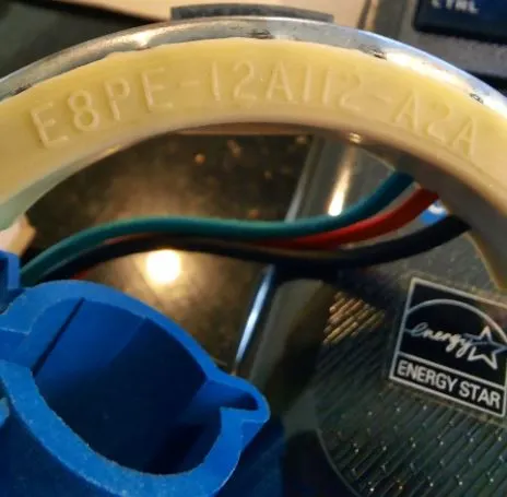

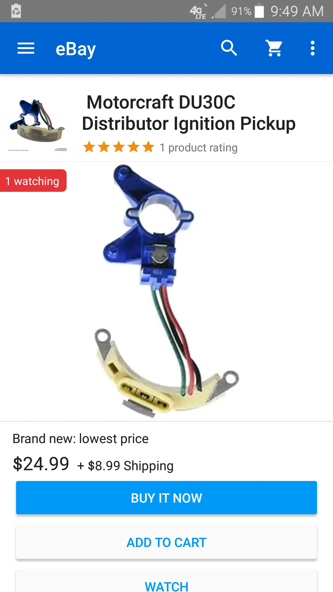

I posted the Motorcraft pickup number and even a picture on the 14th. I see some doubted my post. So today is the 28th. I just ordered the Motorcraft DU30C pickup 2 days ago. Supposed to be here first of the week. I'll post a pic of it when it's here. ;)
Don't give up!
Reactions: Mclay and 90sickfox
