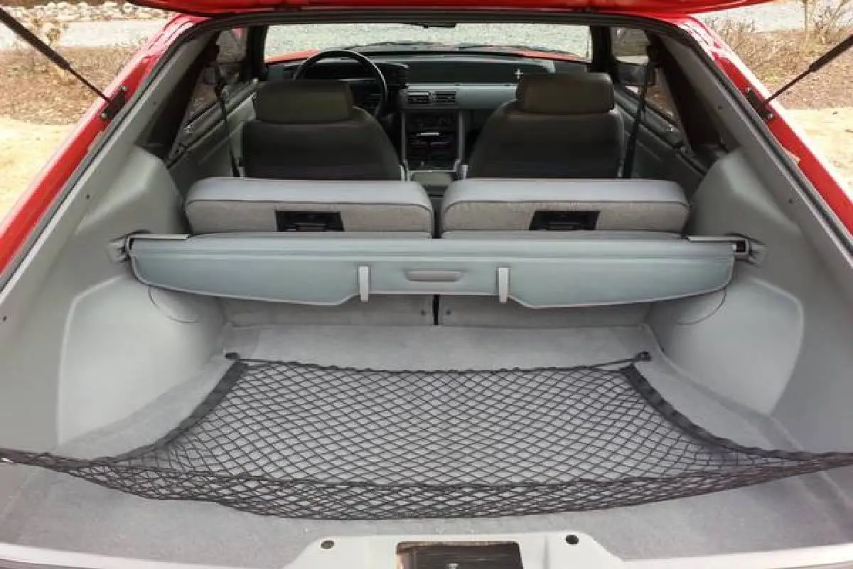

Anyone have a factory cargo net in their hatch?
I've been wanting to add one and can't figure out these hooks. I think the two on the sides screw in in place of the screws, but what about the two hooks in the carpet?

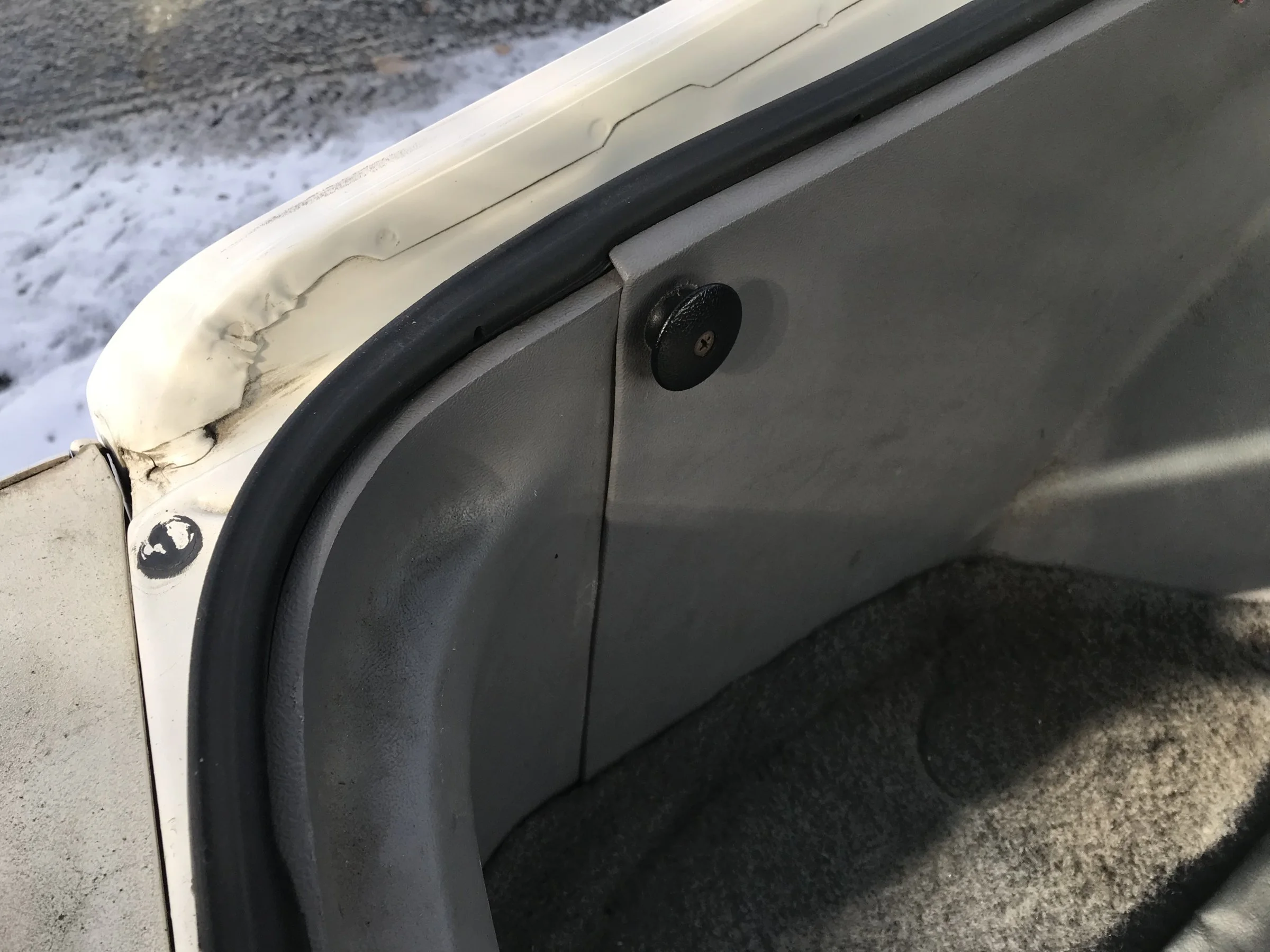

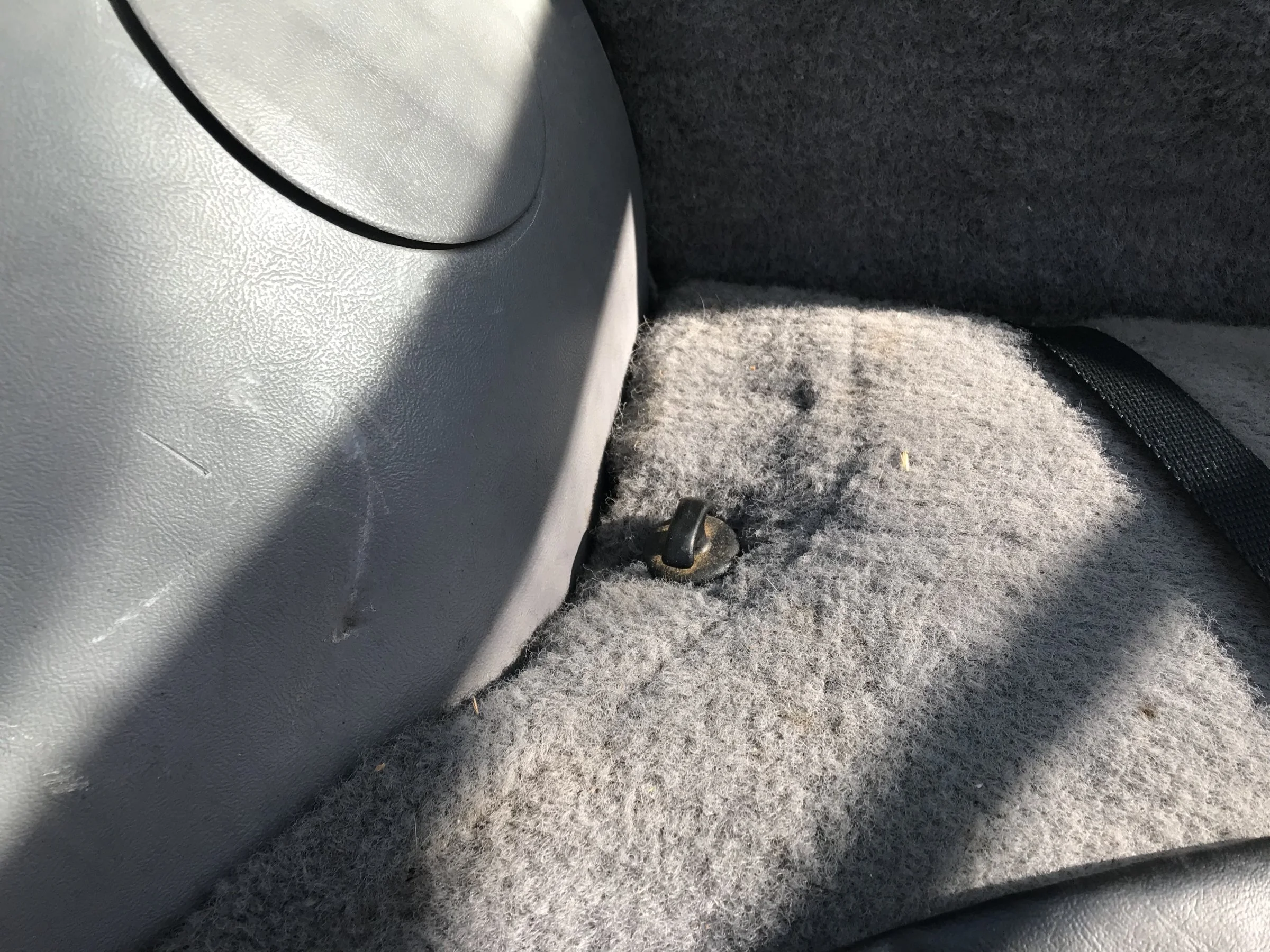

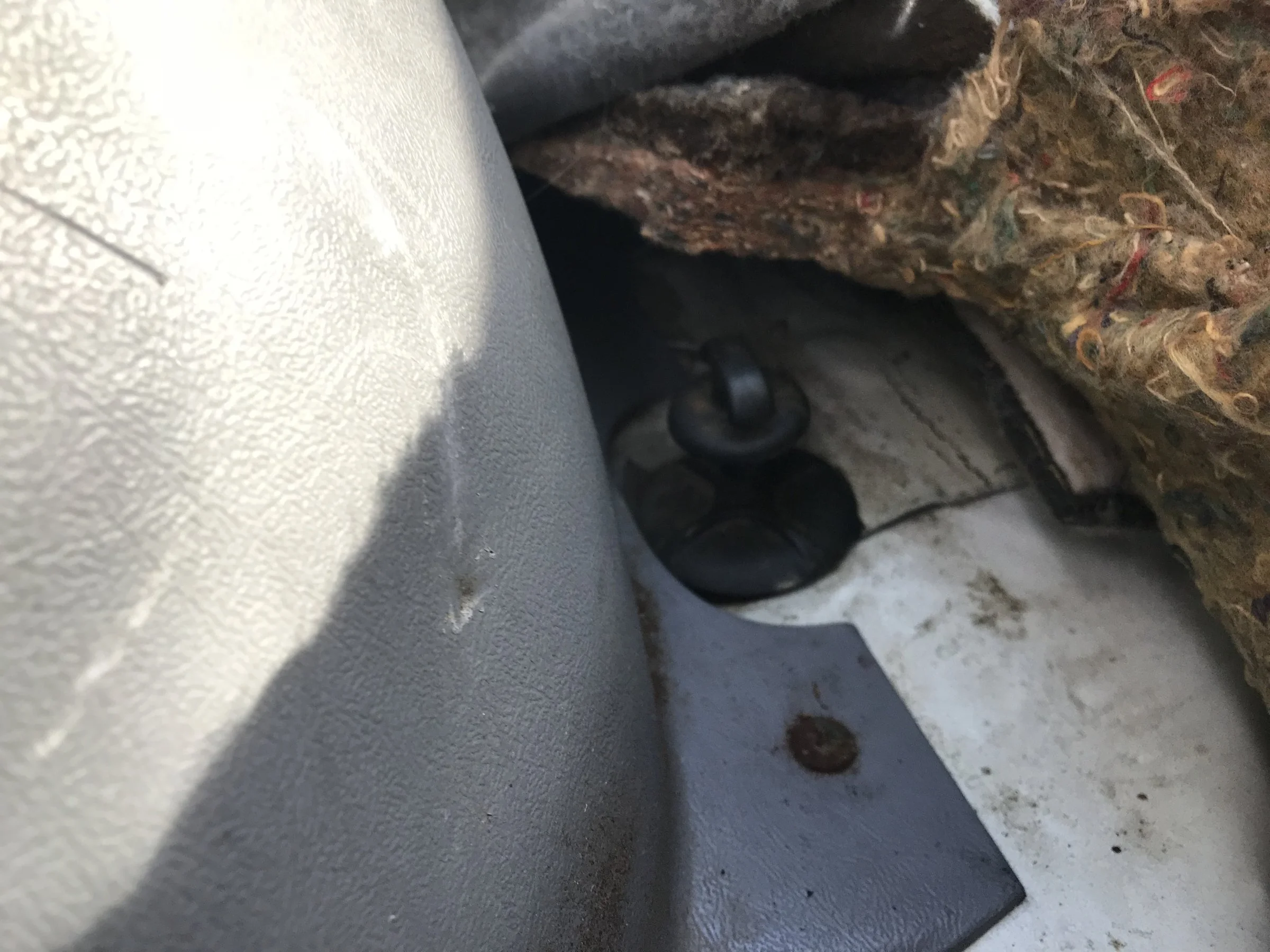

I have the original net, unfortunately the car is in storage and I won't see it until spring. All four net mounts are the same, two thread into the trunk floor behind the rear seat, two into the plastic area that is the back side of the tail light area. Just like your pic shows. I only have one pic but it doesn't show anything.

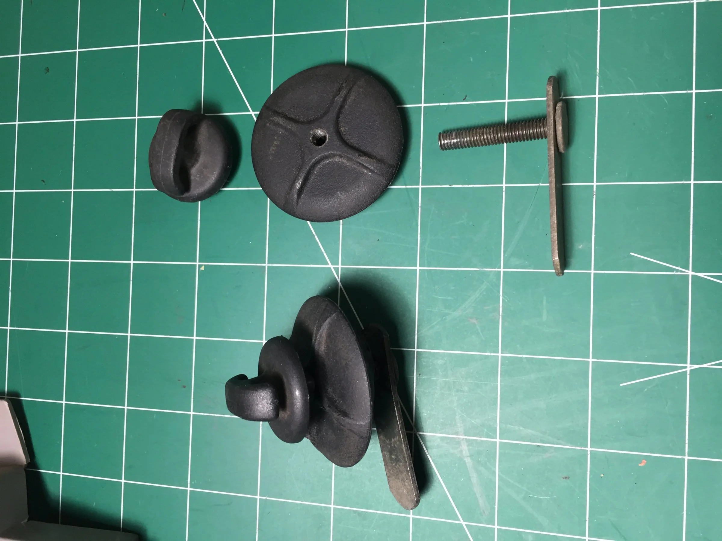

So these are what I have for the hatch carpet. Can anyone with the net in a hatch explain how these install?
Is it just a 1/4" hole though the carpet and tighten up? Does the cebter disk go above or below the carpet?

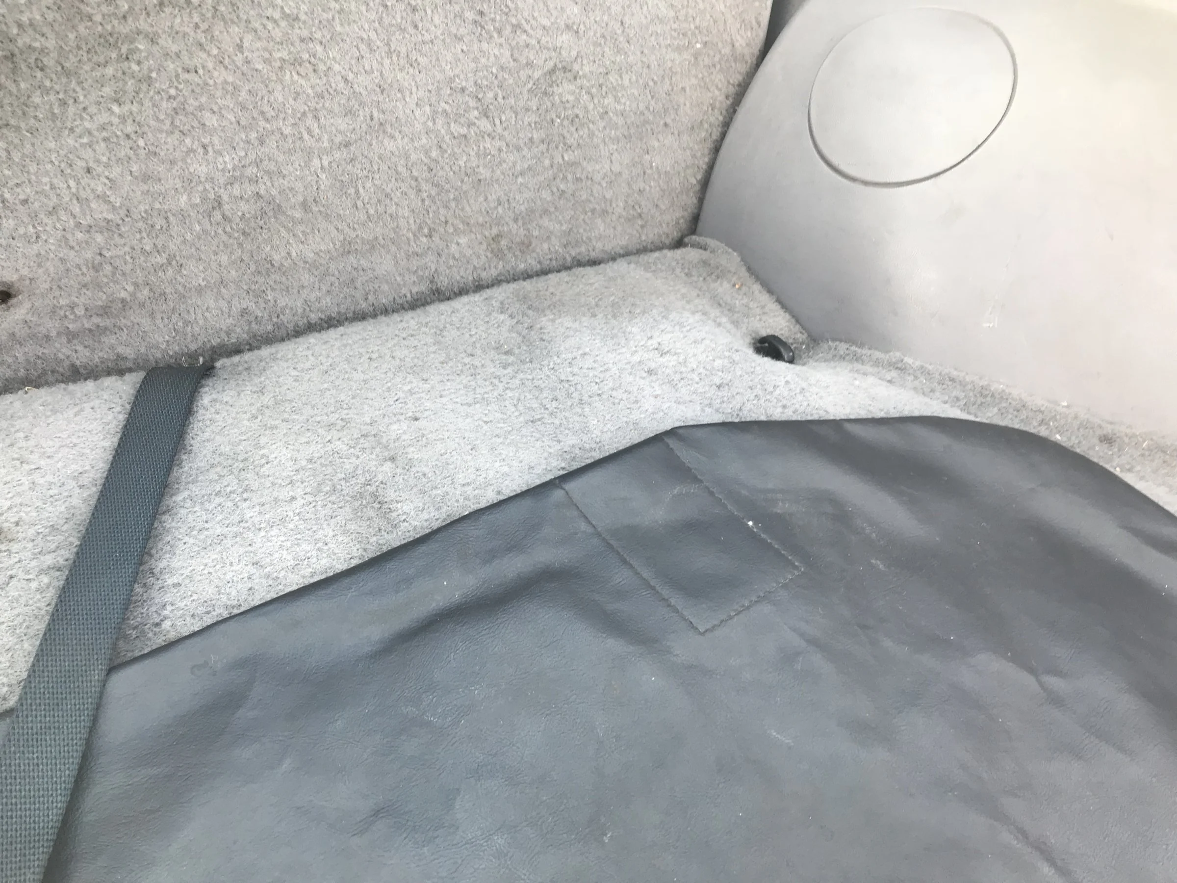

My carpet is over the large disc and under the hook part. Not saying that is correct just because there’s no telling what the P.O. did back there. Also the slits in my carpet are cut in a way that allows complete carpet removal without messing with the hooks at all. I was probably no help at all to you. Lol

I have just circular beveled posts mounted to the hatch panels toward the rear of each quarter. The hooks are on the floor up close to the backs of the rear seats.
Than you. That definitely helps.

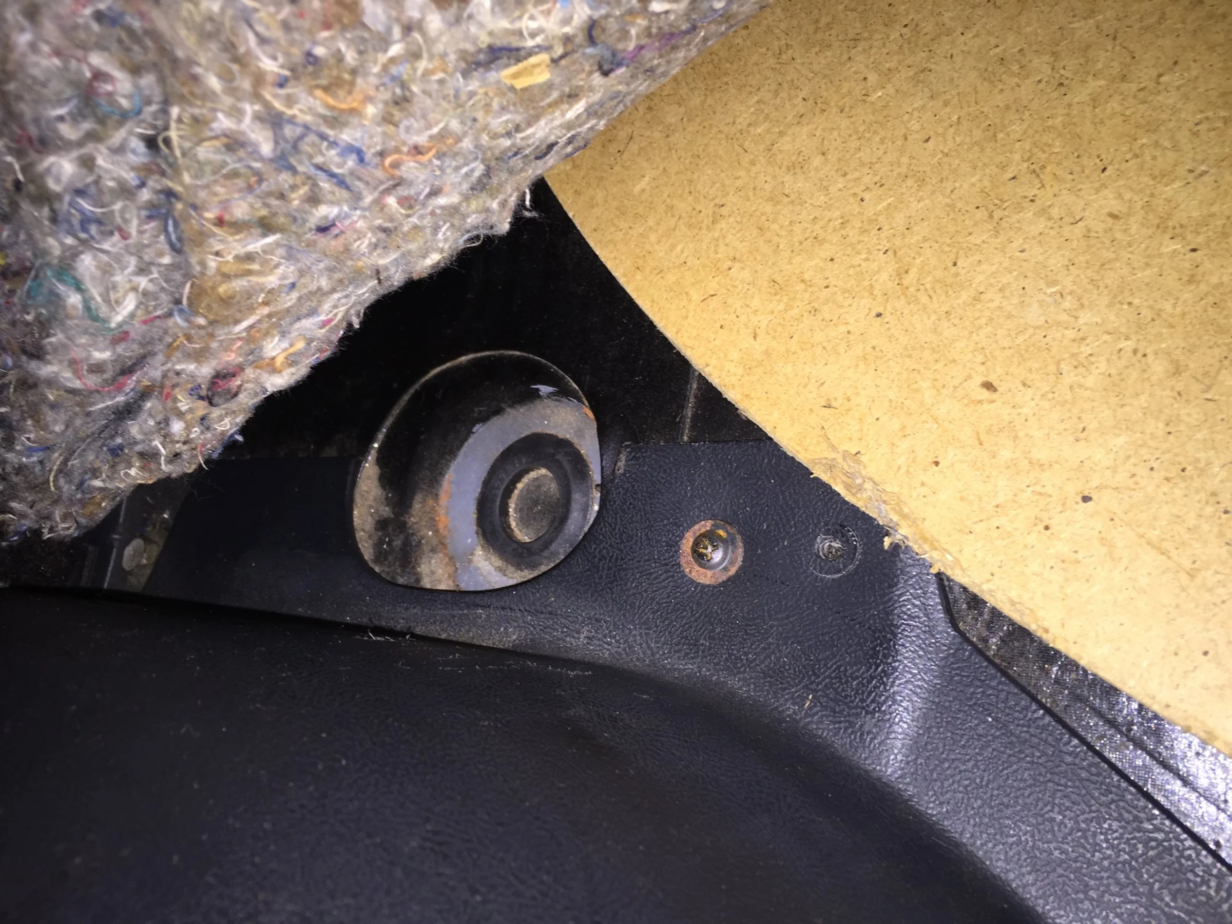

So now i see how the floor mounted holders attach. What secures that "foot" to the bottom floor of the hatch? Is it a hole drilled through the underside of the hatch floor?
Light dawns on Marblehead. I was wondering why the bottom of the plug had a rubber seal.
The fox has two rubber grommets on each side. When Ford added the cargo net option, they designed the hangar to slip into existing sheet metal features. No tooling change needed.
