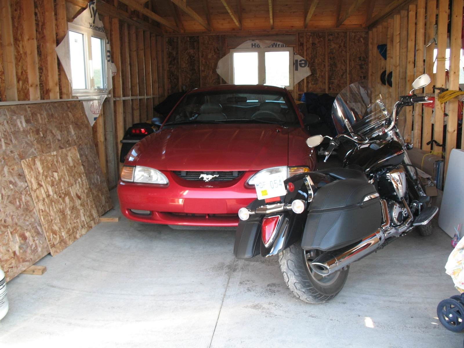

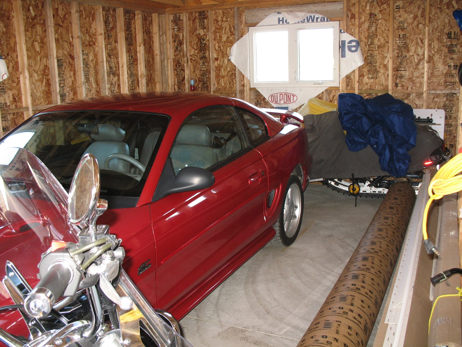

Anyway, below are a few not so good pics of her in her resting place for the last 10 years.

That Stang is in awesome condition. The mirrors look brand new. Mine are all faded. I am very jealous! Sweeet ride ;)

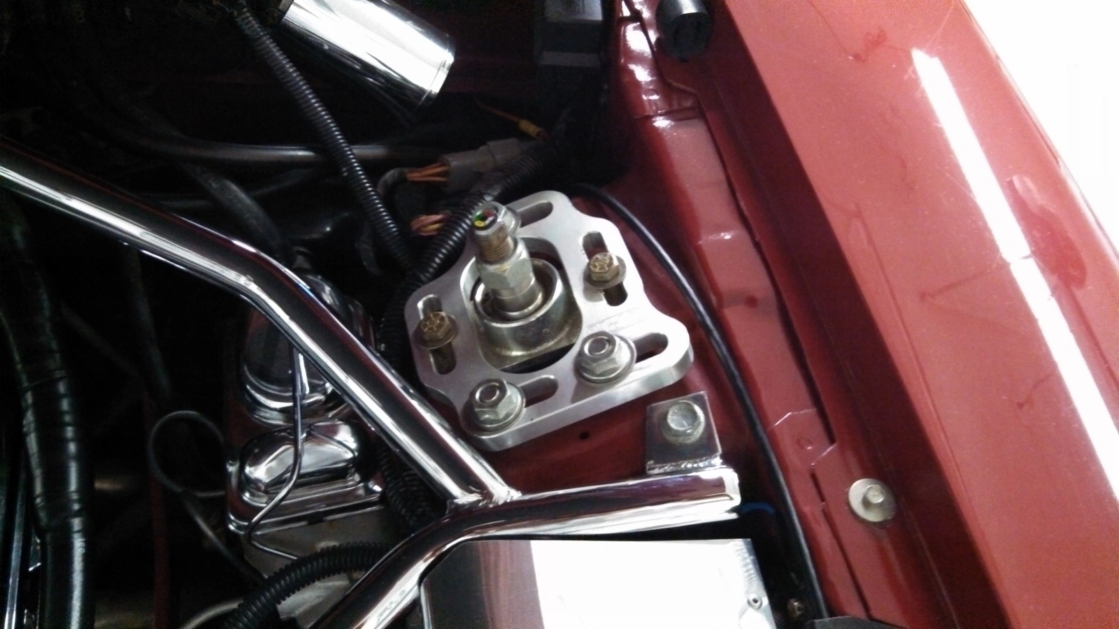

Good call. I am not sure if it is the norm, but I was told to go full positive caster when I did my '90. And I gotta say it handled like a little go-cart. It may wear the tires a little more, but it sure made it fun to drive. When you turn, the wheels lean into the corner a little more, giving you a tad more bite in hard cornering.
Someone needs to design a fine adjustment screw on their CC plates so after you get the initial caster set you can fine tune it on the fly.
Now you made me pull out my alignment sheets. Putting the plates at the full forward setting gave me 4.0 degrees of positive caster on one side, and 3.87 degrees of positive caster on the other side.
Kurt
Ok, but even with the plates in the full forward position, the Caster is still positive. Look at your struts next time you have your wheels off. They are still pointing towards the back of the car.
Kurt
You mean full back?
Positioning the struts forward in the plates is negative caster.
Backwards is positive. You want full positive caster so the struts should be slid all the way back.
Kurt
The plates don't slide forward and aft. The strut does.
