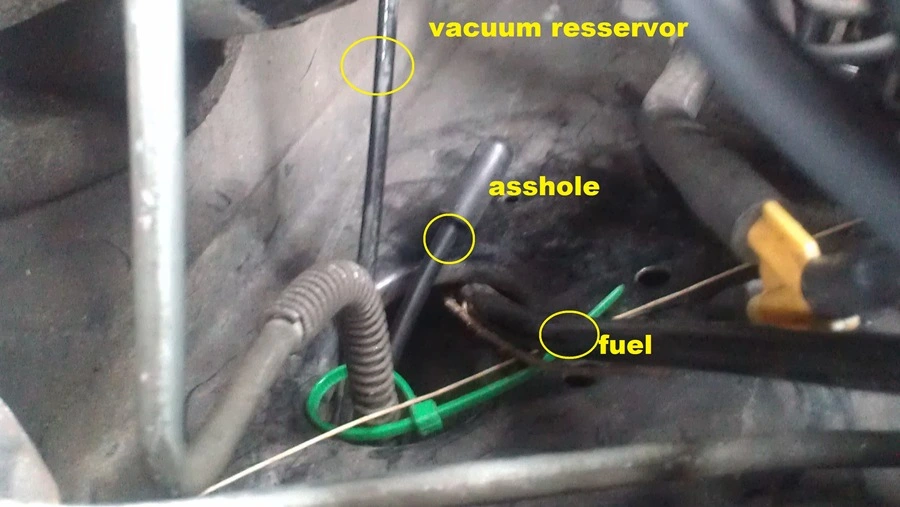

alright, so everything "appears" to be hooked up the way it should be there is one last hiccup i checked the charcoal canister and my fuel evap is there is was unhooked but it is there and i fixed it. so the 3rd black broken line is still a mystery... or its actually the resservor line and the non broken line is a mystery... pic E btw thanks i really appreciate all the help

There shouldn't be a fuel line in pic E

So there's 3 lines coming out of the fenderwell? Only thing I can say is to remove the plastic inner fender lining and see what you've got. On my 87, out of the inner fender, there was 1 fuel tank vent line going to the charcoal can, and a single vac line going to the vac resevoir.

Small update I haven't had a chance to open the fender well to see what that 3rd black line is but I will get to it eventually. Although I was checking my spark wires yesterday and i noticed under my air diverter the hose was cracked really bad and it wasn't heat wrapped and the damn thing is so old I tried to pull off the hose and broke off the bottom half of the diverter...
