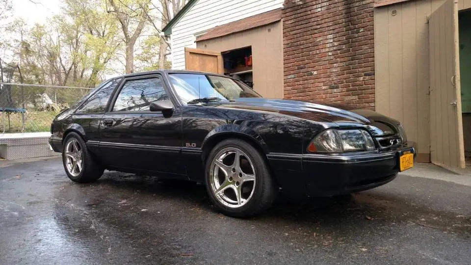

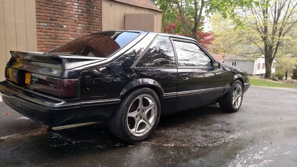

I didnt roll anything eibach sport lines with upper isos on front only i do have new shocks and stuts havent put cc plates yet but not to bad neg camber as it sits now tho No rubbing also it has 275 40 17 and 245 45 17 front tire almost identical size as the 245 50 16 old ponys it use to have

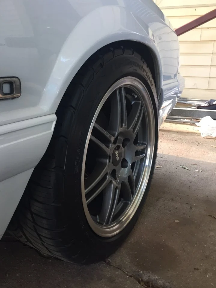

Hmm interesting. Mine rub and I have a lot of negative camber. The struts look newer but maybe they are shot
The insides of my front tires are wearing very fast.
Yeah cc plates def will do the trick not sure i think the ofset on my wheels may be a bit diff from urs to i swear all mustangs are built a bit diff lol do they rub the fender are control arm?

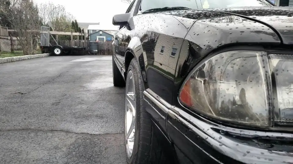

Love the smoked headlights to nice on black
Thanks. Going to eventually build a set of Retrofit projectors and make the shrouds and buckets black but that's down the road...
