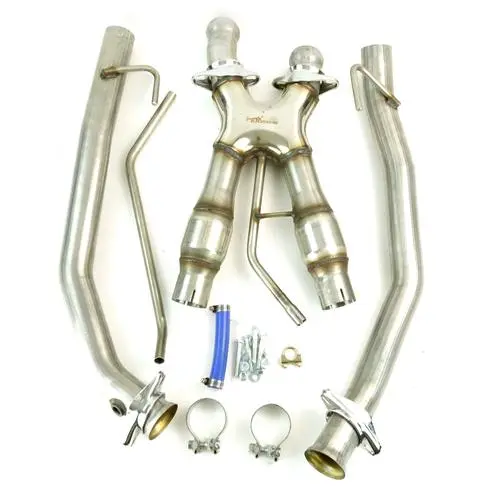

The best kit (and not sure if it exists for a fox, but it does for other mustangs) is the bassani kit that comes with the X pipe, tubes from header, 2 cats and 2 tubes to replace the cats.
It's extremely adjustable and should the cats fail, they are easy to pull out and swap in new ones.
I don't love the idea of welding them into stainless, since it's not a type of welding everyone has the capacity to do.
If you like the rest of the exhaust, here is another option.
