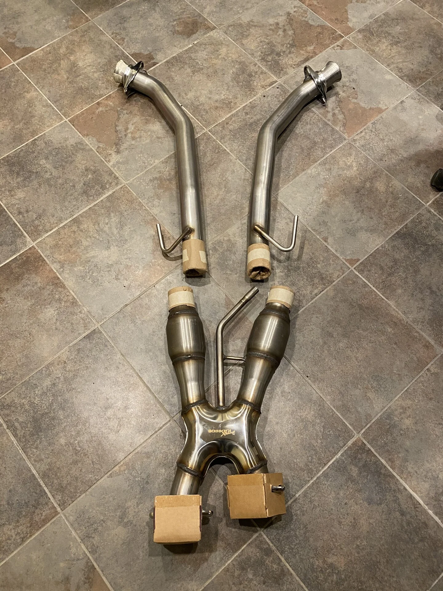

I have the Bassani catted X-pipe on my ‘86. It’s stainless, light, fits very well, and no smell. The only downside to me is that it’s louder than the stock 4-cat H-pipe.

I ended up going with the Bassani X-pipe with cats. The pictures that @Mustang5L5 posted were just too good, that looks like a really nice quality part. Even though I prefer the sound of an H-pipe, I wanted to go stainless from the beginning for long term durability. This will be my first X-pipe adventure on a personal car.

I bought the Bassani SS catted X-pipe to replace the stock H-pipe on my '86. It's definitely a quality piece, installation was easy and it fit well. If anything, it's a bit noisier than the H-pipe, and like Mustang5L5, I'm looking to quiet my exhaust system down a bit.
