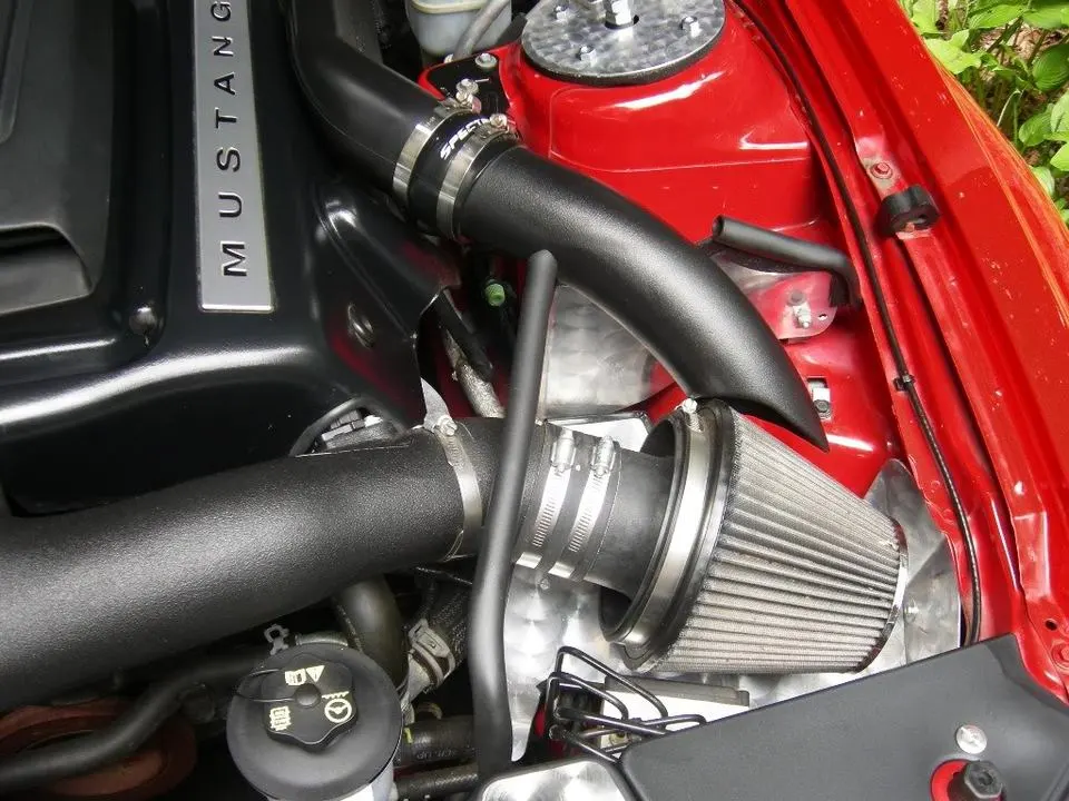

I have the shaker but no CAI yet. Here is a pic with a CAI, you just have to trim the CDC shaker to make it fit, no big deal.

Thanks. That was exactly what I needed to see and know.

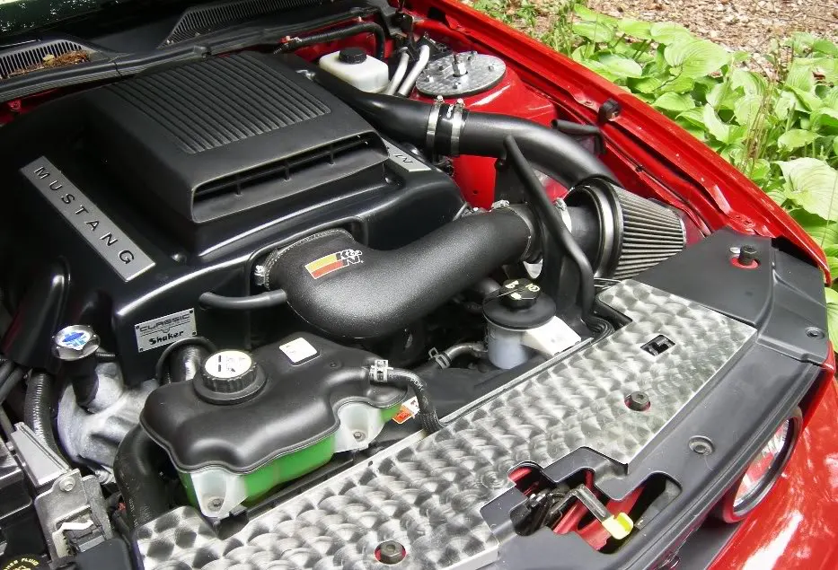

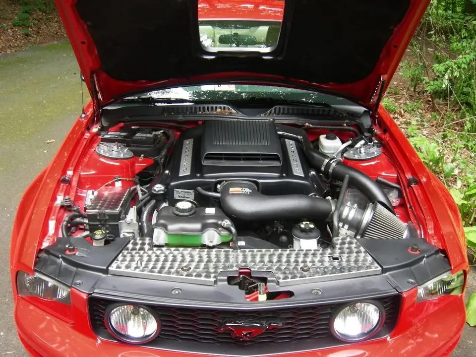

I realize this is an older thread that I stumbled onto (01-24-09), but if you still intend on installing a CDC Shaker with an aftermarket CAI this how I solved the problem with my K&N CAI system. I made a new air box out of aluminum sheet metal and fabricated a new air tube from the stock Shaker to my new air box. I would guess that in many CAI systems the aftermarket air box can be adopted.
EDIT:
One more thing, the front of the Shaker shroud usually needs a little trimming to fit over an aftermarket CAI at the Throttle Body. It is easy to trim with a jig saw, dremmel , or similar tool.
Did you ever install the shaker? Got pics?
