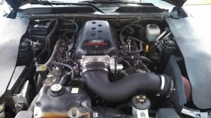

So I finally got the ford racing intake installed. Looks absolutely sick. Didnt get to have much fun after the install raining like crazy. But I uploaded the new bama tune fired right up. Drove for about an hour and half parked it. Got back in drove for another hour and half and got code p0430 something with cats and bank 2. I have kooks longtubes with catted x pipe. Im wondering if bama forgot to adjust something im the new tune. Any suggestion guys? Thanks for the help.

First, check for exhaust leaks. Second, I can't remember if the connectors are specific to each bank, but swap the downstream O2 sensors if possible. If the code changes to reflect a bad sensor in bank 1, your problem is simply a bad O2 sensor. If it remain in bank 2, it's a poorly performing catalytic converter. Also, check the terminals in the connectors for corrosion, moisture and debris. You can check with the tuner, but if it was a problem with the tune it would affect both exhaust banks.
Interesting ill check that out if the rain lets up. But car seems to drive fine only thing I noticed was start up after going to a movie tonight. Car started up idled for a second went down to 1000 rpm back to 2000 rpm then settled around 1500 and sounded fine. Other then that drove fine.
I called bama and was talking about the issue and he looked into the tunes I had wrote. They didnt turn off the rear o2 sensor. He said thats prolly the reason behind the light. I have new tunes on the way. Will see if this fixes it?
