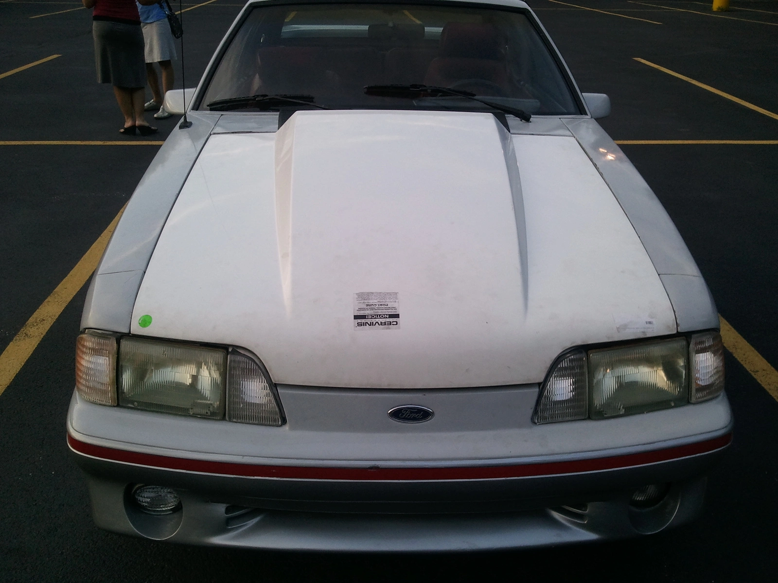

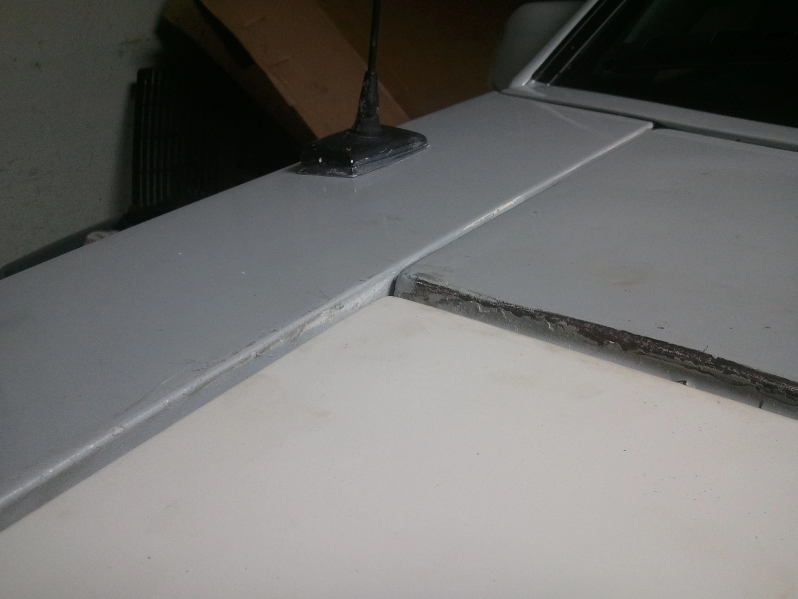

Here is a picture of what I'm talking about. See how low the hood is in the back? I heard cervinis was good because of the fit. The hinges are adjusted all the way up. Am I missing something? I've bee researching and haven't found any posts where someone had to shim the hood hinges to get it lined up.
One thing, I'm pretty sure the owner before me hood flew open because it had to cowl vent and the cowl was really bent up. I had it smoothed out but do you think that's affecting how the rear of the hood lays?

1. of the entire front end and hood

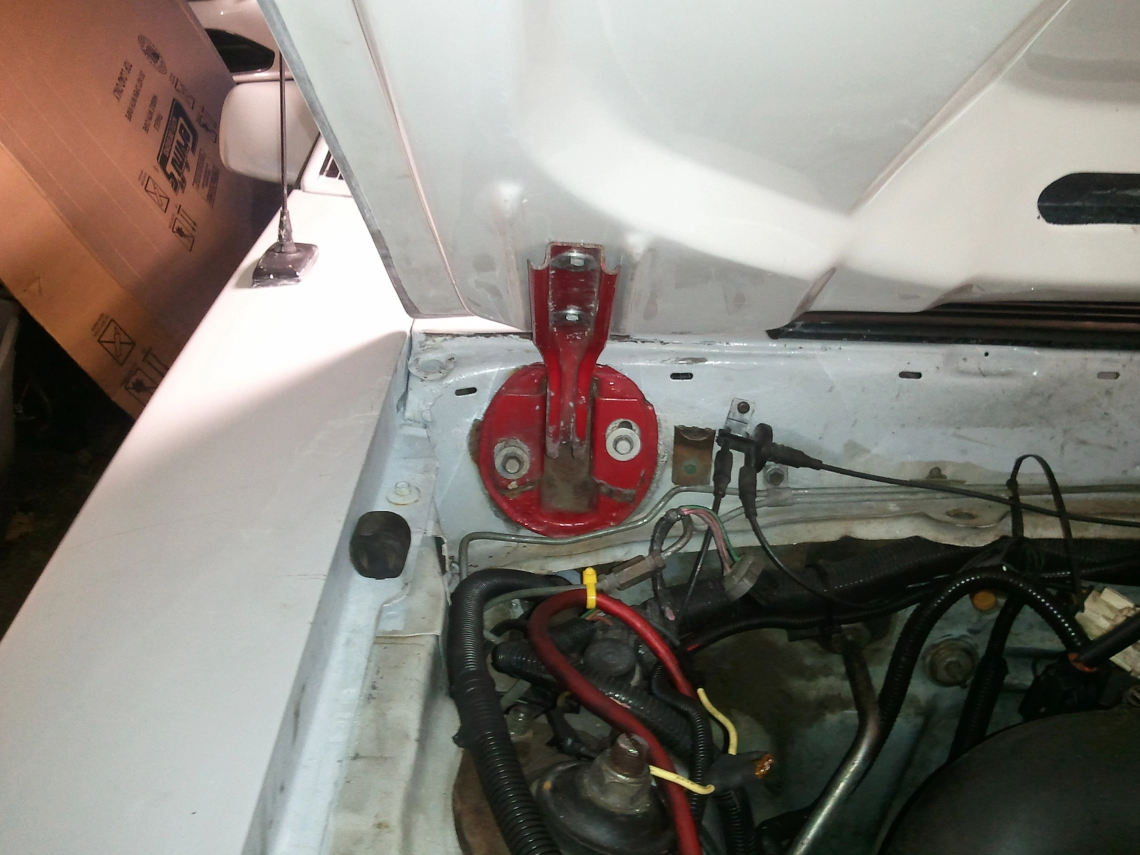

2. Underneath shot with the hood up at the hinges where it attaches to the hood
I've had several Cervini hoods and none of them looked like that. They bolt right in and with minimal adjustments fit nice. Look at my sig pic. That is a used Cervini hood. I simply bolted it right on and adjusted the hinges.
Are the hinges all bent out of shape?

I can get some more pics. I've been playing with it and it is looking better except for the back passenger side corner sitting low. I have all the rubber bumpers along the sides where the hood rests and I just ordered a new hood to firewalk seal to see if that helps. It also latches much better because I elongated the holes on the latch mounting bracket. I got my hinges from a junk yard car but I think they are in decent shape. I may need to elongate those holes to lift the hood in the rest more. Thanks!
