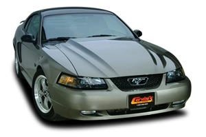

This is the hood that should be delivered today. I guess having the top of the fenders blended is not so bad since I have a scratch on one of them.
So it just bolted up? I keep asking because my luck is that something stupid is going to happen and it won't fit. :)

Well I got the hood today and I had to run home to see it. I opened the box to take a look and you guys are right, the finish looks excellent. I can't wait to throw it on this afternoon. I'll take some pics and post'em.

Hey guys, well I put it on and it fits great. I am really impressed with the quality of the hood and I think it's going to look great when it's painted.
The only issue is that the hood does not latch down. I guess I need to adjust the latch mechanism by lowering it, is this correct? Should I use Locktite on the bolts of the hood that go into the hood inserts?
I will post some pics when I get home.

Here's a pic for the heck of it. :)

Here are a few shots.
Just throwing in my $.02. If you have a prof. bodyshop do the work, they are going to blend the fenders in to warranty the paint match. However if you can get someone to do it on the side, I can vouch for saying that this color is pretty easy to match and that no blending is needed. I did a 2000 Cobra R hood from Cervini's (which is top notch I might add) this color on an 01 Cobra and it matched perfectly. You couldn't tell that it had ever been changed, I just wish I had a picture of it on the car. The only one I have is of the hood by itself.
