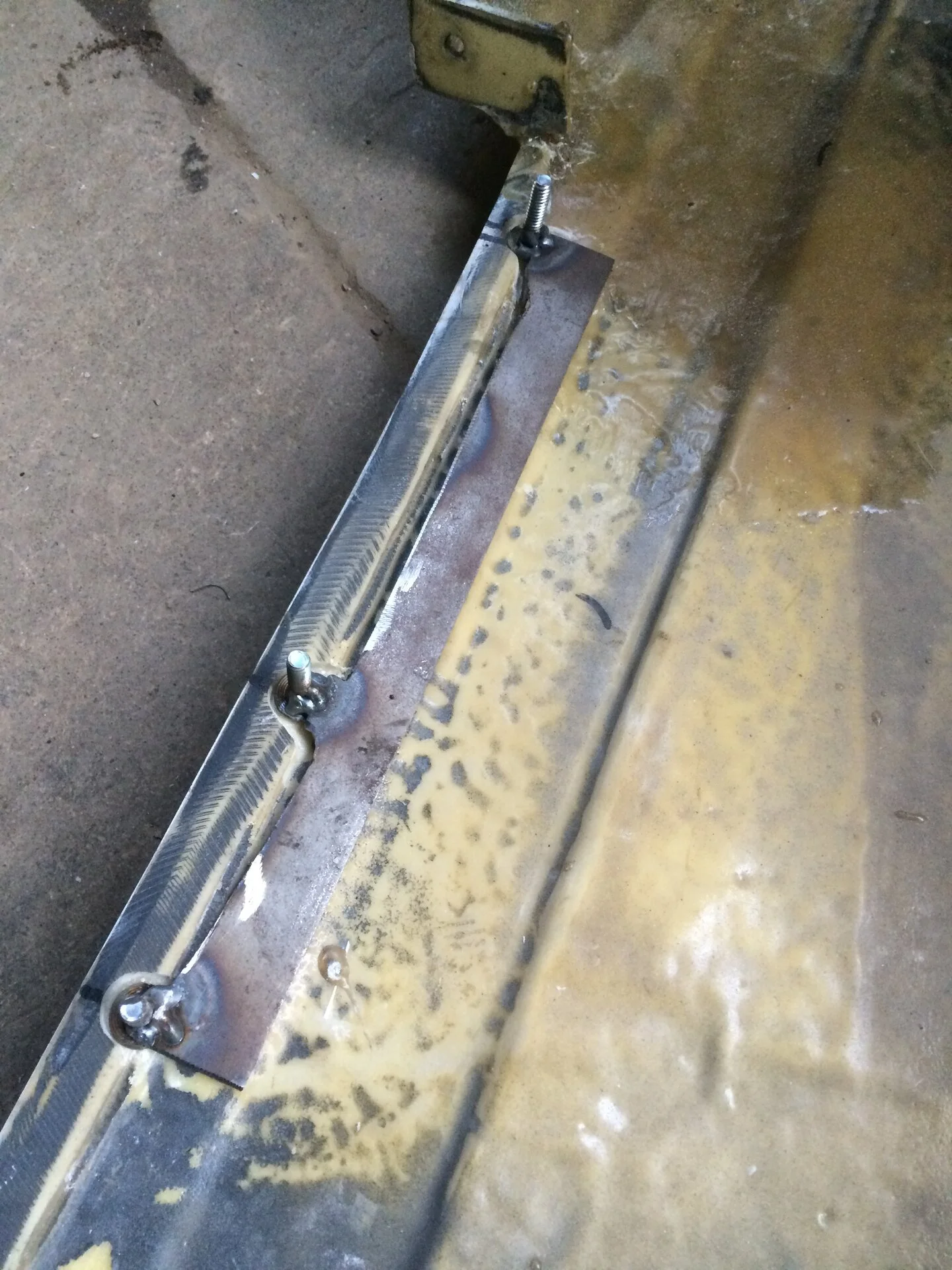

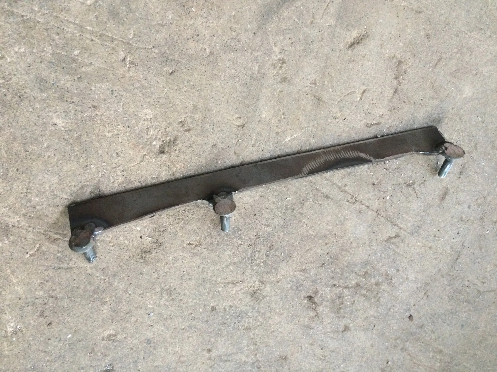

I don't have experience with the whole kit, just a rear bumper cover that was a double sided tape install. I modified it to use mount brackets similar to OEM.
I think the corner cracking is a function of excessive weight on the rear. I am planning to rig up a support that will take some pressure off those corners.
It was tricky and did require stretching things a bit to get it on, I am much more confident that it is securely on.

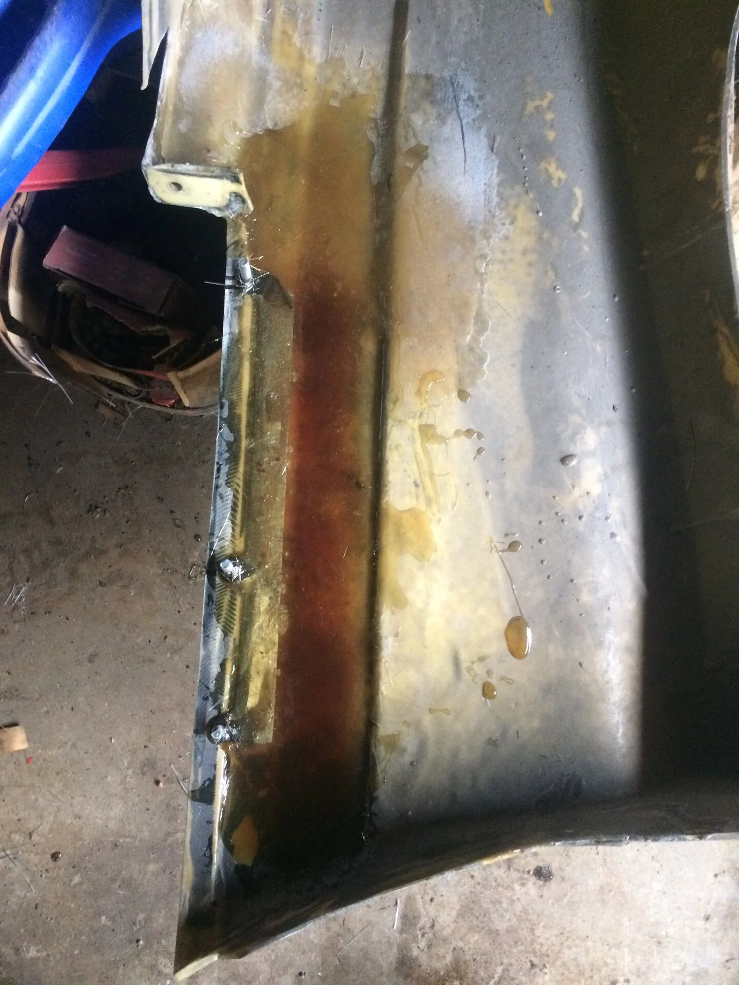

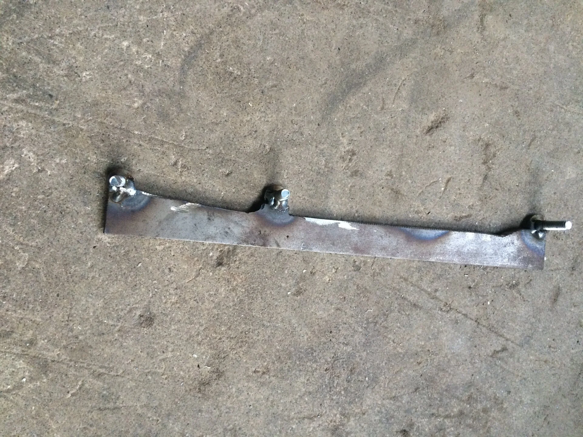

Neat idea. So on GT rear bumper extensions and I’m assuming the factory cobra rear bump have a lip on the underside with a metal bracket like what you made. The cervinis bumper doesn’t look to have that lip and your bracket is sitting on top. What is your method to affixing it to the bumper for mounting to the quarter panel?

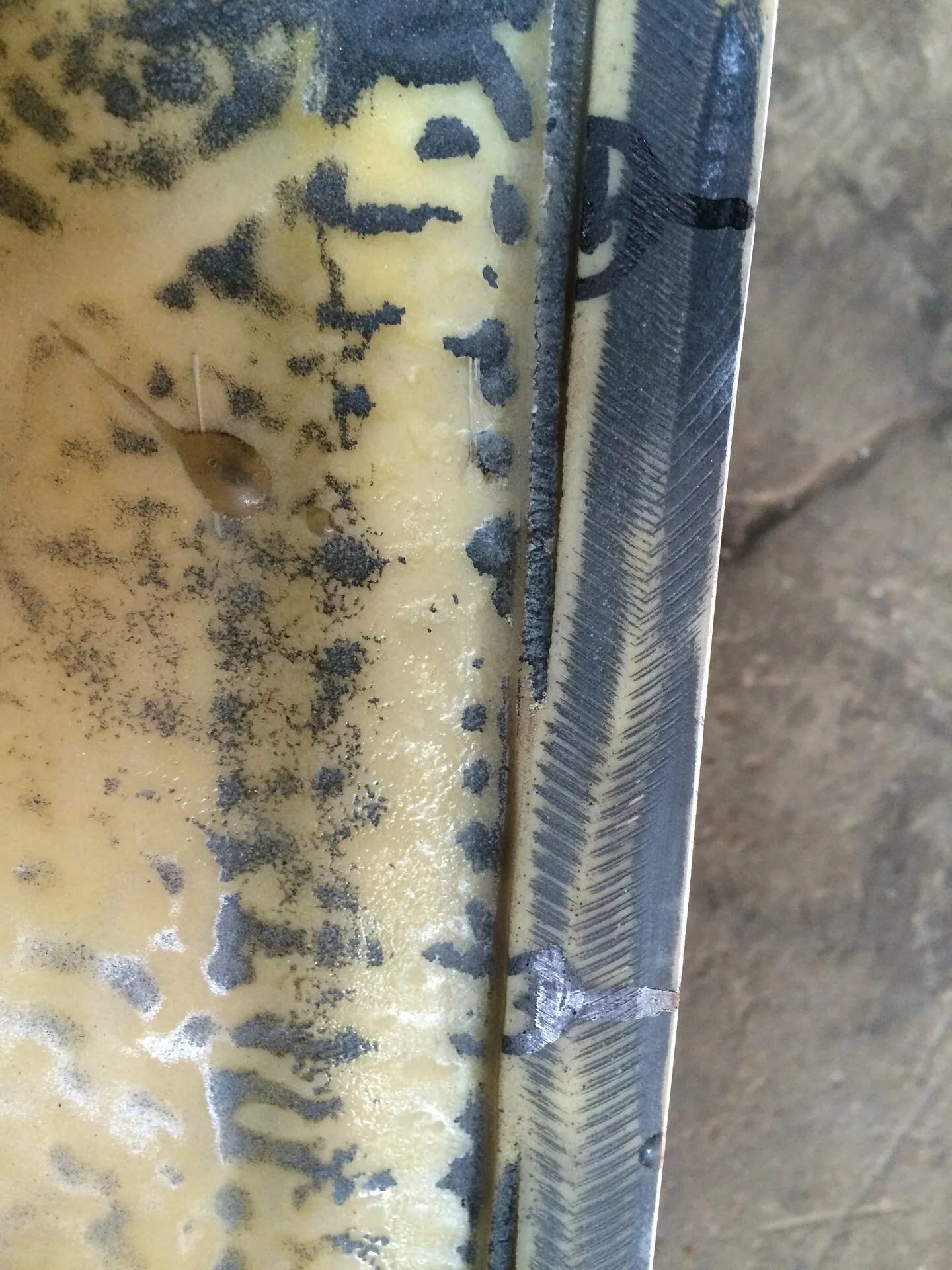

I made a bracket that mimics the factory GT bracket. I then notched the (reproduction) Cobra rear cover to get the studs to fit in the right spot. I then fibreglassed the bracket to the bumper cover. I had to stretch the Cobra cover to get them into the quarter panel holes but then just had to bolt them down to hold in place.
Fibreglassed into place
During final prep before painting, you can see the studs mounted to rear cover.
